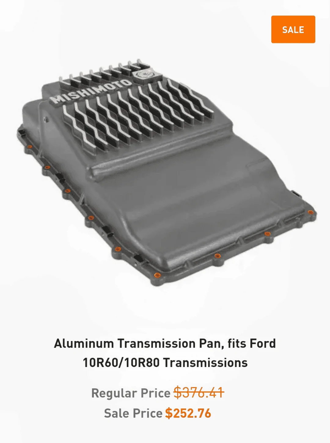

Did you get it installed yet?
Not yet....just got it yesterday....have to get new filter this week to have everything ready to go.
Probably be a week or two before install.

Steve, thank you. Wonder how long that “O” ring will last. Will be interested on install and follow up, especially since we both tow a lot.
6,027
30,087
Yeah, it is a very small diameter O ring. If push comes to shove, don't see why the OE gasket couldn't be re-used on it in place of the O ring. From what I've read the OE gasket can be reused, and if the O ring is removed, the gasket should seat with the new pan.
Have to wait till I remove old pan and see which I feel more comfortable with.

Well, guess I'm the first to get it delivered...came just a few minutes ago.
Real nice, no flaws in the casting. Even supply new stud bolts for those who need them, and a full size layout where they go and torque values.
Got my fluid and will order a new filter.
At just over 19,000 miles, and will do the swap around 20,000 miles.
