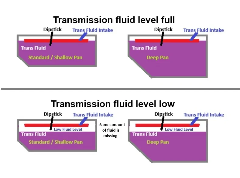

Standard, raw finish...I also prefer standard so I don't have to gamble with the capacity...I put in what comes out and the level will remain the same...
I'm ordering one tomorrow =)
Illustrated Standard vs Deep pan with Full and low fluid levels

I'm the one the confirmed with PPE that the standard pan adds .5-.75 qt extra. I have the email around here somewhere.
They made room for Lubeguard :wink:

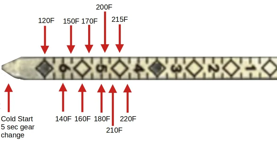

If you have a FitzStick your life is far simpler. His funnel and dipstick work like magic. Easy to measure and get it right too. After installing the FitzStick, I added fluid using the Ford method and then tracked the fluid levels at different temperatures. Each of the measurements below are with the same fluid quantity, just at different temperatures.
The cold start level is exactly that. Start your truck, promptly run it through gears at 5 second intervals, park to sport, then backtrack to park. Immediately check your fluid level. It should just be showing on the tip of the dip stick.
I took the measurement at 75F (fluid temp at 77.4F). Those temps where before the truck was started. Truck was level.
There is a little wiggle room as I filled the transmission to the diamond (the middle of the fluid range) at 215F (the top of the fluid temp range).
Using this method eliminates the need to go to 215F to gain obtain an accurate fluid level.

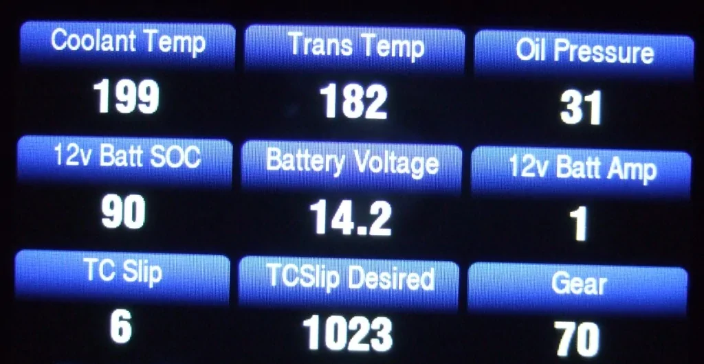

Temperature probe. I use the ScanGauge 3 to read the Ford trans temp sensor. These are the items that I am most concerned about.
Yes, I use OBD Fusion for monitoring...
