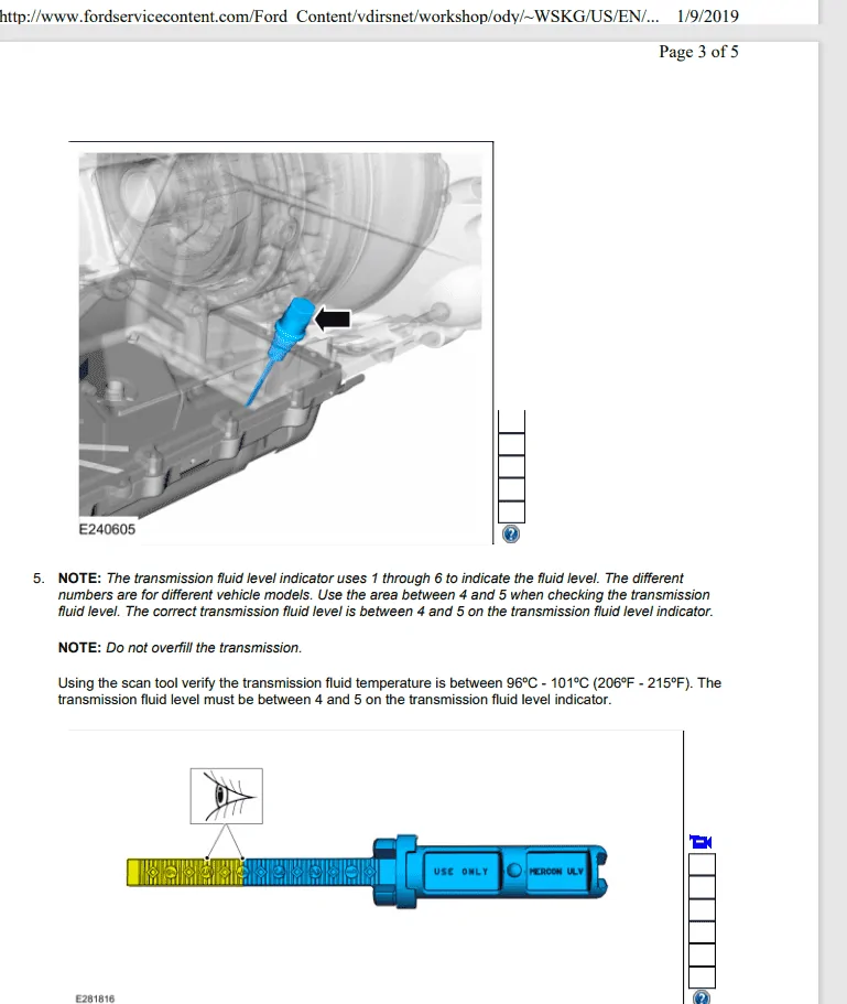

Today it was 117F and man I seemed to catch every red light today on a 15min city drive. Temps hit 220F on the trans. Doesn't the Ranger use the radiator to cool the trans too? Wondered as I figure a rad upgrade would help the trans temps too I presume. These things seem to like to run warm, I tow as well though so cooler is better in my book.
Normal operating temperature for the fluid level check is 206F to 215F so your within 5 degrees of that. I’ve read that the high temperature alert trips at 265F
I believe I heard the same spec for the light to turn on.
