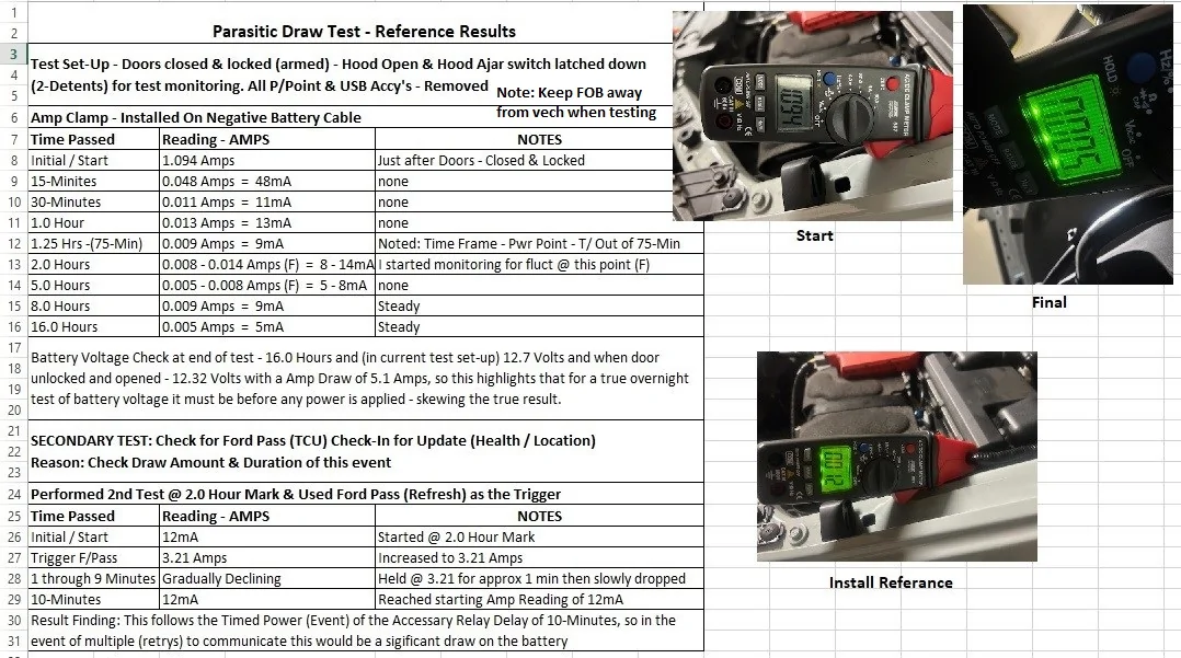

Ok - I updated the Results, including the Ford Pass (TCU) Check

So 3.2 amps for 8-9 minutes. Now the questions:
1) What happens if it the TCU doesn't connect due to low/no signal. Retry intervals?
2) How long do auto updates take?
3) How often does the TCU call home?
4) Can or does Ford initiate connection? If so how often?
That's a good start for now. I suspect you don't know all those answers.

I know that (history) there was a post for (Click/Tone) every 45-Seconds awhile back and I suspected it to be (TCU) Related - No follow up from poster for that one. So IDK what the final fix was.
I know that the (Just be near the truck and the Wastegate Actuator Cycle) is the TCU Checking in.
It tends to do it more if you have the phone in close proximity to the truck, sometimes 2 times in an hour.
If only the (FOB) and phone is in the house - it does not seam to do it.
Its only sporadic - no specific timing or event that triggers it that I know of.
I turned off the Auto-Updates, I prefer to install them myself.
I know as far as Ford Pass and the location update - its immediate as I can drive and shut off the truck and then check Ford Pass, location updates to my current location.
As far as Ford Check Ins - I do not know how often it checks in if its all alone and away from phone & fob.

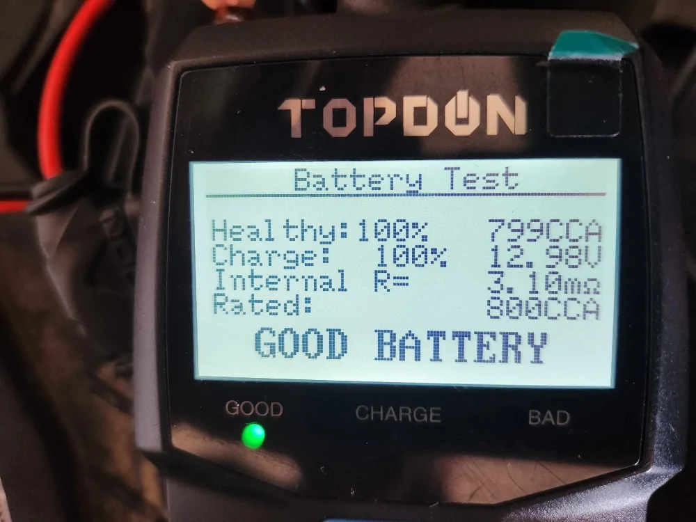

Weird battery behavior.
So I haven't driven the truck for over a week, battery is about 1 year old, so tested battery. Should have taken a picture but didn't, showed charge of 7% and health of 71% IR was 4.23. Hooked up Noco 5 and in about d minutes showed fully charged with green light. Re-tested battery and was 100% healthy and 100% charged. Can that really happen so quickly?

How soon after the charge did you retest the battery? Best to wait 8 hours and retest, or temporarily turn on headlights to burn off the surface charge. Keep the headlight on time the same as well.
If you check it immediately after the charge you'll get a false high reading.
And whatever time delay that you do decide to test after charging the battery, keep the time delay consistent for accurate results.
1st test - Baseline
2nd test - Measures Delta
3rd test - Measure Delta
What is important is that you establish a definable repeatable process. Once you do that you will be able to discern any change with some degree of confidence in the accuracy of your results.

yes the surface charge can be deceptive but also as to your advice for putting a headlight on - might consider doing that before taking the initial test as a brief current draw will likley lower the internal resistance and you'll get a more accurate reading after the battery has sat for a week - the old carbon pile testers were more accurate in that respect as they create a large flow of current.

I agree...
Yep, they are, but they put a lot of load / stress on a battery. And if your battery is marginal, that load test might finish off the battery, esp if you leave it loaded for too long.
I own one (or two), but I am careful about when to use it.
