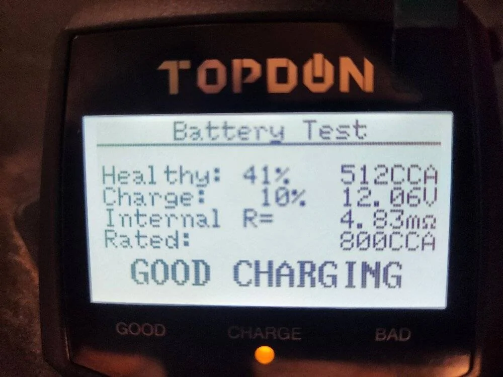

Nice to hear your method is working. It has been a month since I last charged and desulfated and I really don't drive much. Tested and the results are stunningly scary considering status a month ago. Just charged and now desulfating. :whew:
Are you aware that desulfation is not always 100% reversal as your battery ages ? if you keep letting it discharge you will do more damage than desulfation can completely repair. Just my .02

Appreciate the input. Will do better. :crazy:

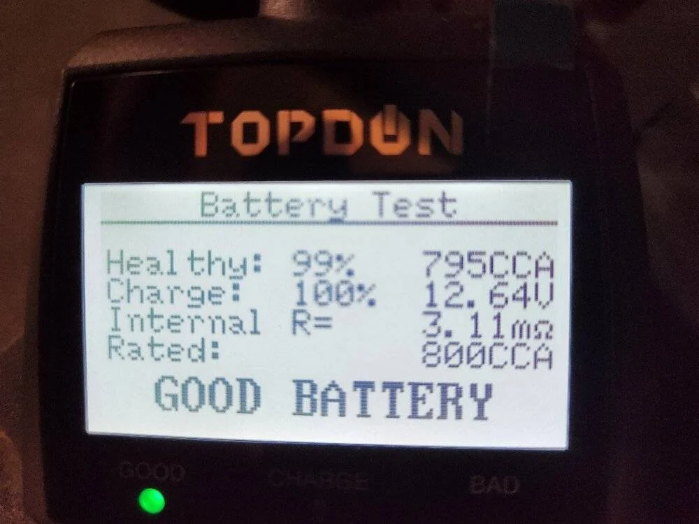

Got lucky since the desulfate did a fine job.

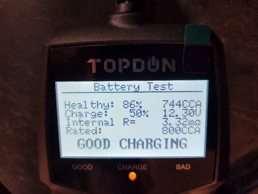

So you got my attention. I only have one tester but I have not so much as opened a door on the truck since I charged and desulfated yesterday. It was 96 degrees yesterday and 60 overnight.
The battery lost 1/2 its charge in 19 hours! :frown: Probably not long before this thing is toast.

The readings you have are normal - due to the truck having some modules powered (24x7)
for (KAM) - Keep Alive Memory
I call your AM Reading - Wake-Up Voltage and is consistent with my plug-in voltmeter readings at every (1st start of the day) or even a few hours after shut-down.
The trigger voltage reading (actual battery voltage) for Deep Sleep, ASS Not Working etc is around 11.3 to 11.5 volts (Measured Wake-Up Voltage) this is the voltage the BMS sensor sees and reports to the BCM and triggers the various messages.
Your IR looks GREAT, that's the most important reading of the battery heath, how well it can accept the charge.
The voltage drop (overnight) is normal for the Ranger, the Ranger 2.3 critical battery voltage for starting (starter engagement) is about 10.6 volts.
One thing I have noted, other than the occasional (No-Start then Magically Starts) issue which is tied to the (Wake-Up) circuit - PCM Power Relay not being commanded to close from the BCM.
I have yet to see a wide abundance of posts of completely dead battery and no start issues.
So at least the BMS system does have a Positive Side to it, for that as I do not see a long thread of dead battery issues yes, we have the annoying messages and things not functioning the way they should, but you have to agree there is not allot of posts of hey my battery died.

Appreciate the insight on the numbers. This battery maintenance stuff is new to me.
