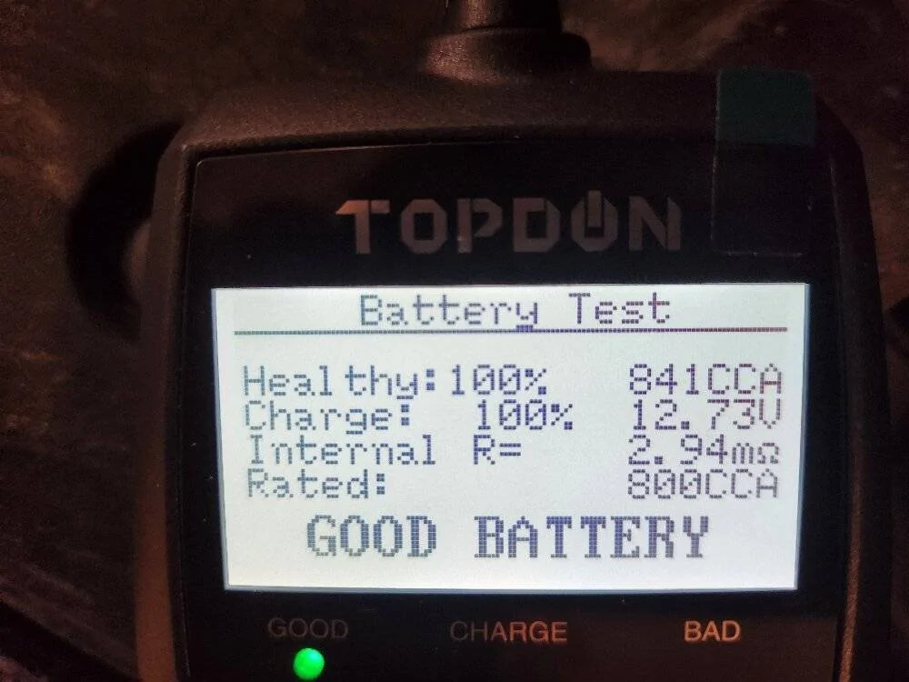

Tony @TJC and @airline tech have taught me a bunch about battery maintenance. This is my first AGM battery and first vehicle with a BMS. You have opened my eyes to keeping a healthy battery and the tools needed to do so. I never heard about a desulfator before.
Original battery is going strong even though I have not changed or disconnected the BMS. This was a couple days ago and finally have upped the CCA's above the rated 800.
It feels really good to see those numbers, doesn't it! The BM Desulators work, they just take time to do their thing.

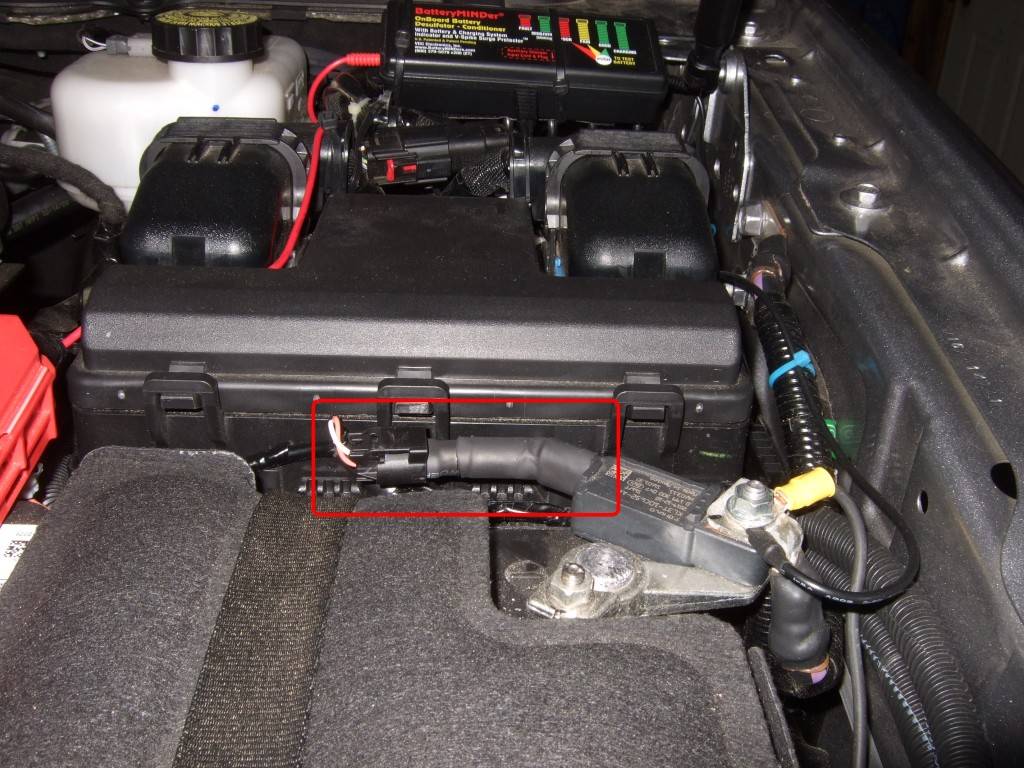

I've completed my analysis on BMS with SOC @ 95% vs disconnected BMS Sensor.
I have disconnected the BMS sensor, and it will stay that way for the duration of my ownership.
I prefer the old Ford charging standard vs the latest BMS incantation.
A week ago I disconnected the BMS sensor and used heat shrink and a 1/4" outside diameter PVC plastic pipe to insure the connectors on both end remain corrosion and water free. I used 2 different diameter heat shrink tubing to seal the connector and the plug. The 1/4" diameter 1/2" long PVC pipe (insulator) was used to bridge the gap. Took 2 different sizes of heat shrink to get the job done, but every thing is now water proof sealed, and easy to reverse if it becomes necessary.
Here's a picture of the desulfator and the heat shrink bridge.
I just got back from a grocery run, about 10 miles each way. Voltage started at 13.9v and dropped to 13.7v by the time I reached the store. On the way home the voltage started at 13.8v and dropped to 13.5v, then rose to 13.7v the rest of the way home. It was dark so headlights and AC were on both ways - 83F and 90% humidity. Remember that this voltage reads 0.2v low in the cab.
I've picked my poison. We'll see how this works out long term.

Does anyone know if turning off ASS/BMS in Forscan is the same as unplugging the BMS connector?
I do not believe that they are the same. I do think that they are similar. I have tried both, and still have ASS turned off in ForScan with SOC set to 95, but I just made the decision to unplug the BMS Sensor last week....which negates those settings, as I believe (based upon my testing) that Ford falls back to the older charging technology when the BMS sensor fails to report.
I saw different charging patterns with the BMS sensor connected with ASS turned off than I had with the sensor unplugged. The BMS seemed more dynamic with the sensor plugged in. With the sensor unplugged I saw definable repeatable charging readings very similar to what I see with my 2005 Ranger.
I have very good luck with keeping batteries healthy for long periods of time with my 2005 Ranger, so I am going with what I understand and have a proven track record with.
There is too much smoke and mirrors going on with the present Ford BMS for me to keep it functional. I honestly believe that the present BMS implementation sacrifices battery life for a yet to be proven perceived gain in fuel economy.
Time will tell if I have made the right decision. I may very well be wrong.

Nice to hear your method is working. It has been a month since I last charged and desulfated and I really don't drive much. Tested and the results are stunningly scary considering status a month ago. Just charged and now desulfating. :whew:
