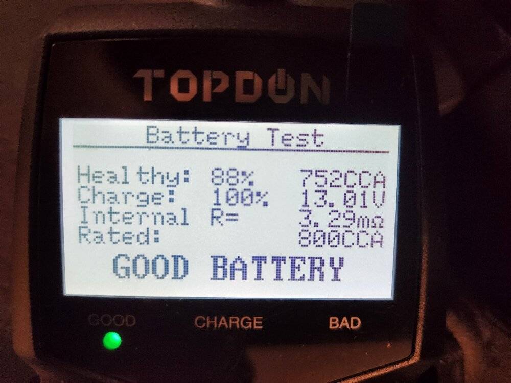

Truck hasn't been driven much lately so put the Noco 5 on it (original OEM battery) to run repair mode. Results are the battery is getting better.

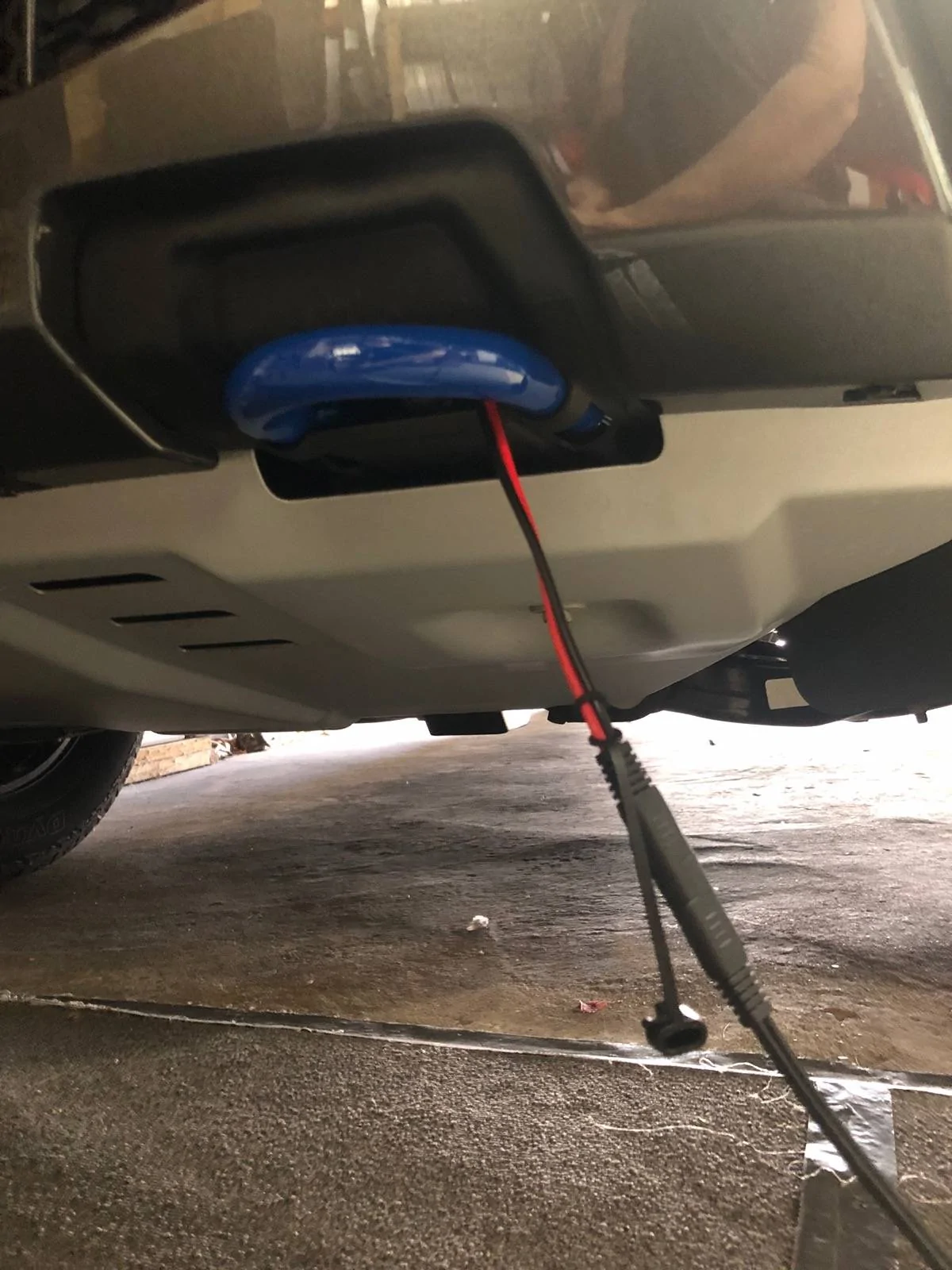

I just finished installing the new NOCO Genius 2D onboard charger...we'll see how it goes...wish it had a Bluetooth app and connection so I can monitor it while in the house...
How is it set up to connect AC? Is there a plug in the bumper?
I have mine coming out of the tow hook boot and tuck it right back in when not in use. Works perfect! Thanks to AzScorpian for the idea.
I don't have that rubber boot anymore after converting to shackles...
