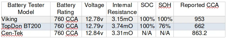

With the activities of the holidays slowing, I was able to test my battery today using 3 different battery testers. Temps was 41F at the time of the test, and the battery remained electrically connected to the truck.
Here are the results:
I believe the readings would be more accurate with the battery isolated from the truck. As simply moving from one negative stud to the other reduced internal resistance enough to affect the readings. I am referring to the 2 studs at the negative terminal. All of the readings above were taken using the neg stud directly above the battery neg terminal.
Resistance had the largest variance, and it directly affected the CCA and SOH readings. I have a Settings Saver Kit that allows me to pull the neg terminal without losing the current settings. I may run the test again with the battery isolated to see if anything changes.

So, for the comparison factor between the Viking & Topdon pretty much matches my difference in variance readings and confirms that my Topdon is reading accurately for its calibration design.
It just boils down to how they are designed to measure.

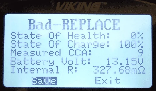

I just finished replacing four battery backup batteries. Each backup takes two 12v 9AH batteries wired in series for 24v system.
These are AGM lead/acid batteries. Resistance from the factory is spec'ed at 18 milliOhms. I almost sent them back until I found the manufacturers spec sheet that validated what I was seeing on the new batteries. I initially tested both the old and new batteries with the Topdon BT200. Readings were accurate (at least what I expected to see) on the new batteries, but I got downright crazy readings on the old batteries! CCA actual readings in the 6300 range! Resistance came back crazy low too! As in 0!
The BT200 does not have a setting for AH so I used 100CCA (the lowest CCA setting) even though the battery should more accurate be set to around 65-75AH.
I then broke out the Viking tester and ran the same tests using CCA at 100 ( I also tested using AH as the Viking offers it and had identical results). The new batteries tested very similar to the BT200, but the old batteries tested completely differently. Voltages tested the same on both testers, but most everything else was different. The Viking measured resistance much higher... as would be expected for sulfated batteries. It also failed each of the old batteries. The BT200 passed all the old batteries as good with extremely high levels of SOC and SOH.
I'll post actual screen readings of both when my camera finishes charging. But this much I know for sure. The BT200 does nto do well with smaller AGM batteries. The Viking handled them as expected. BTW, resistance was up to 632 milliOhms on the batteries that came right out the the backup units. I broke out my Batterminder chargers and started to try to bring them back. After 2 days the resistance level had drop by 50%. We'll see if I can get them back to under 20 milliOhms in a week or two.
Actual screen captures coming soon.

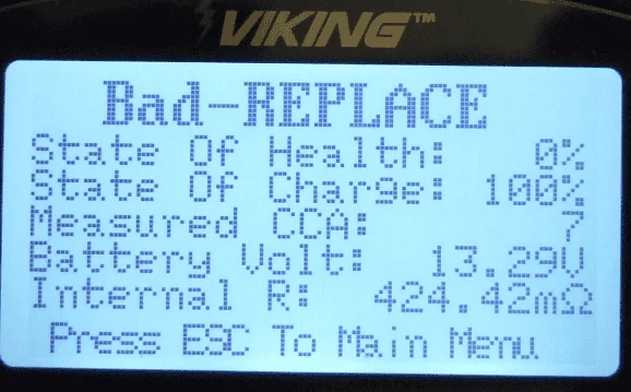

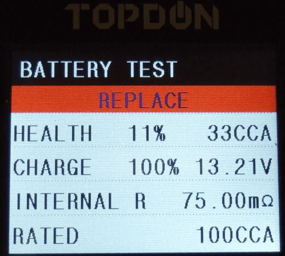

Here are the results of testing on two 12v /9AH AGM Batteries. The first is a battery that was pulled after 4 years of use in the Battery Backup Unit (BBU). No attempt at charging or desulfating. The Topdon test went first in both readings. Then the Viking followed. Clearly the Topdon results are out of the ballpark off. Both batteries removed from the BBU are heavily sulfated and the battery backup would fail to run on battery power.
Viking Test Results________________Topdon BT200 Yest Results

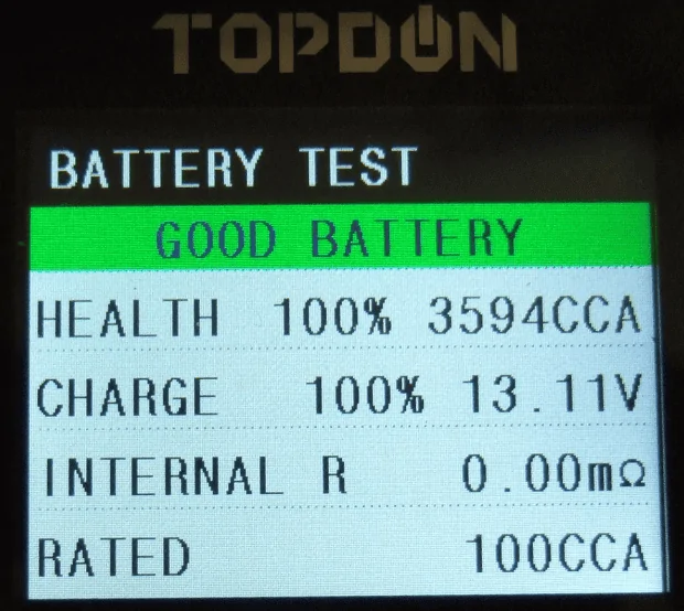

After conditioning the replacement batteries, I attempted to recharge and desulfate the spent batteries. These results are after 12 hours on the charger / desulfator.
Whatever algos are used by the Topdon are starting to work but are still way off the target. The Viking is reported more accurately. Note resistance is dropping from 424 to 327. 18-20 is the optimal for these batteries.
I think maybe Topdon's algos don't handle high resistance well.
Viking Test Results_________________Topdon BT200 Yest Results

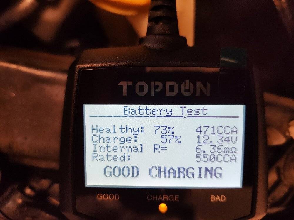

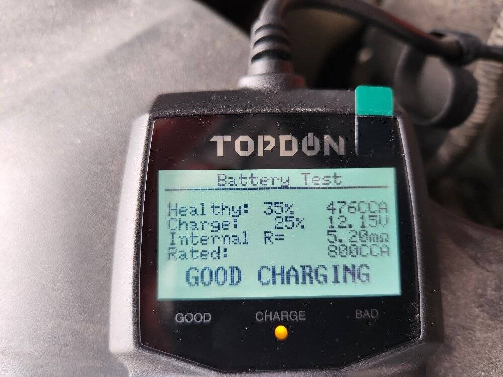

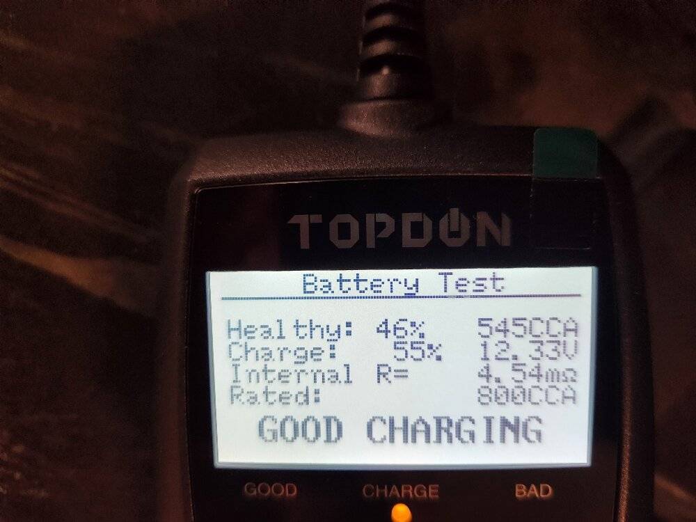

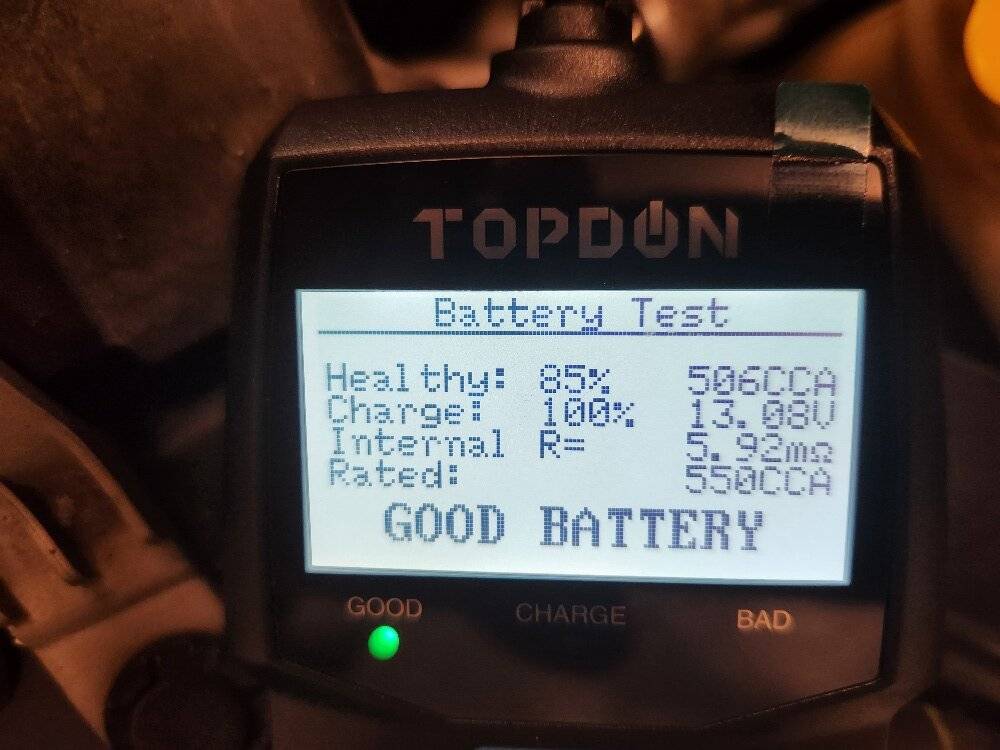

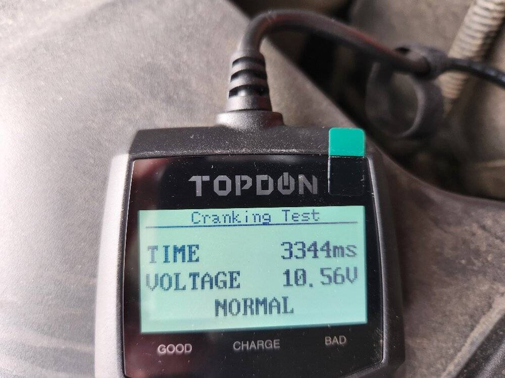

Wife tried to remote start her Edge the other day, and couldn't because it said 'battery not charged' or something like that. So after it rested a couple of hours I took the Solar tester to it. The IR was a littel over 5mohm, SOC 63%. Now it is really difficult to get a good purchase on the negative terminal because it is tucked so far back toward the dash.
Then I took the tester to the Ranger. I got very similar results, though IR was slightly lower, upper 4 to low 5. (2 tests).
Ranger 2021 45k miles, stock battery
Edge 2019 30k miles, bought used not sure if battery ever replaced
Outside temp around 20 degrees.
I have not observed regen charging in the Ranger for months. The ASS still works occasionally, but a lot of times it doesn't because of Vehicle Charging.
