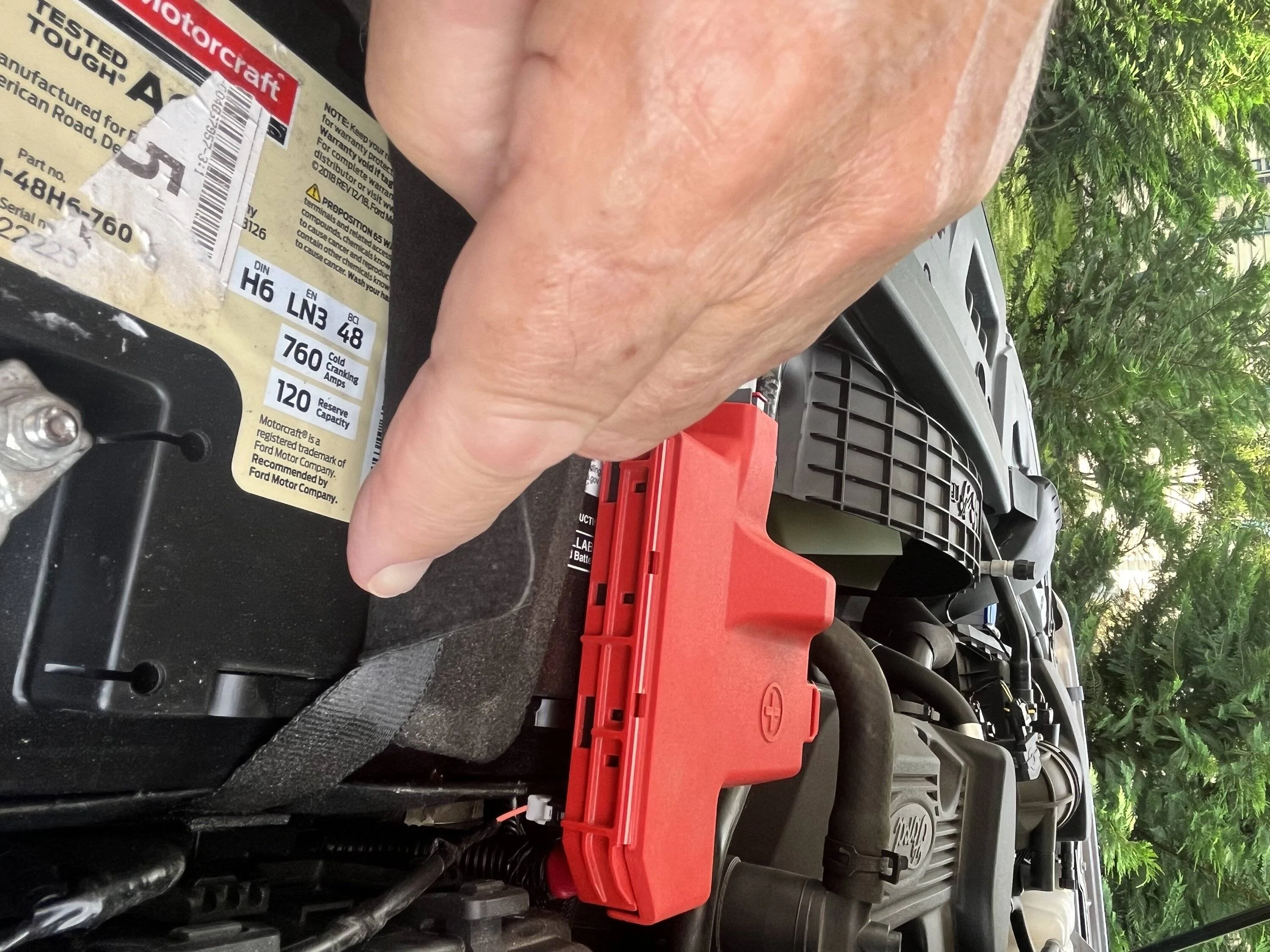

Here are the two in my manual. BAGM-48H6-760 BAGM-94RH7-800

The service manuals call for a 720 CCA H-6 in the XL / XLT and 800 CCA H-7 for the Lariat
It appears that the online parts show the XL / XLT getting bumped up to 760 CCA
If buying out of pocket and warranty not limiting you - just get the 800 CCA

My 2020 XLT has a 760 CCA battery in it.

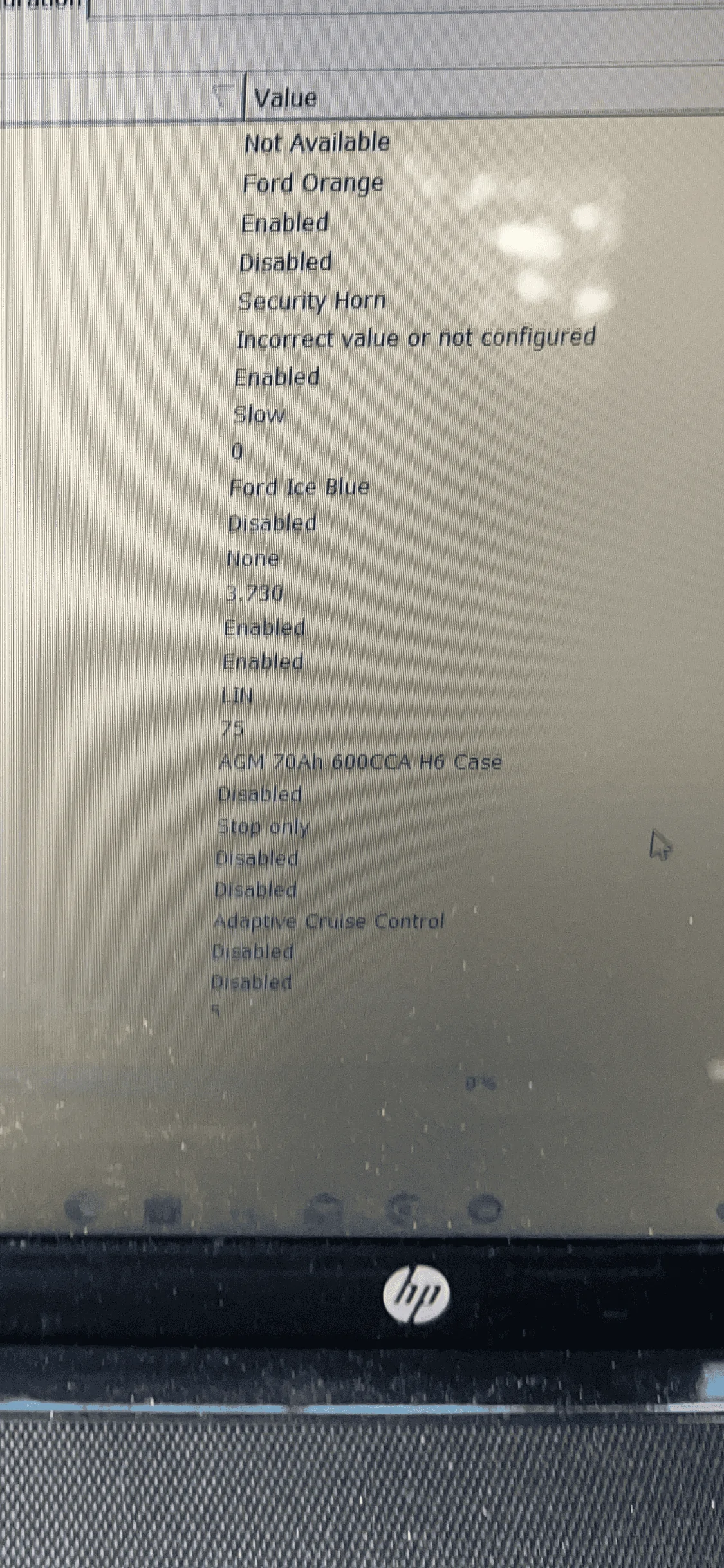

The Forscan - entry is a generic entry- it is not a exact battery size reading. I can’t remember what options Forscan has, so you select the closest to to battery that is installed.
I should point out - if you change the. Battery size with Forscan - it will generate a new date of install on the battery.
