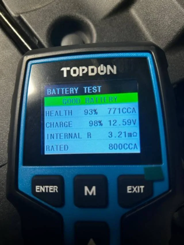

Just a quick test this AM on Battery
Health - 93% - 771 CCA
Charge - 98% -12.59 Volts
Internal R - 3.21 M/Ohms
Rated - 800 CCA
So, compared to last test in January, I am about the same.
Took delivery of truck 7 months ago, so battery is still new and 5,000 miles.

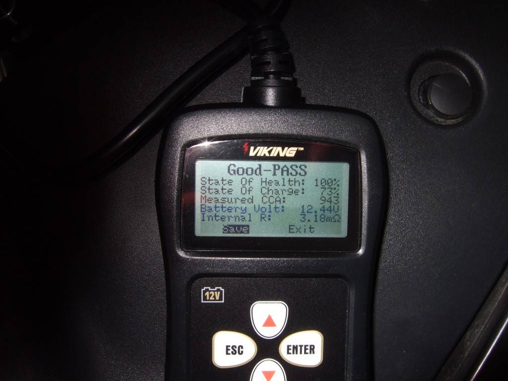

Here are my present Battery results from today
2005 Ranger
2020 Ranger Battery Report

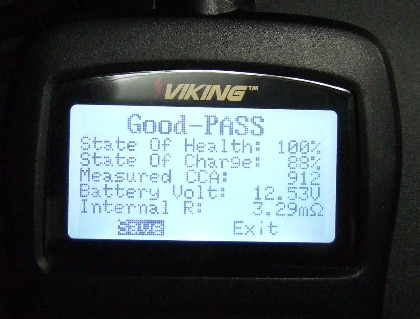

Interesting how the numbers change 12 hours later. I also raised the hood the night before and left it up to keep me from energizing the AMP Powersteps and cabin features on the next reading, which are going to cause an immediate load on the battery ad very well may change the results.
So...
SOC rose from 73% to 88%
CCA dropped from 943 to 912 (still very very good!)
Voltage rose from 12.44V to 12.53V
Internal Resistance rose from 3.18 mOhm to 3.28 mOhm
Remember, the initial reading required me to open the door to open the hood, and this activated the steps and powered up all the cabin "features", and maybe the fuel pump. It makes a difference.
