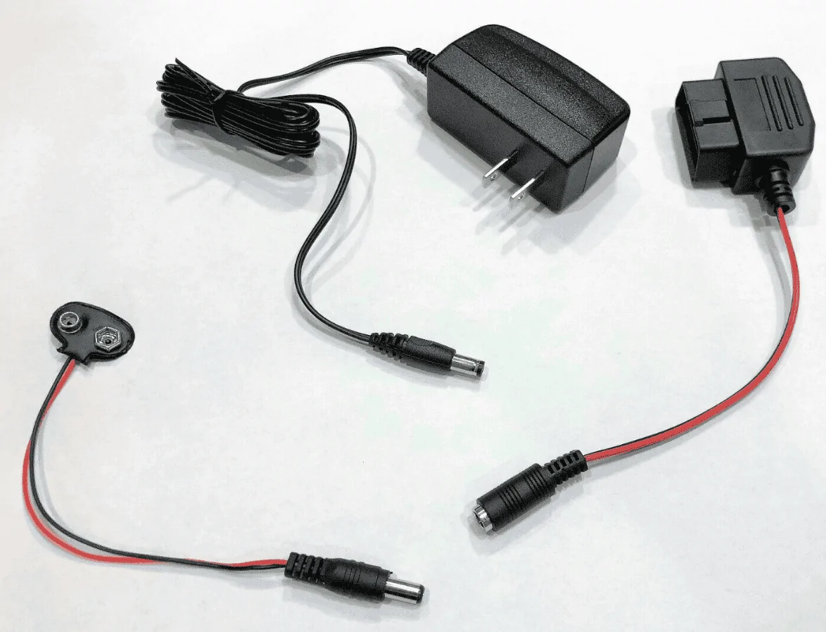

No, I have an 8amp Batteryminder charger. I purchased a $15 Car memory saver that plugs into the diagnostic port. It came with a 12V wall wart that supply power to it. Plug it in, then remove the battery.
I have not tried it yet.
Just found one on ebay, and they have gone up in price!
OBD Style Memory Saver AC/9v for Vehicle Battery Replacement/Disconnect

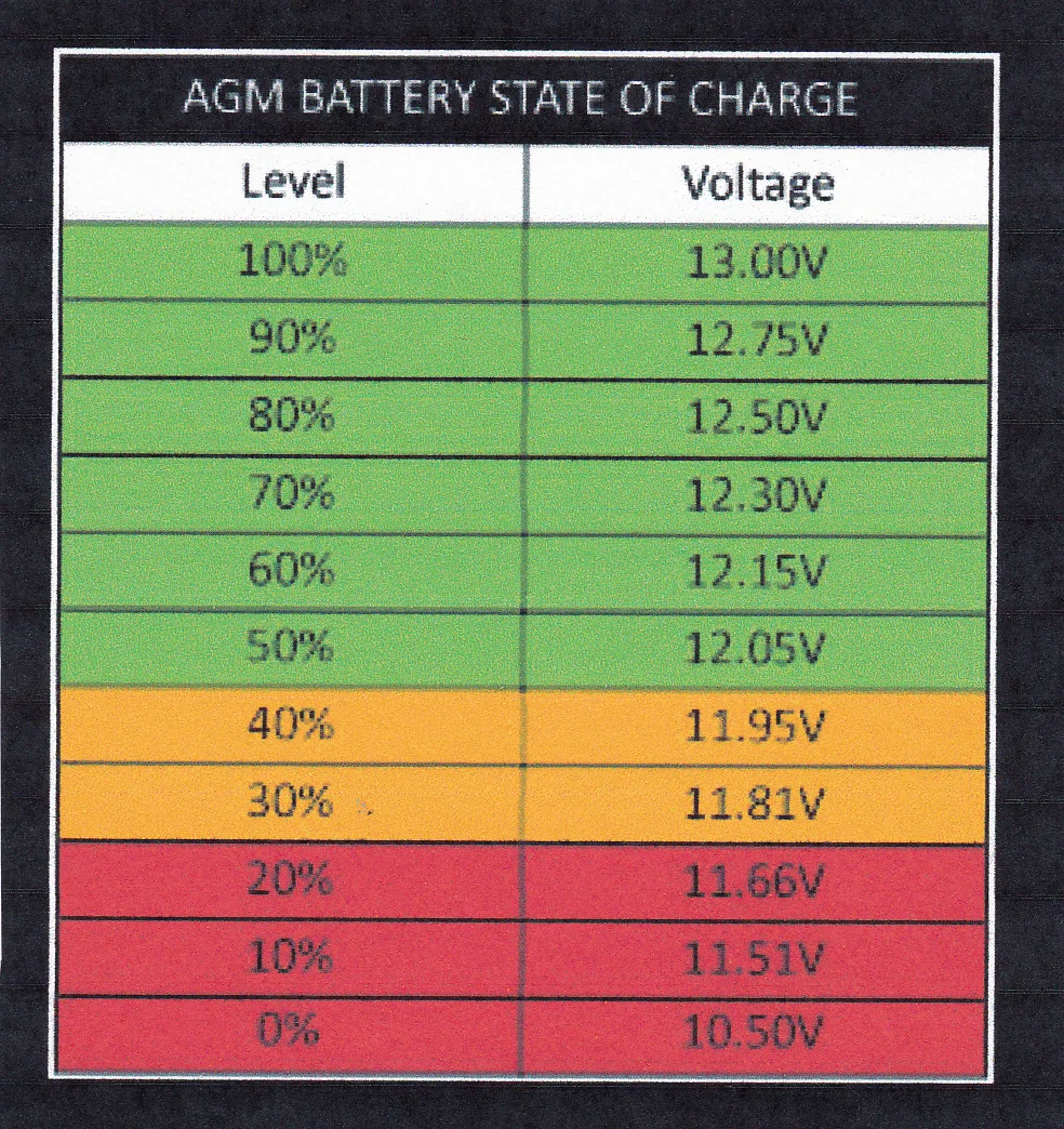

My internet search consistently comes up with very different values.

I think I came up with
12.76 XL/XLT 720 CCA
12.85 Lariat 800 CCA
At 100 percent
yes there are quite a number of charts
So I used Fords chart on one of the TSB’s
I like that one as it tells me that my 4 yr batt SOC is 80%, this after my battery suffering for 2.5 yrs with a connected and undercharging BMS . I now feel I owe it to him to maintain his health as he ages.
