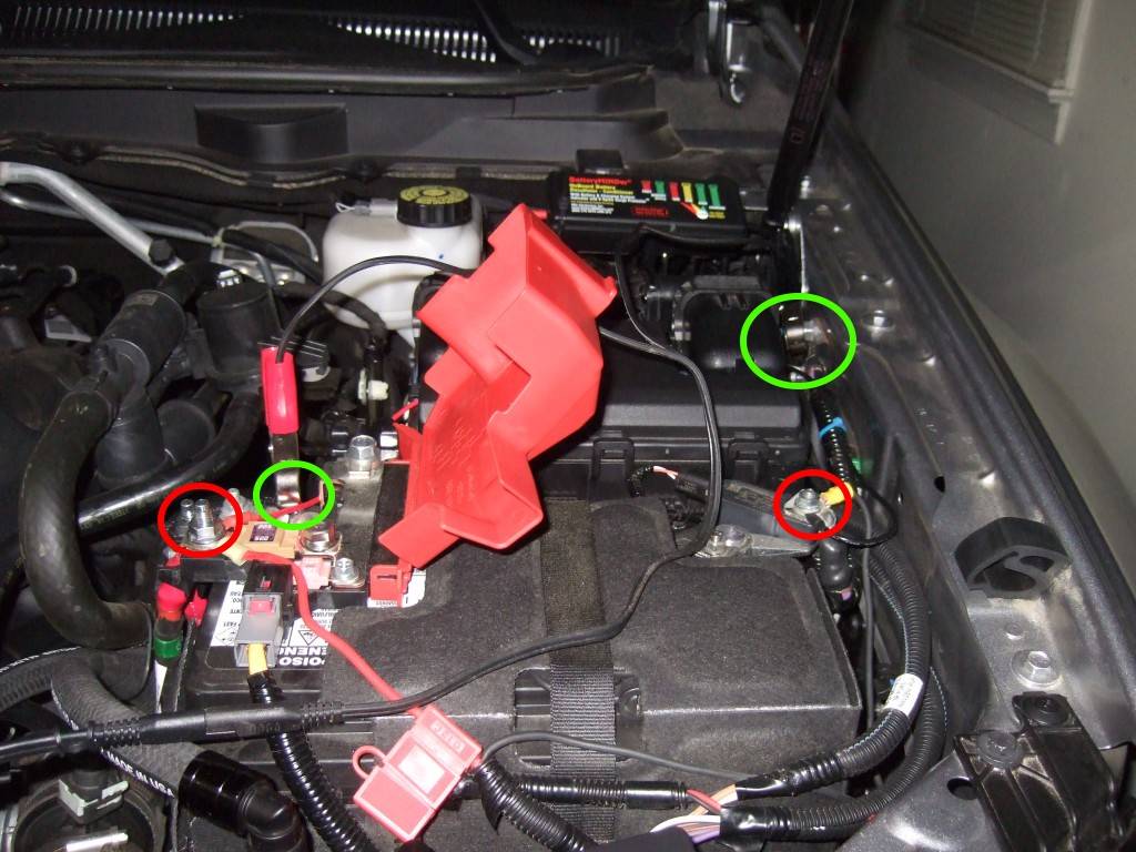

Where did you connect to? I connected to the points in red circles in the image below. I did not loosen the battery post connections. Since disconnecting the BMS sensor, I charge via the pigtail on the onboard desulfator, not the points circled in green. Click on image to enlarge.
If you secured your desulfator where I did, be sure to tie down the ground lead to avoid the hood hinge damaging the wire. Note the blue zip ties just above the battery negative attachment point.

Looks like the same on the positive side, but I wanted to be connected directly to the negative post so I connected it below the nut that keeps it tight to the post. I couldn't decide where to put the unit, so for now I just zip tied it to the strap directly on top of the battery.
Just to clear up a few things about the picture.
On the negative side both circles are basically the same other than a length of wire. Both on the body ground side of the BMS sensor.
On the positive side. The green circle is showing the charger clamp on the batteries positive post. The red circle is showing the wire connect to the non-battery side of the large fuse shown. Not sure if it makes a lot of difference, just a point of clarification. If you want a direct connection to the positive post the large screw to the right of the clamp is a good place.
Just be sure to disconnect the negative battery post when making any of these connections. To avoid making any sparks which could fry some of the electronics in your truck.
Re: Negative Connection
I agree with you.
I am assuming the BMS sensor measures current using a Hall Effect Sensor. If that is the case, the negative cable simply passes through the Hall Effect sensor, but never physically makes electrical contact with anything inside the BMS Sensor. ( I use this method to dynamically measure and balance loads on both 120v electrical busses in my home when running off my Honda EU7000 generator. )
Unplugging the BMS Sensor simply disables that capability ( I don't know if the BMS sensor monitors voltages and temps, but I suspect it does as well.
Electrically speaking, the closer to the battery post, the lower the resistance (however slight).
