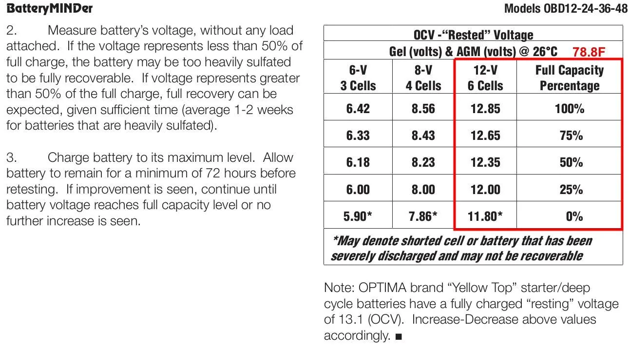

When I connected directly to the battery posts bypassing the BMS sensor, charging voltage went to 13.5V. This test check was done after the battery had been on the charger for a while and the battery had reached the 70%-75% threshold. This leads me to believe that the BMS is active even when the truck is turned off.

Yes, BMS will not know the condition of the battery SOC, but if the truck is left off 8-12 hours it will recalibrate the battery settings. This was covered by Airline Tech in his research.
The problem is that I do not believe it cares so much about the battery condition except to keep the battery only partially charged. And as resistance climbs due to sulfation from the poor charge rate, BMS will raise the charge voltage to compensate. This will put more stress on your alternator and your mpg will drop, not a lot, but it will drop.
My alternator requires less current to charge the battery as the battery's internal resistance is 1/3 of what it was before I began the desulfation process.
When I attempted to charge through the BMS the voltage that I measured at the battery was much less than what the charger was trying to put into the battery. The BMS appeared to only allow a charge equivalent to the target SOC of 70%-75% or about 12.5v total. A fully charged battery in good health should be at 12.85V after resting for 12 hours. See the Batteryminder chart a couple of entries up. Bypassing the BMS system allowed me to fully charge the battery.
This is why I will keep BMS turned off. It is trading a very slight mpg gain initially for battery life. This is my personal conclusion. Ford has had 100 years to optimize battery charge technology. They had it pretty well understood. The technology was very mature. IMO, they took a giant step backwards in search of better EPA numbers. It was a tradeoff that was not to the owners advantage.
If you wish to try an experiment, install the desulfator leaving BMS active, track your battery's health, and report back when you need to replace it. I will leave the BMS sensor disconnected and will do the same. If either of us sees an anomaly. poor battery condition, low voltage indicator, etc., simply report back to this thread. The worst that can happen is you end up replacing your battery early.
As for me, I am confident that I have found the solution to my problem. And by the end of this adventure we will both know.
The problem is that I do not believe it cares so much about the battery condition except to keep the battery only partially charged. And as resistance climbs due to sulfation from the poor charge rate, BMS will raise the charge voltage to compensate. This will put moire stress on your alternator and your mpg will drop, not a lot, but it will drop.
