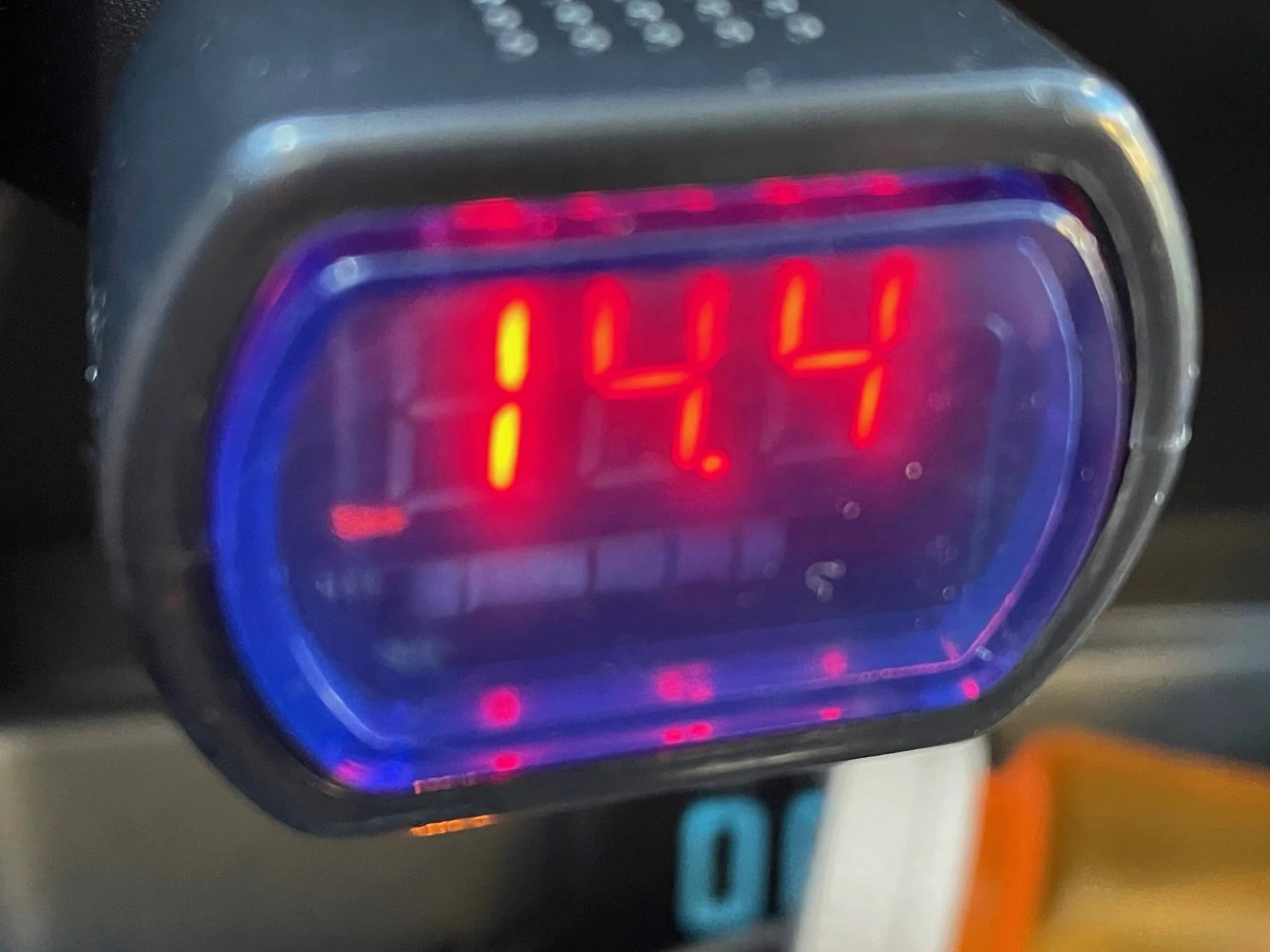

According to my plug-in meter in the 12v outlet in the cab I hardly even see less than 13V and is most often 14-14.8V. I'll check it at the battery when I install the desulfator, but I don't want to disconnect the BMS. Sounds like your truck is just plain running differently.
That's right about where mine is all the time too. Since getting the new battery 2+ years ago I've always had it on the maintainer 3-4 days a week and so far it seems to have helped.
I have a feeling that if I had tested the battery before the desulfation process, my battery charge voltages would have been inline with what everyone else are reporting - much higher due to double/triple internal resistance in the battery. As battery resistance drops so does the necessary charge voltage. I think that is part of the aging battery algorithm used in the BMS.
With the BMS active, I saw high 14.5v readings when off throttle, but low to mid 12v when I added any throttle. This on an optimally charged and desulfated battery (a 2 week process with desulfator running 24/7). Desulfator only triggers at or above the 13.5V threshold, which in effect means only on off throttle conditions - probably about 20%-30% of the time if BMS is active. !00% of the time when BMS is turned off.
Make an informed decision. Test it for yourself. Unplugging the BMS sensor for a test or two will not affect anything. I am lucky in that I had my old 4G Ranger still around for comparison purposes. It still has conventional charging not affected by EPA/CAFE initiatives.
The battery in the 4G is very healthy. And I see higher initial voltages in the 4G than in the 5G with BMS sensor unplugged, but after 10-15 miles the charge levels of both trucks are within 0.1v of each other. So I have no fear of cooking the 5G battery. Steady state charge rates are identical in both the 4G and the (BMSless) 5G. Initial charging rates are .4v higher in the 4G.
