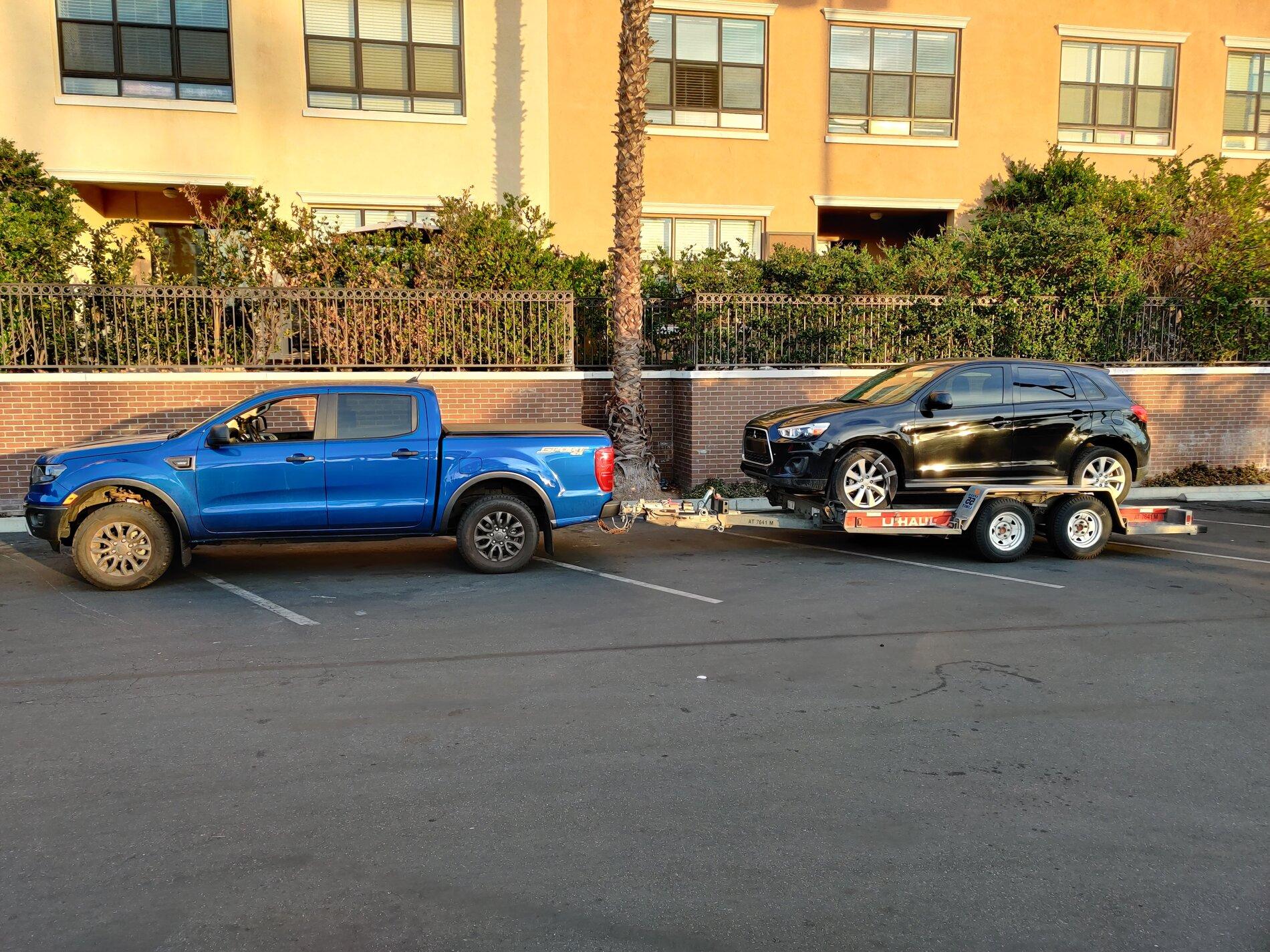

Something I have noticed a while back is when towing a vehicle with a tow dolly usually isn't too bad. I remember when I towed my 280ZX with my Frontier and fuel mileage was still fairly close to normal. Not something I'll understand but it is what it is.
Mostly freeway & Ohio Turnpike while towing @ 62 MPH. Not towing on return home took 2 lane highways and Rt 90 @ 55 to 70 MPH. Computer says 22.2 MPG after driving 27k miles the last year and a half. I'm happy with that.
I definitely saw a hit when I pulled, but I also had quite a few hills to tackle.. Went down from a typical 24mpg on the highway to ~16mpg with a car trailer totalling about 6k. Granted a full trailer and not a dolly.
