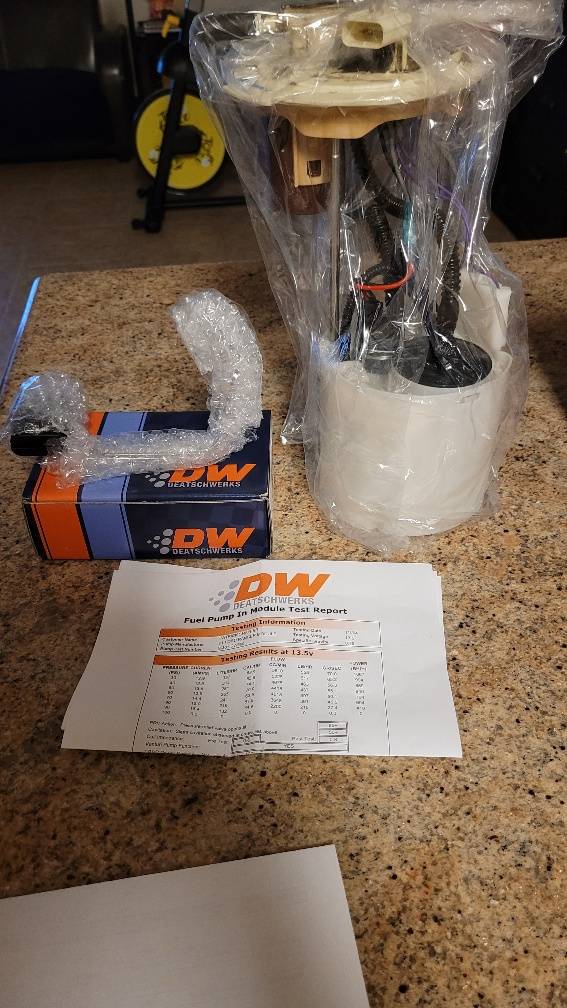

Update got my fuel pump back from DW fuel systems with a new 340lph fuel pump upgrade.
while they had my oem pump I had it flow tested in the stock module @265 lph

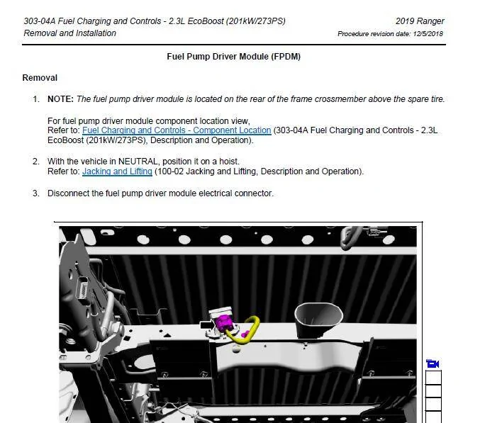

The in tank fuel pump is driven by the 'Fuel Pump Driver Module' which is likely a variable voltage output in order to control the speed of the pump. (OR a Pulse-width control) One thing it is not, is a simple relay off of the battery box or a simple on/off switch. Charging system voltage probably doesn't matter one bit.
It is also possible that the circuit receives its power from the on board voltage stabilizing module, in which case, again, charging system voltage won't matter.
That is can be controlled via programming is absolutely no surprise (well, at least to most people)
Location of the FPDM:
