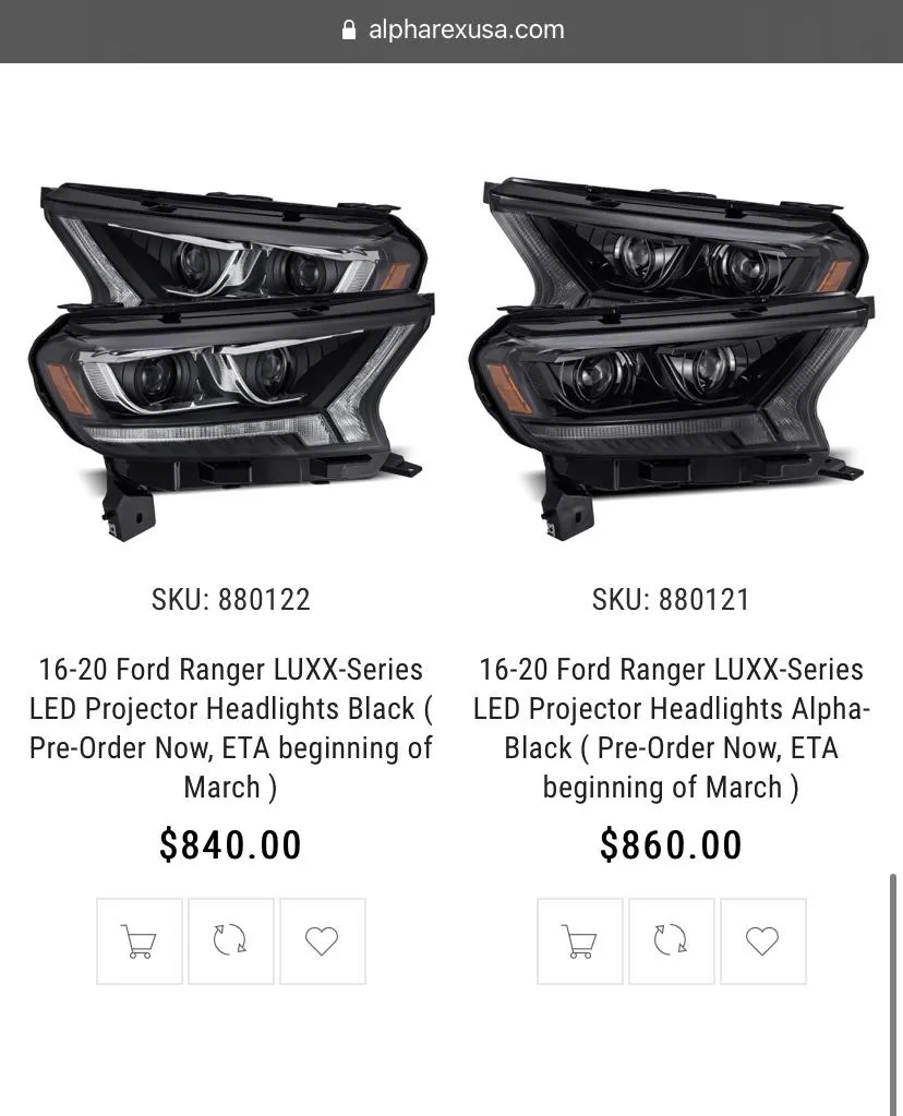

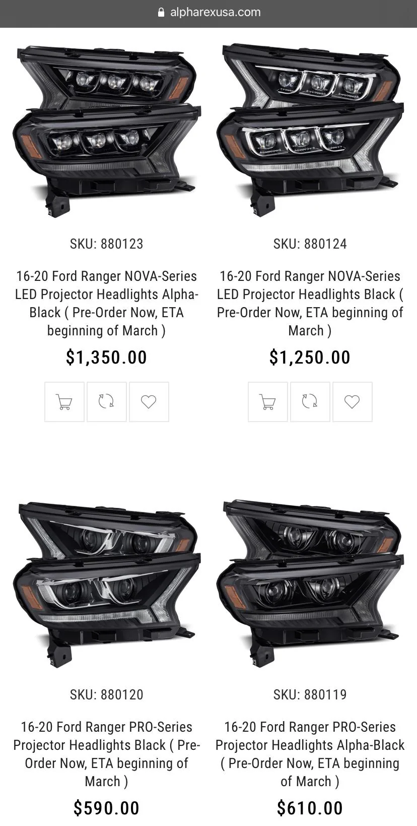

I just saw Alpharex are now available for pre-order. Looks like the lowest priced ones are halogen but the rest are LED.
I would be careful about them fitting our US Rangers. They say 16-20 Ford Ranger. May be for ROW Rangers. Lot of threads about trying to fit ROW Ranger headlights in our trucks.
[EDIT] Checked web site, they do specify US trucks only. Look like they need to proofread their info better.
No, these are *specifically* designed for the NA Ranger. Alpharex has been working on these for months and just shared them a few weeks ago.
It's nice to see them finally. I'll almost certainly be adding them soon.
