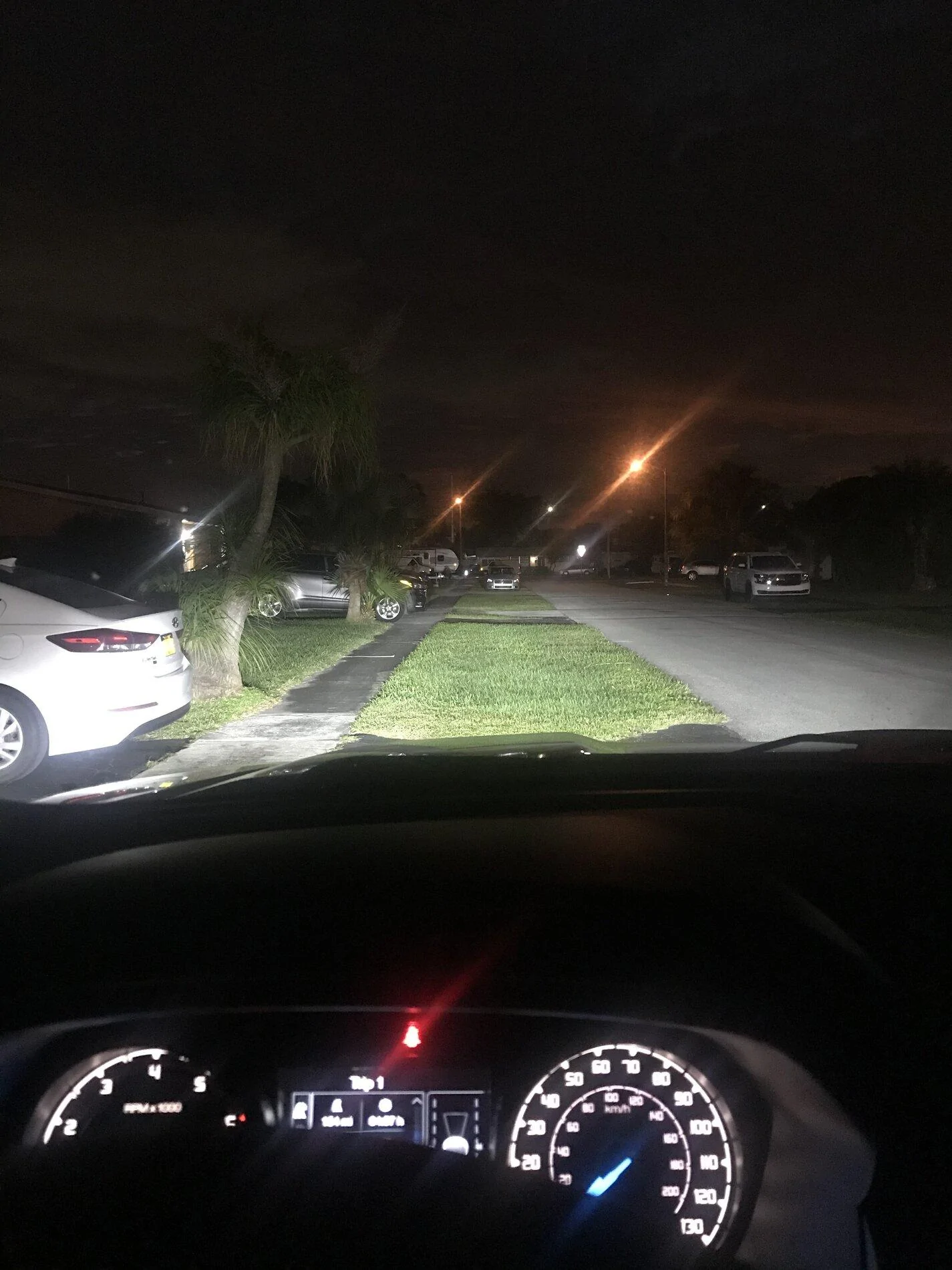

Anyone having COMPLETELY different patterns from the passanger headlight compared to the driver headlight? I put some Auxito 12,000 LM 1:1s in. Driver side low beams looks awesome... Passanger side low beams are throwing light to the heavens. Switched the bulb and it is the housing, not the bulbs causing this.
I see level (9 o'clock / 3 o'clock) on drivers side and 10 o'clock / 2 o'clock on the passenger side in my 2005 Ranger. In this 2005 Ford, it is the lens, not the bulb.
I moved the passenger side lens up to compensate and the high beam now lights up the trees! I am going to readjust the passenger side back to its original location. I am not happy with that Ford design decision.
I have not changed the bulbs in my 2020 Ranger, but I would not be surprised to see a similar design.

See. Post 494 above for adjusting the bulbs to get a good pattern on both sides.

I can't cause they are the 12,000 LM 1:1s and not the 16,000 LM adjustable ones. Might just toss these ones in the fogs and get some adjustable ones for the low beams cause I really like the way they look at night when people are not flashing me.

I personally would stay away from the 16,000 LM ones in the low beam as that much light tends to over power the reflectors cause a lot of flare and give a bad cutoff pattern no matter how adjusted. Stay in the 8K to 10K range for low beams and save the power for the highs. Other drivers will thank you.
