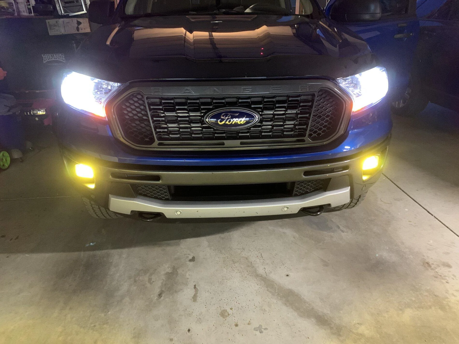

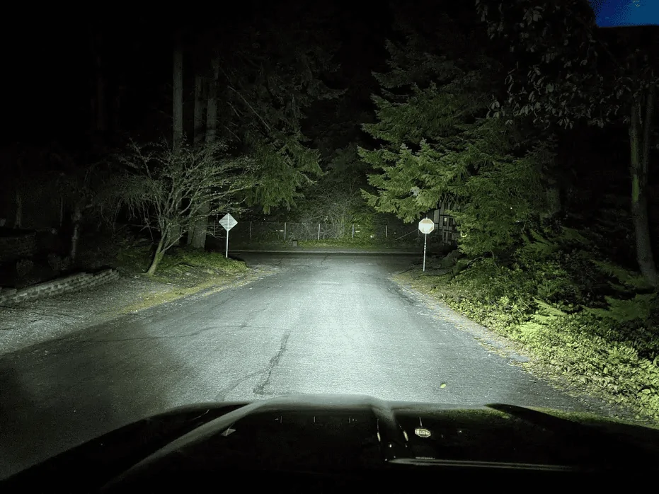

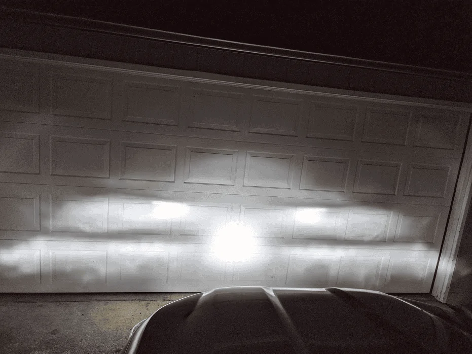

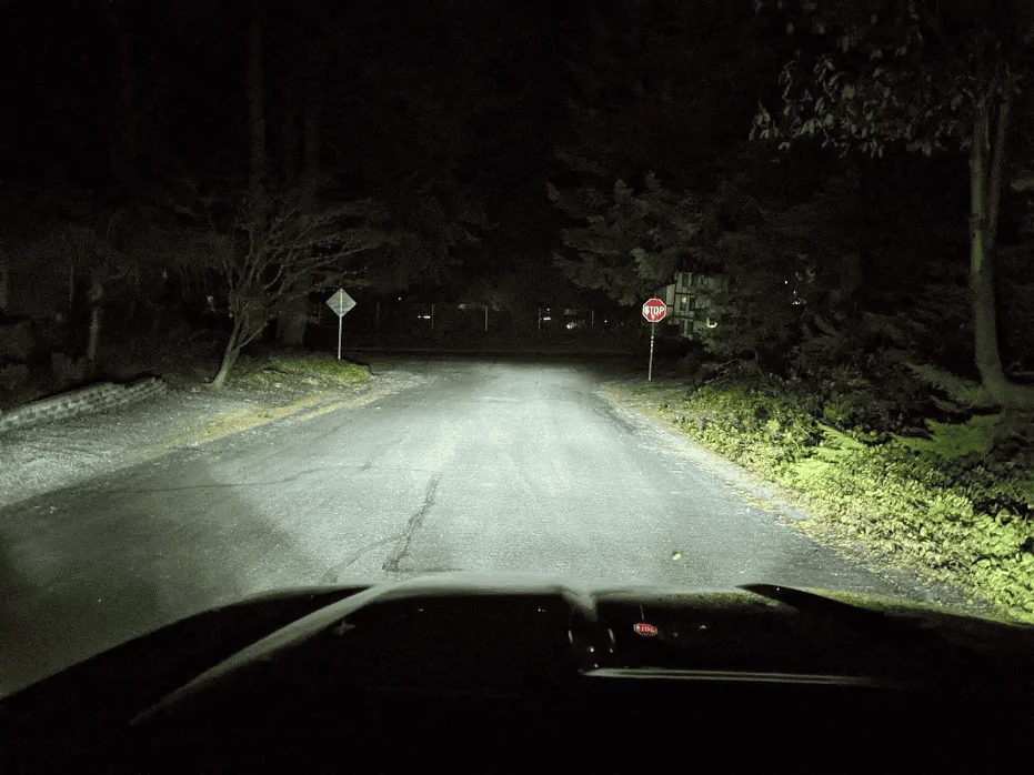

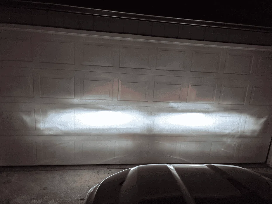

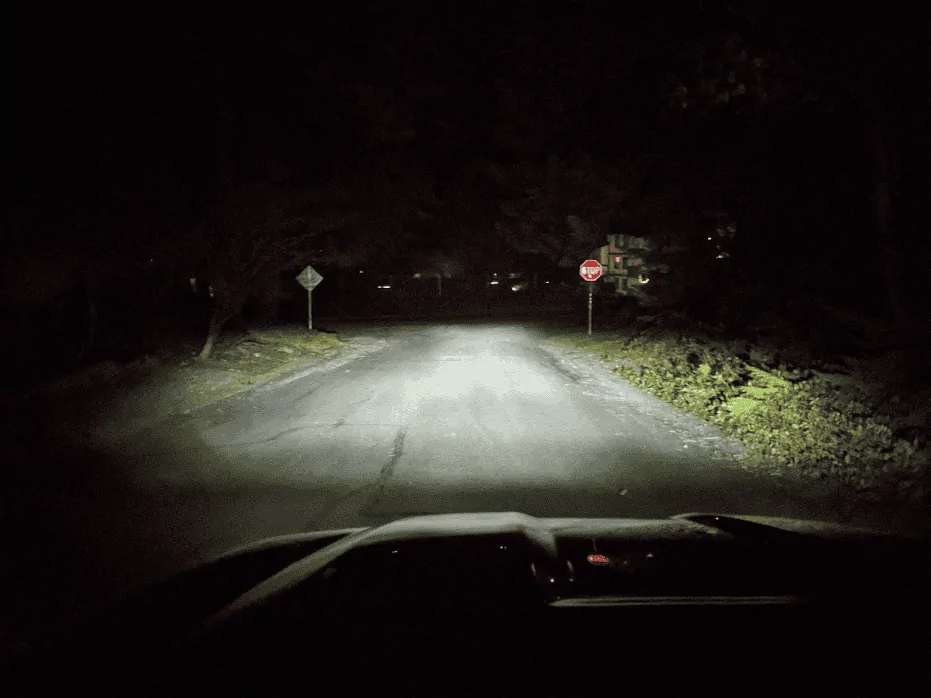

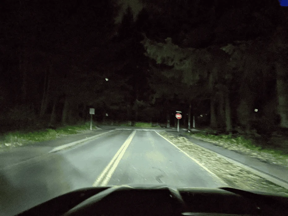

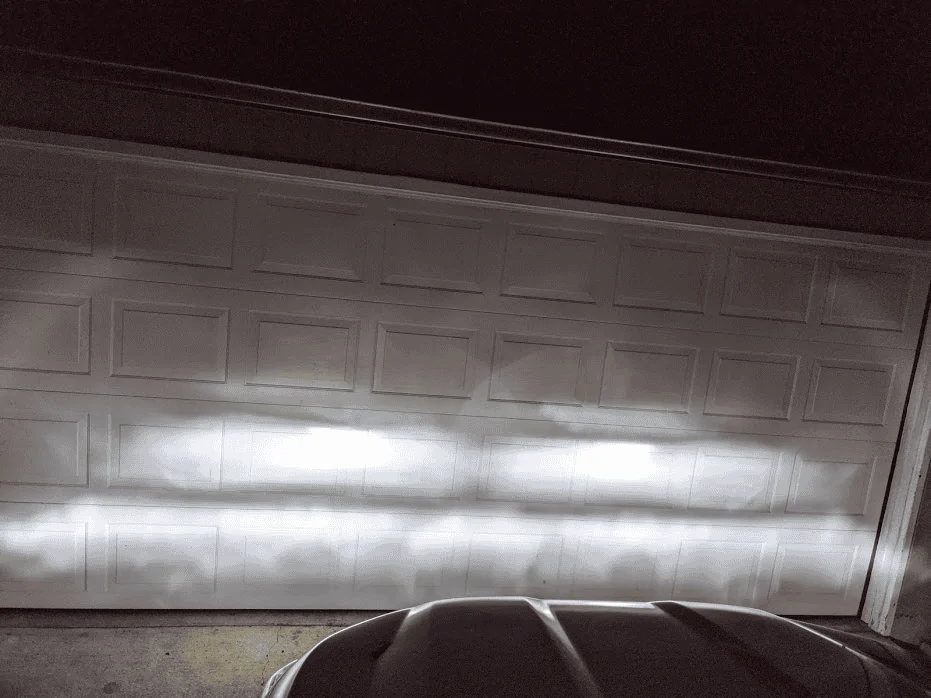

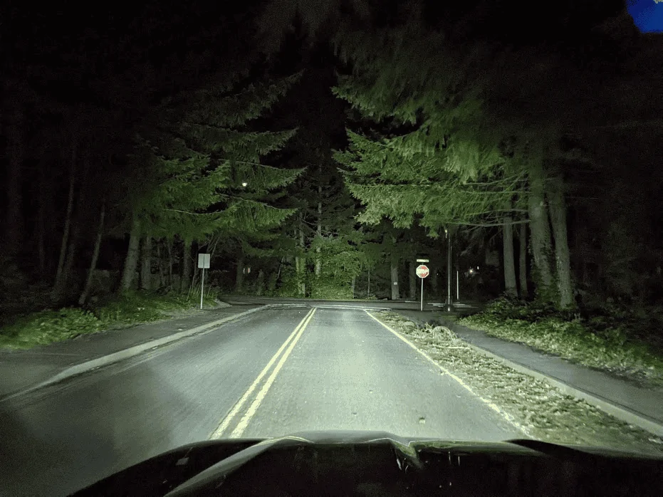

I went with Full Auxito 1:1s for Lowbeams, Fogs, and High beams. I am super happy with them. No adjustments needed, direct swap. I took before and after photos of all lights and they lined up perfect. No flashes from other drivers and the light output is massively improved, without worrying about blinding others. I'd say the fog lights surprised me the most by how much more output they have.
Below are some photos. I do not have any w/ the high beams, but the output is the same as the low beams, just aimed higher as high beams are.
https://www.amazon.com/gp/product/B07WMG43QJ/ref=ppx_yo_dt_b_asin_title_o00_s00?ie=UTF8&psc=1
https://www.amazon.com/gp/product/B07TQLGGBR/ref=ppx_yo_dt_b_asin_title_o01_s00?ie=UTF8&psc=1
Low beams and Fogs:
Low beams no fogs:
Low beams, fogs, & light bar
On street Low beams no fogs:
Low beams + fogs:
Low beams, fogs, light bar:
Different street low & fog:
Different street low, fog, light bar:
