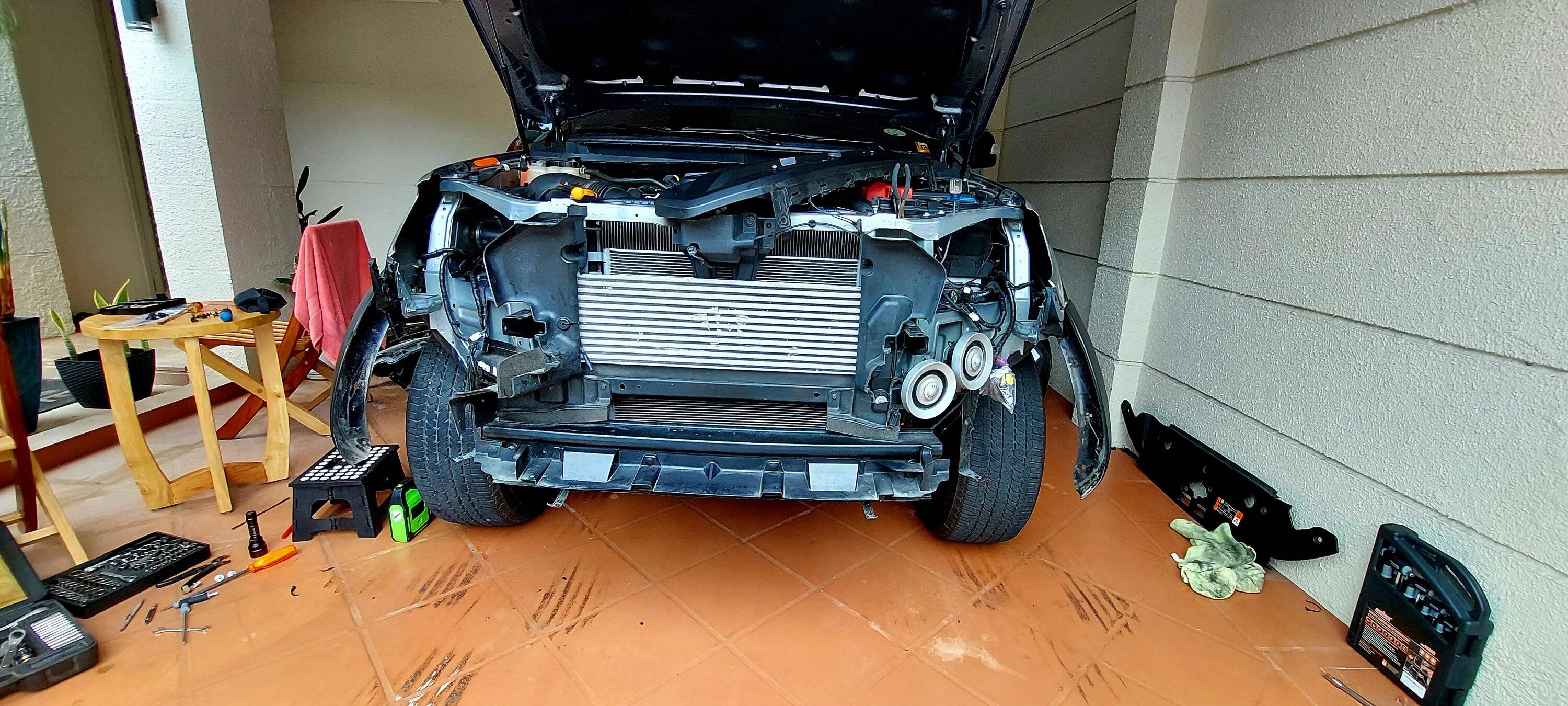

Headlights look cool. But I have to ask, do you park on a tile floor? That is pretty cool!
Yes that my carport. Tile floors for parking is the norm here. But when it's wet its slippery as hell. Especially when the owner has painted the tile. When I build my house it will have tile but not smooth.
