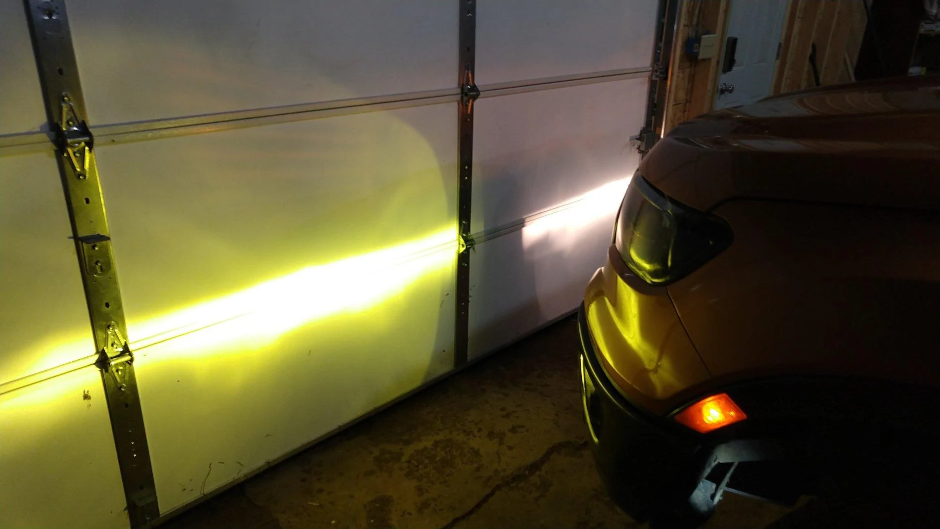

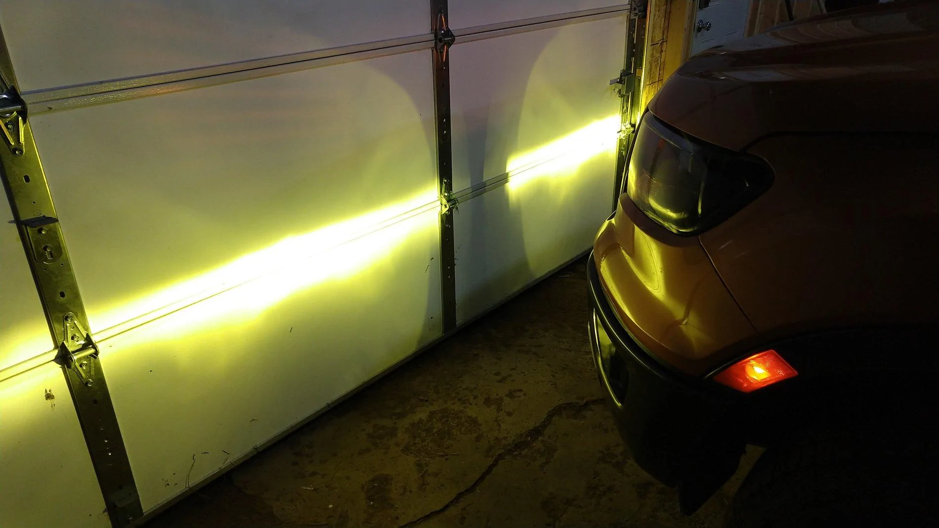

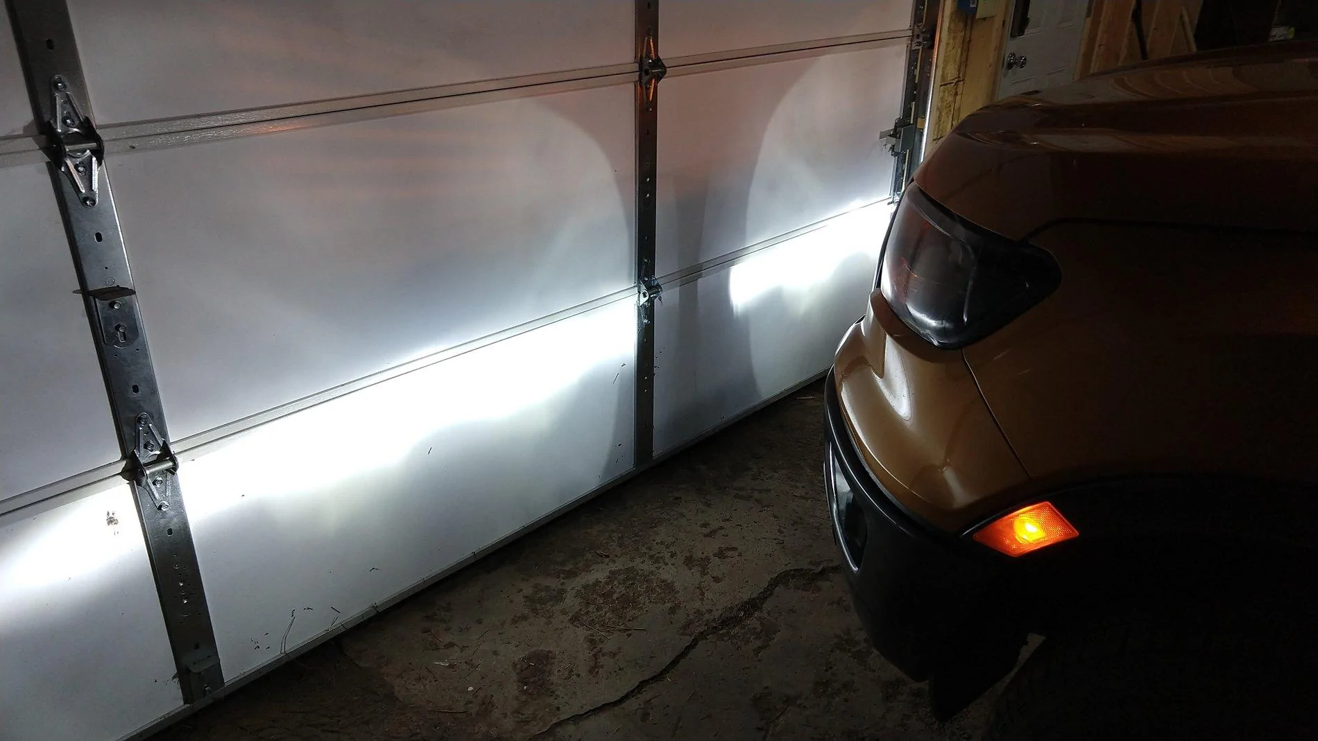

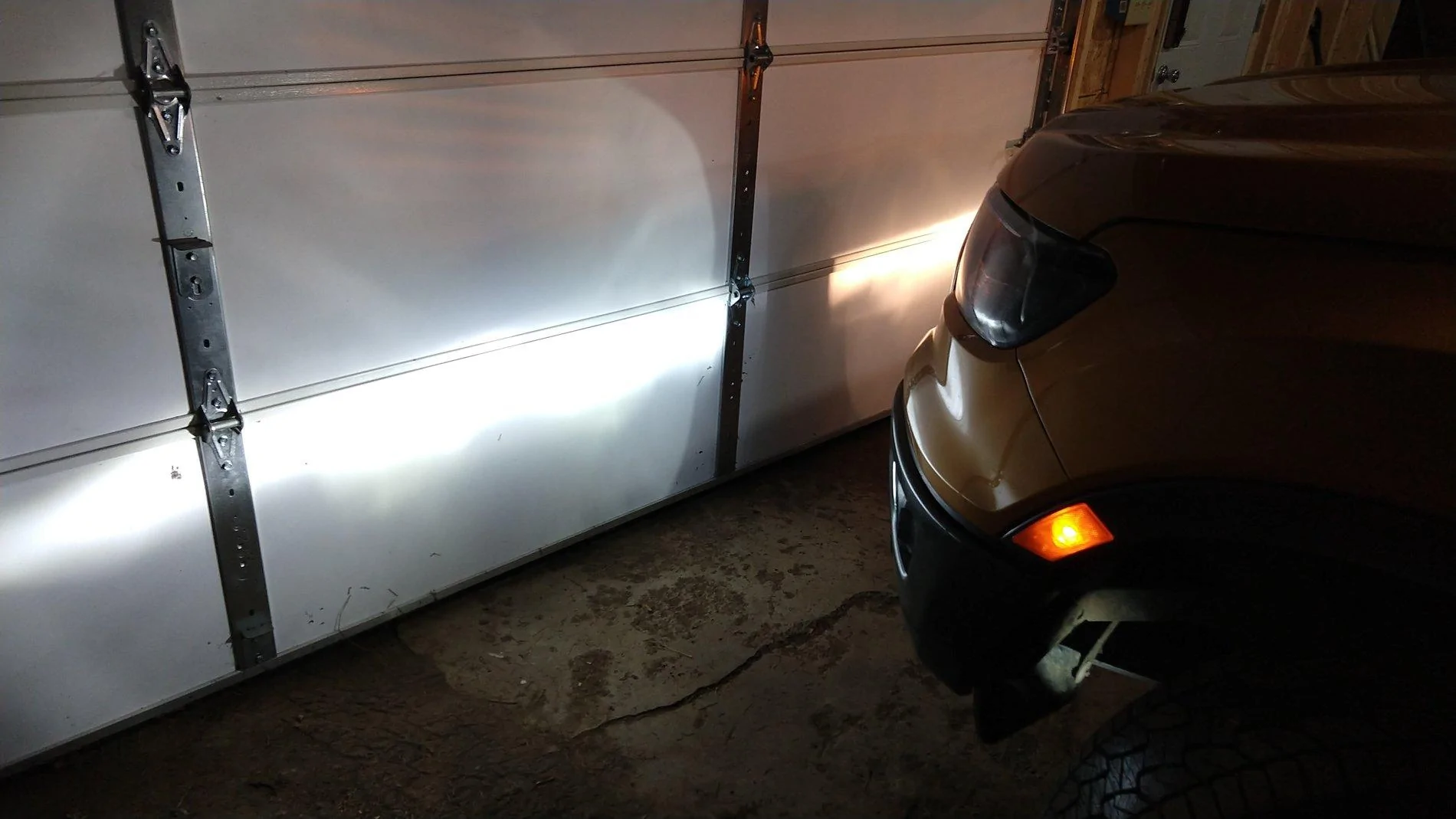

LED fogs came in yesterday, and I was able to find time after dinner/dishes to get out and install them. I thought it was going to be harder to reach up between the crash bar and plastic shroud to get at the fog lights, but it wasn't that bad. The only hard part was trying to blindly find the hole to reinstall the new lights.
One thing you'll notice with these dual color ones (and someone pointed out could be a problem previously) is that they beams don't exactly line up with the stock halogens. The white beam is a little low and the yellow beam is a little high, just because of where the light chips are on the stalk. But luckily (or maybe just by happenstance of the way I installed them) it is that way and not the other way around. I'd much rather have the white directed lower to keep that more intrusive color away from peoples eyes. They yellow is warmer and less hurtful on the eyes, so it shouldn't bother oncoming drivers as much. We'll see though.
Another thing that was happening when I was testing them out was they were being finicky and unpredictable. Turning on different colors (right white, left yellow), or not switching when I wanted them to. But I tried again this morning on my drive into work and they worked as advertised. So I'm thinking it had something to do with the truck being keyed on, but not turned on.
Passenger halogen, Driver LED (white mode)
Passenger halogen, Driver LED (yellow mode)
Both LEDs (white mode)
Both LEDs (yellow mode)
