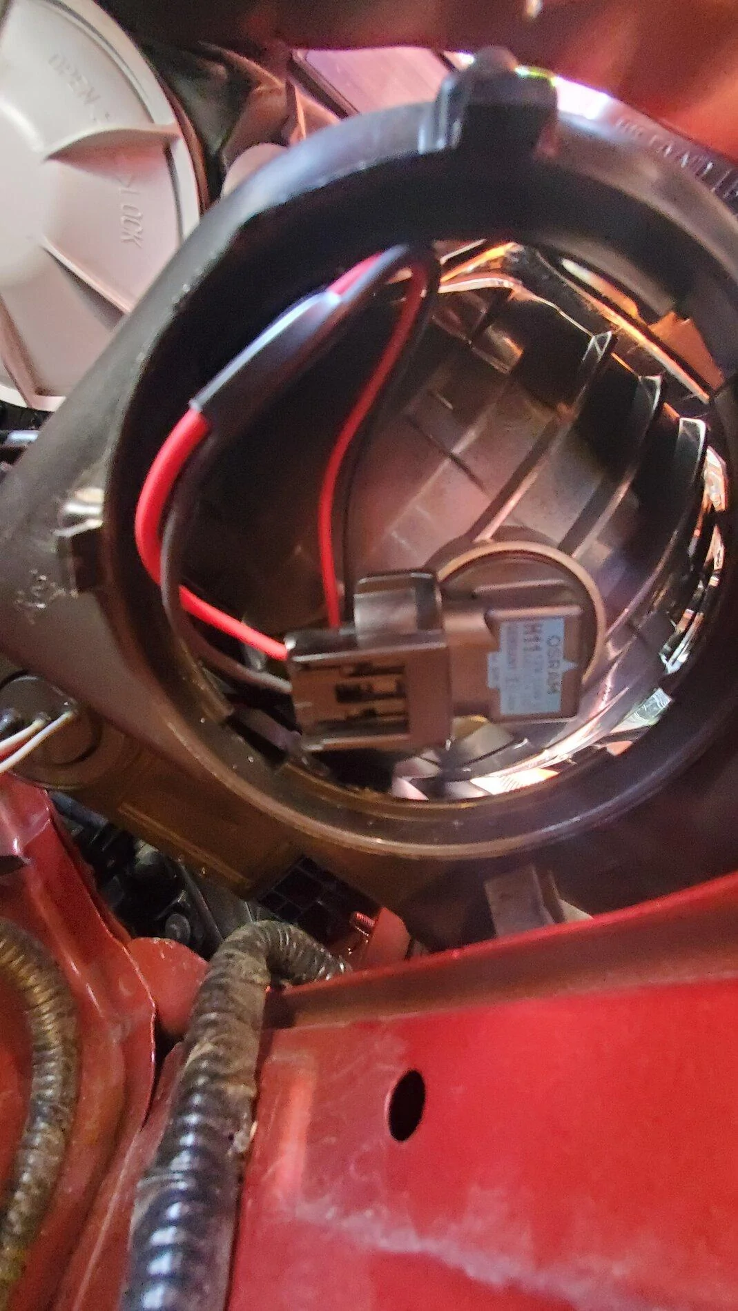

So I am changing all my halogen lights with LED and it has gone quite well until now. I am trying to remove the passenger (right) side low beam hadlight. I can get it twisted off counter - clockwise about 95% or more but the connector to the halogen light is hitting the side of the back side of the assembly (appears the backside of the assembly is eccentric and not an issue on the driver side) and I cannot twist it any further. I've tried to take the connector off since that is what is hitting the side but can't get a screwdriver in to pop the tab. Has this happened to anyone else? Any solutions?

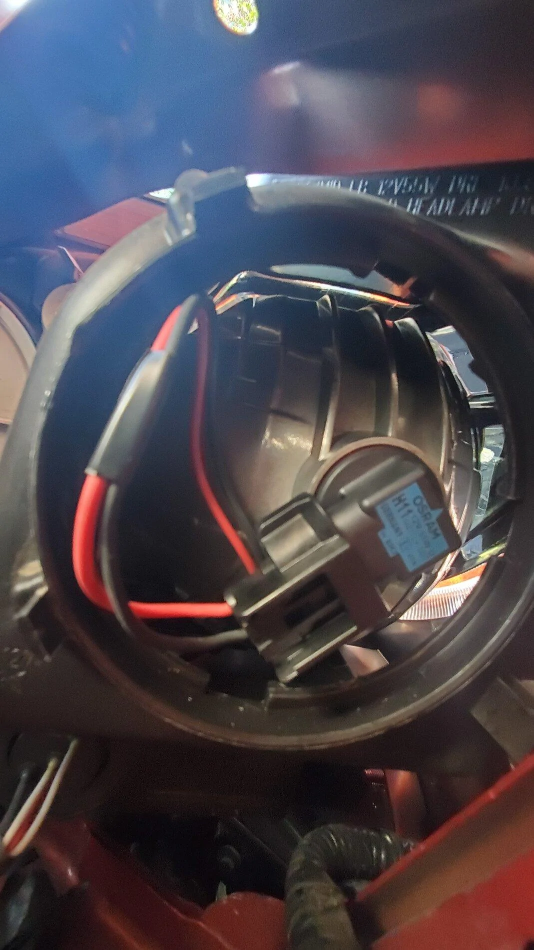

So I was able to get the light out by disconnecting the connector (a bit of a pain) first. Unfortunatley the LED light won't seat and twist since the CSP Mini LED 148 slightly larger than the halogen and the connector hits the frame where the dust cover goes. Attached are two photos showing the offset position of the halogen light not leaving enough room to fit the larger LED. Anyone else with this issue and / or solution. Rest of the lights fit perfect.

If I remember when I did mine, I had to install the bulb and reconnect wire afterwards. I had different bulbs but people have said the CSP minis fit.
