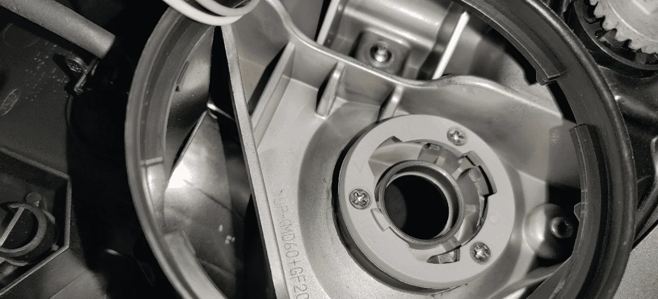

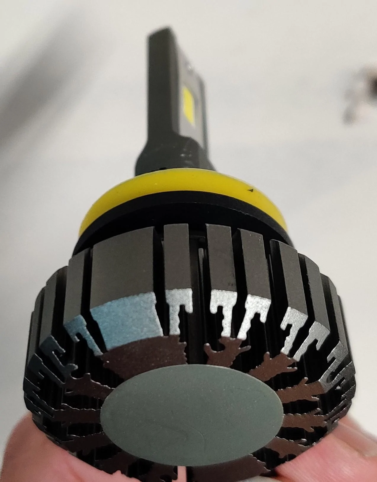

Ok, I took a different path, and purchase an untested H11 Lowbeam bulb available on Amazon. Selection criteria was as follows:
  • Fanless
  • Canbus friendly
  • 18-20 Watt each bulb
  • Some visible indicator of the mount being separate and distinct from the body. Meaning I could remove and modify the mount.
  • Reasonable price and 4.5 Stars (~$35)
I purchased the following (On a Black Friday Sale): AUXITO H11 H8 H9 LED Headlight Bulbs, 300% Brighter, 6500K White Fanless Headlights, Plug and Play Direct Replacement for High Low Beam Headlights /Fog lights, Pack of 2

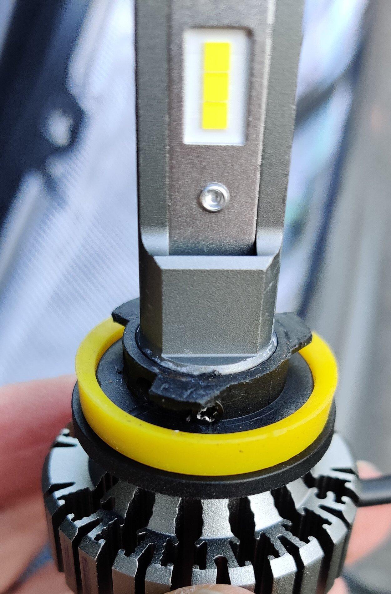

As suspected, when mounted in the Ranger the bulb was angled at about ~15 degree. (Common report amongst posters for bulbs in the low beam location) Picture below is aligned as it would appear when mounted in the Low Beam socket.

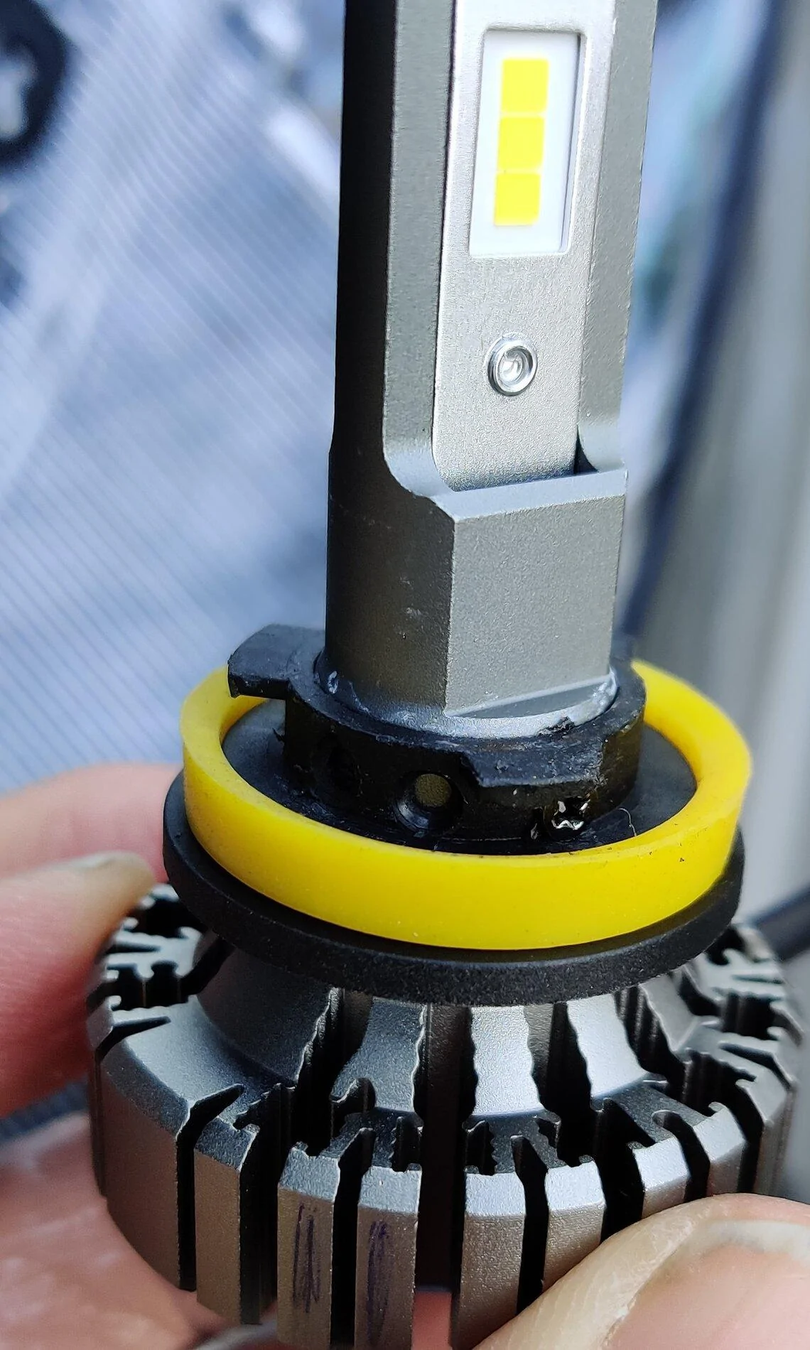

The mounting collar is plastic and secured with a single screw. Removing the screw and drilling a new hole 7mm towards the tab allowed the lamp to be a perfect 90 degree in the lamp housing.
The original hole now aligns with the upright mark on the housing. 7mm was the distance, center to center from original to new hole. When installed, the "blade" is perfectly vertical as it should be.
Results were "good" but not great. Light is centered, and notably brighter (using an Android light meter on my phone, twice the lumens recorded), but the cutoff has some overage. Perhaps the overage is less noticeable on the halogen as the photo show some overage there too. Note: My driveway is fairly slanted, so the angle between the lights is from the truck position, not from the light! :)
In any case, I have reasonably bright lights, the cutoff is sufficient to prevent getting flashed. I can drive at night and actually see where I am going. Mission accomplished.
Conclusion, the bulbs are very serviceable, but will require minor user modification.

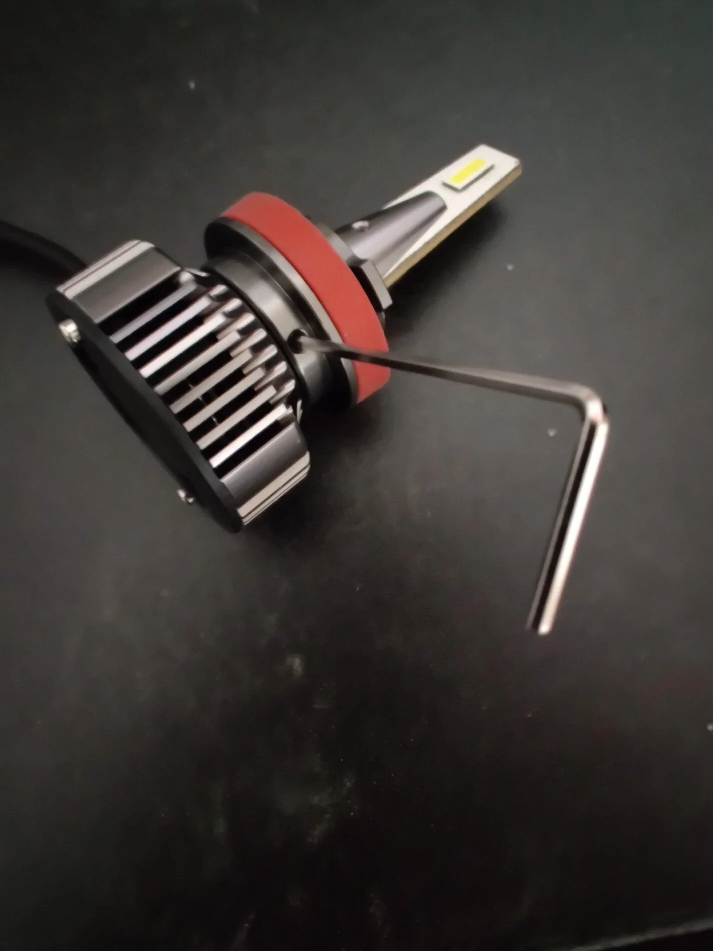

LED Bulbs Install - Phase 1
Started the halogen bulb replacement with the low beams first (Phase 1). Waiting on the high beam bulbs to arrive so will do those next. If I can figure out how to get to the fog lamps per suggestions received, then will do the those last.
Selected these Auxito bulbs for the low beams: https://www.amazon.com/gp/product/B07WD6G42D/ref=ppx_yo_dt_b_asin_title_o01_s00?ie=UTF8&psc=1
These were plug and play and so far so good - haven't driven extensively yet but seem to be working great. Will update if any issues come up.
Installation tips:
  • I needed to do the beam adjustments as mentioned in the Auxito manual.

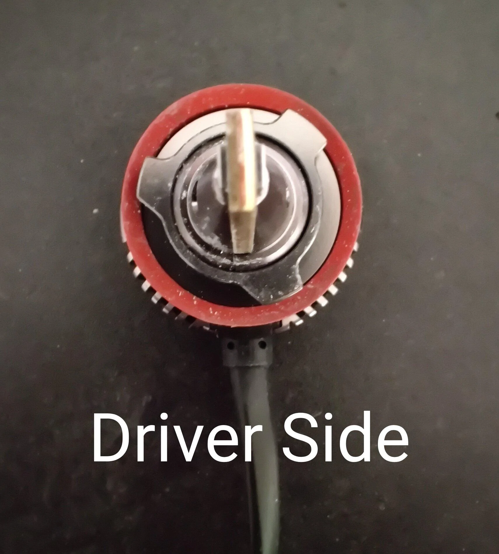

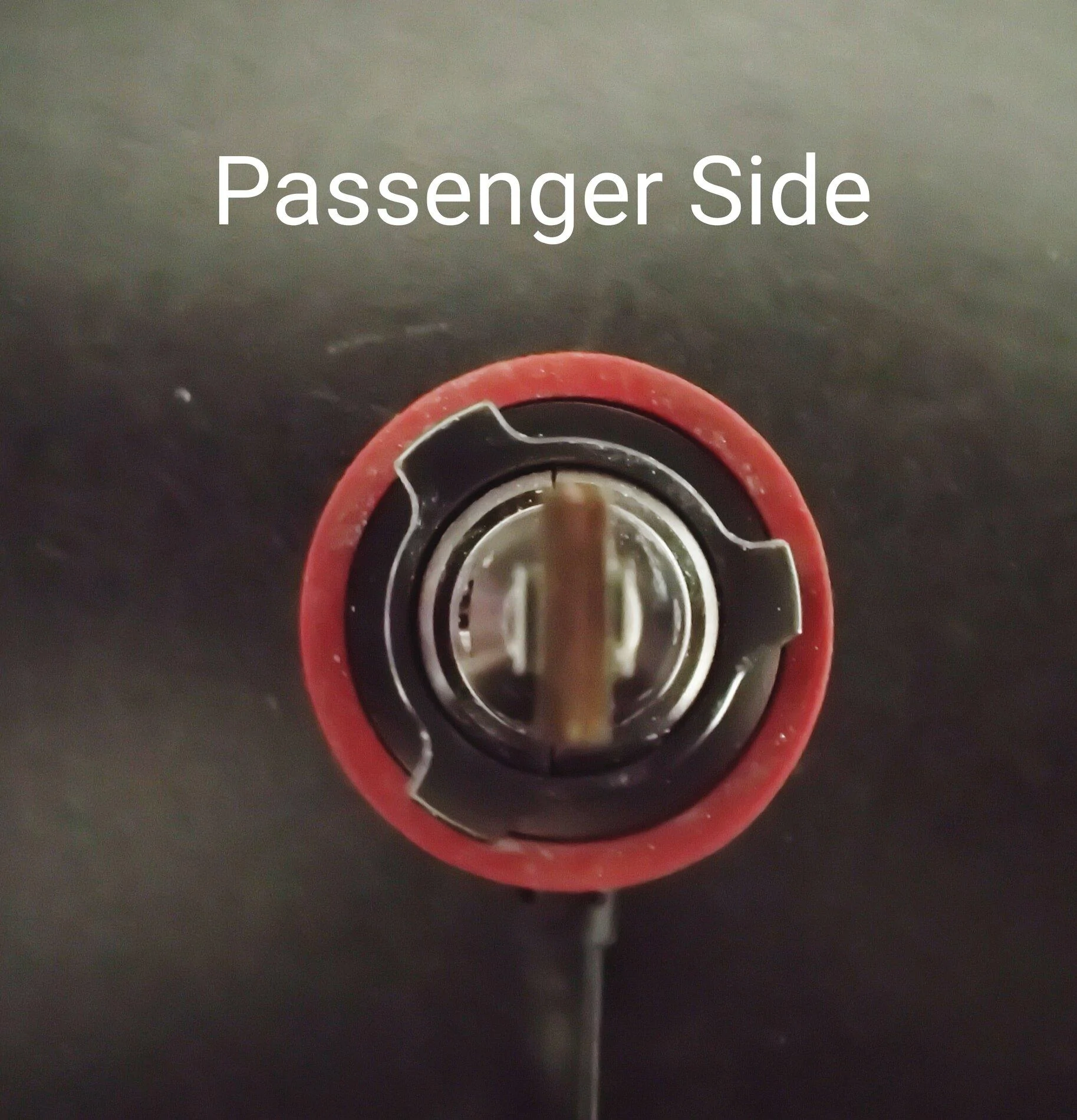

  • The initial orientation of the bulb was almost the same (i.e. incorrect) as that shown marked with the X (see attached).
  • This bulb comes with a tiny Allen key to rotate the bulb to the correct 90 deg. orientation. (see attached photo).
  • See adjusted position of the mounting tabs in relation to the bulb, in the "Correct Adjustment" photos, for the correct orientation.

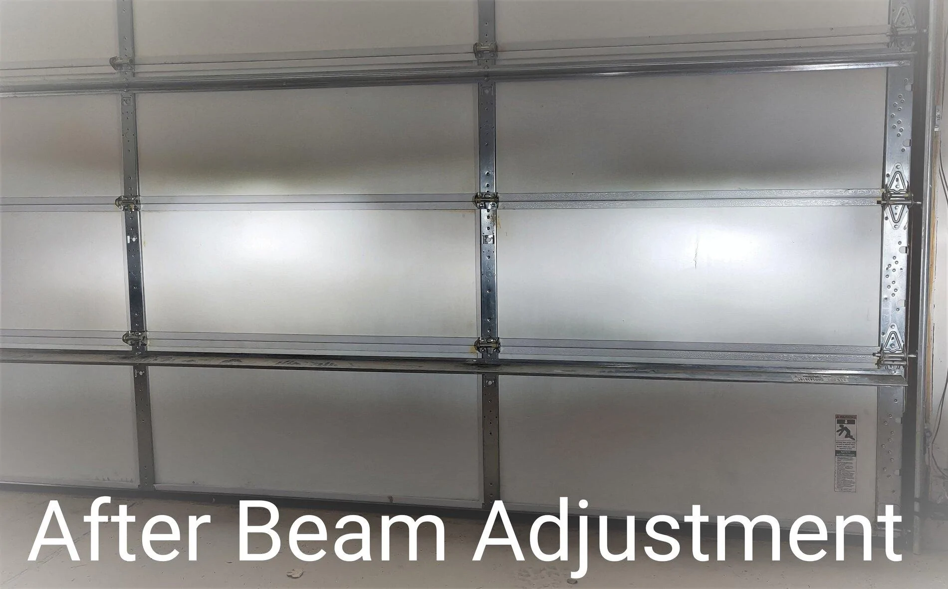

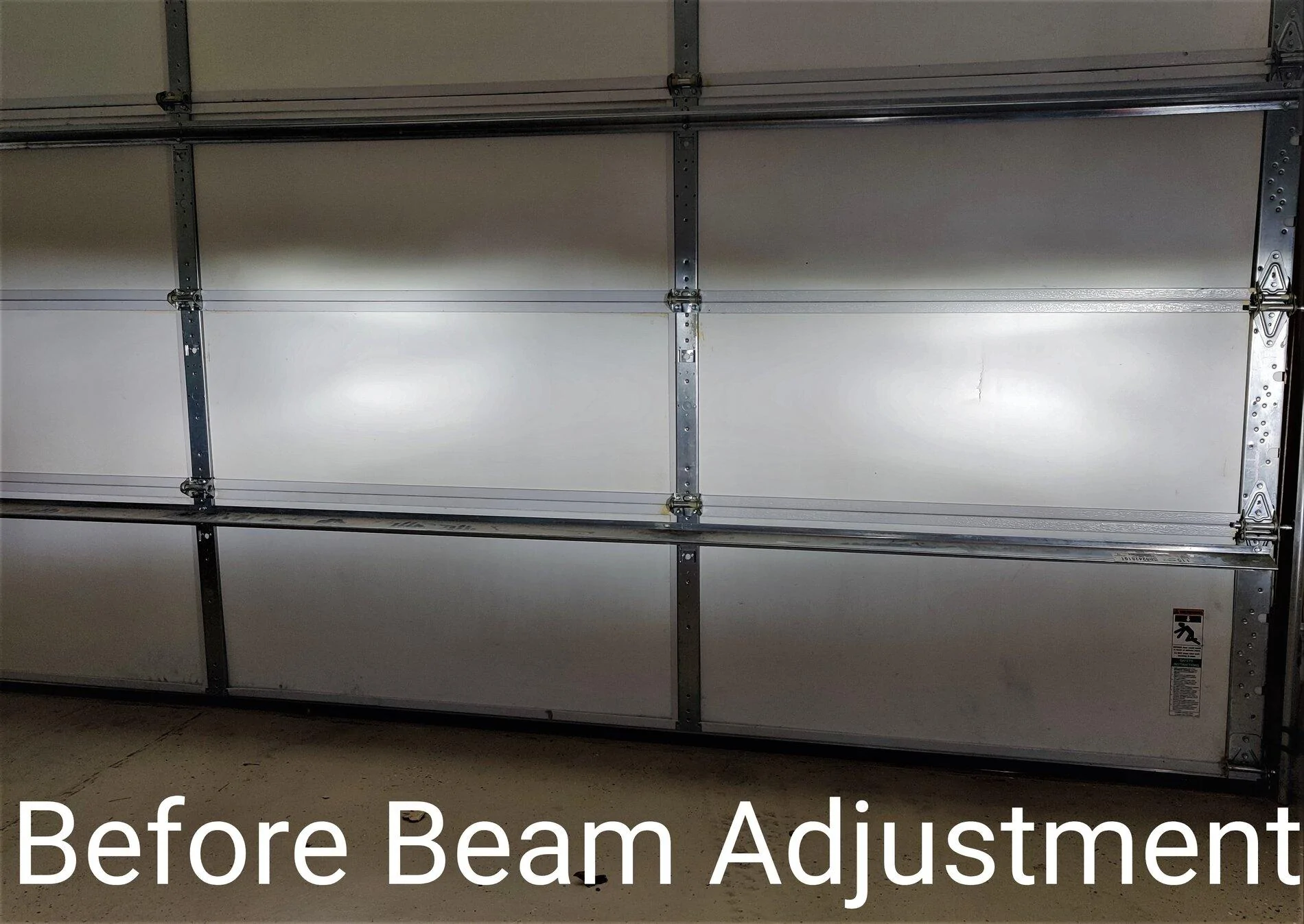

Have attached beam pattern photos before and after the beam adjustment. This is from a distance of only 11 ft. to the garage door (as far back as I could go). The height seems to be correct, but will do measurements outside at night to see if they are per those recommended (the 25 ft. rule).

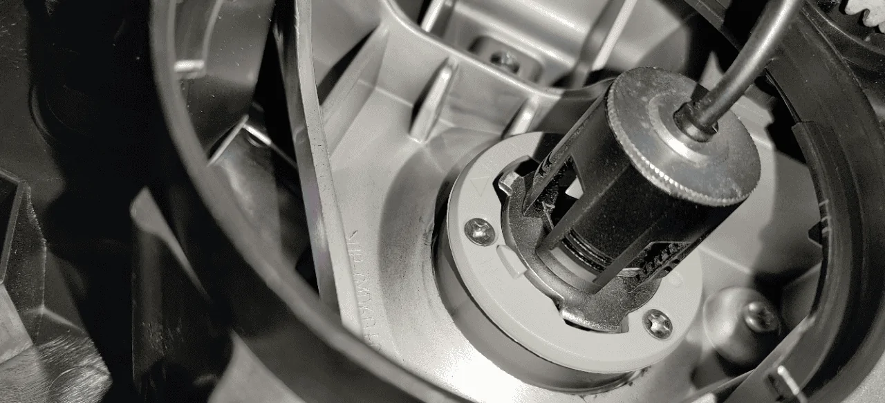

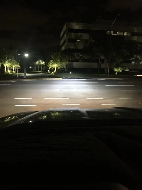

Anyone having COMPLETELY different patterns from the passanger headlight compared to the driver headlight? I put some Auxito 12,000 LM 1:1s in. Driver side low beams looks awesome... Passanger side low beams are throwing light to the heavens. Switched the bulb and it is the housing, not the bulbs causing this.
TJC
Aug 28, 2020
46
3,978
10,027
I see level (9 o'clock / 3 o'clock) on drivers side and 10 o'clock / 2 o'clock on the passenger side in my 2005 Ranger. In this 2005 Ford, it is the lens, not the bulb.
I moved the passenger side lens up to compensate and the high beam now lights up the trees! I am going to readjust the passenger side back to its original location. I am not happy with that Ford design decision.
I have not changed the bulbs in my 2020 Ranger, but I would not be surprised to see a similar design.
