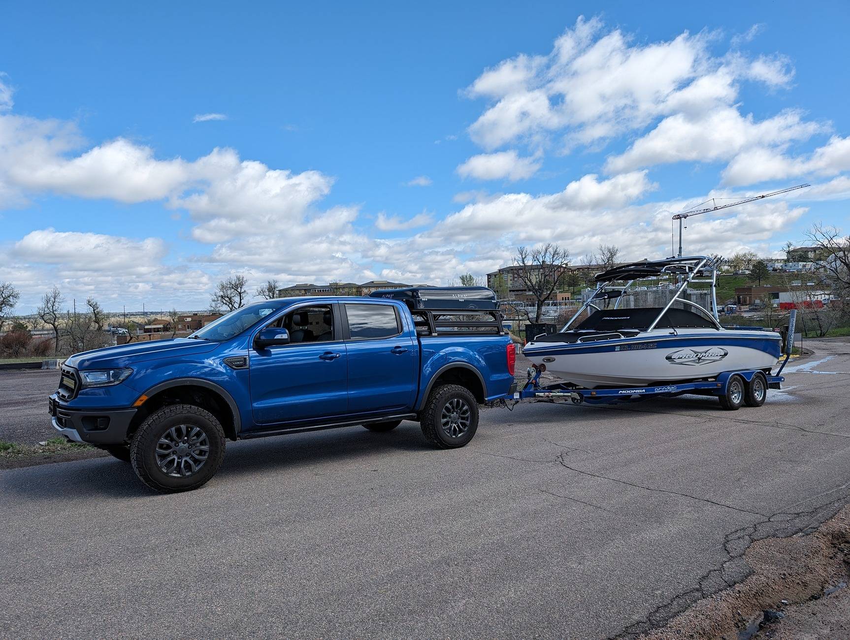

I'm running the Autospring add-a-leaf. It is a stiffer ride on speed bumps but handles a loaded truck nicely. Towing my boat with it rocked too.

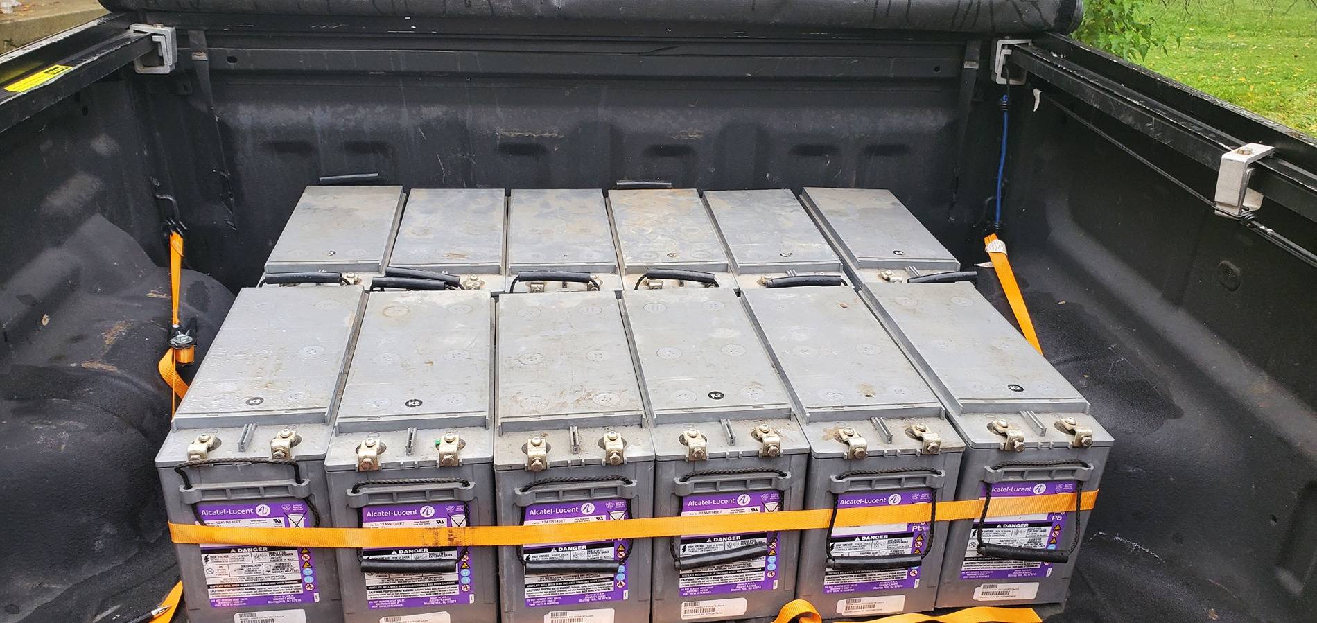

I have a 3.5 Rough Country lift and I havent gotten my truck to squat yet in over a year and I have had 3/4 ton in the Bed coming back from a Cell tower in Way Upstate NY I had 14 Telco batteries at 110 each, plus 2 people and a 100 Lbs dog, way TF over rating and got 17 mpg doing it, I dont worry about stopping cause at 285/75 I got a lot of tire on the ground too always pumped to 41 psi, I swear to god I didnt even know it was back there!

14 batteries at 110 lbs 12 up against the Front wall and 2 strapped to the tailgate, Plus two people and a big ass Dog, LOL I had to stop fast on the interstate because of an accident in front of me and I know the dogs ass puckered hahaha you would think he would be use to me by now....

I look at those numbers as a minor suggestion LOL knowing ford its probably half of the safe zone
As I have said in the past your choice, your money, your A$$.
