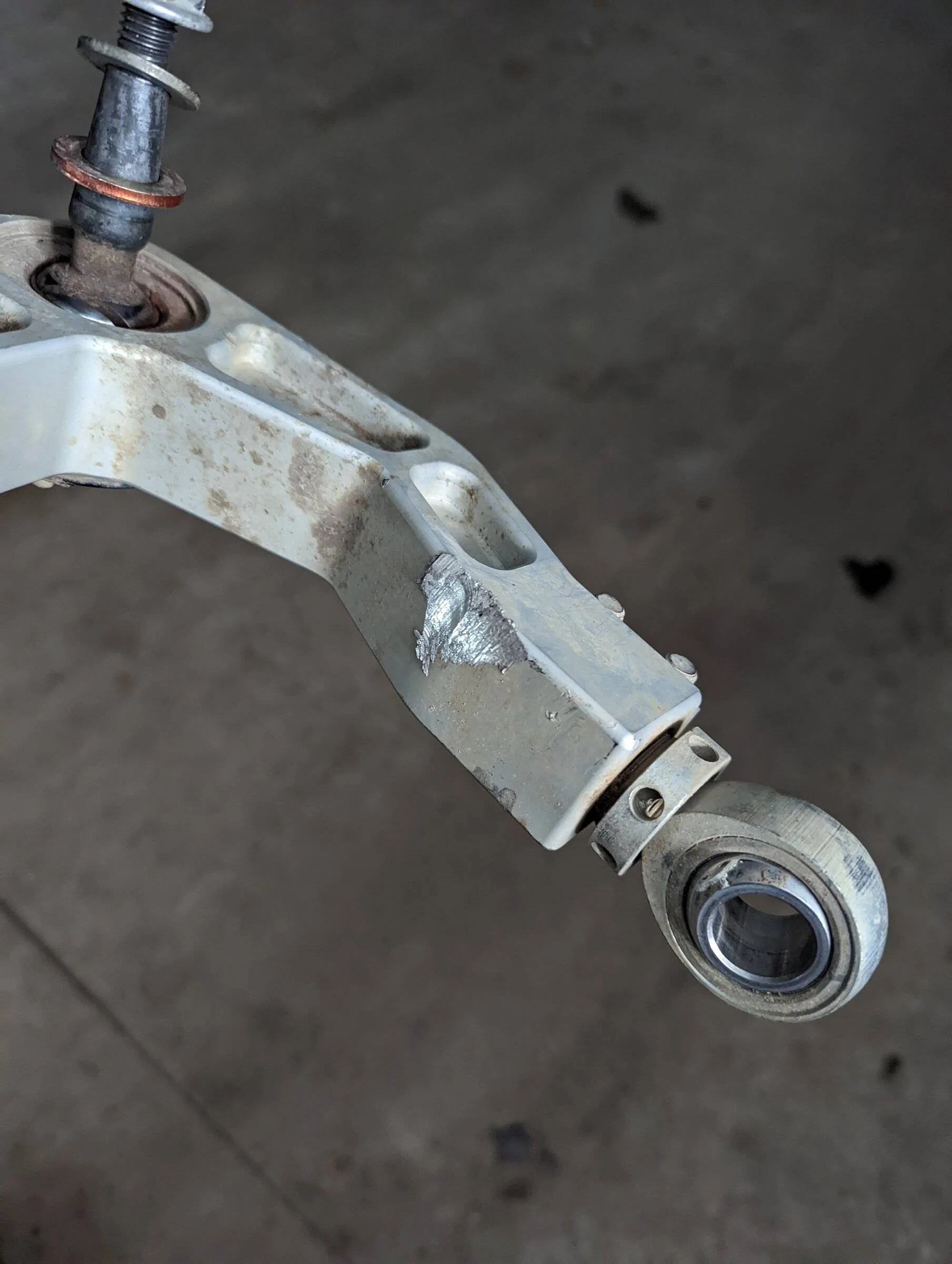

Rampant quality issues, poor design. My shocks leaked from day one, then when I eventually took the system off, I found this:Why do you say 'avoid Icon'? I've been looking between Icon and OME leaves, but I don't want to raise the rear.

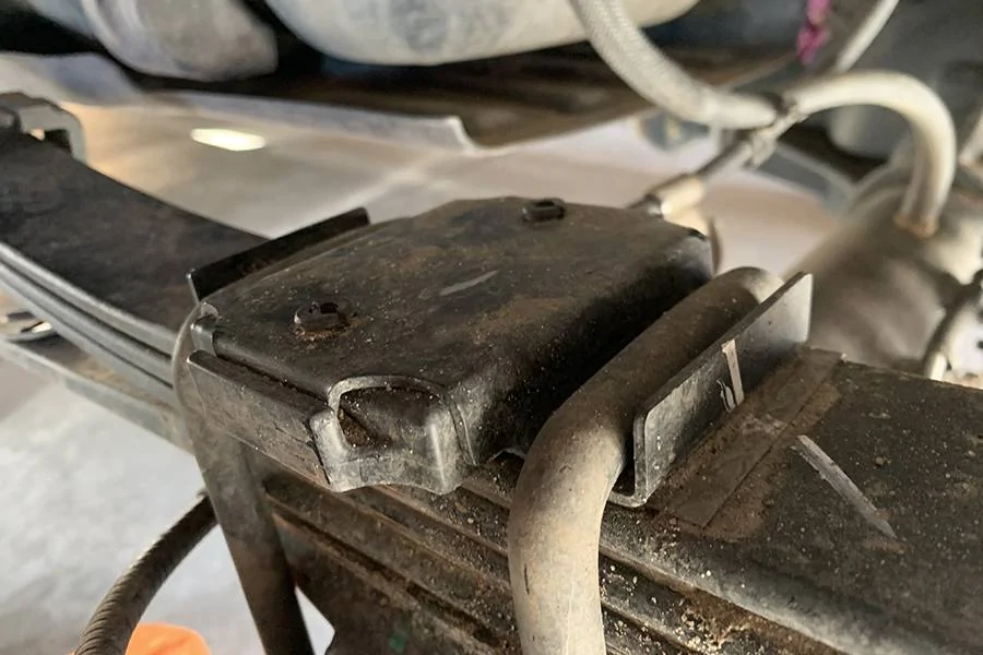

Hi Adam...Did you install the Firestones yourself? I am wondering if you ran into an issue with the bottom bracket fitting over the bumper plate? On my truck, there is a plastic piece under the plate that extends a 1/4" on each side that interferes with the bracket fitting. I'm pretty new to doing this kind of work and I'm not sure what that piece is really for, it does not appear in the installation diagram.I have the rear Firestone Airbag kit purchased used but in the box from a member here and am Very happy with them. Able to level the truck no matter what the load is.

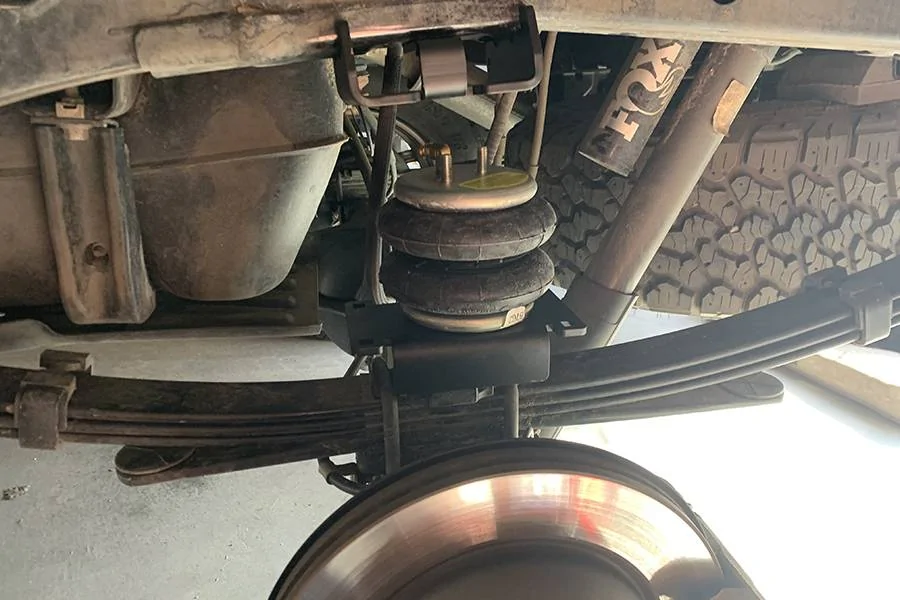

Ok, I'm sure you have a lot of experience off-roading but your first sentence is false. For what you do; sure, they may not be a good solution. However, for others they are a great solution. I have the Firestone Airbag kit and I can have a good unloaded ride and also have my truck STAY LEVEL when towing my camper. No they don't give me more capability and Yes they would limit articulation if I did Rock Crawling (I would put that Crawling kit on them if I did that). When I am unloaded and I put them at 5 psi you would never know they are there. Would I still like to have some good Devers or ROW leaf packs on my truck? Yes I would, but I might still run these Stones.In my experience Air Bags are a poor fix that negatively affect ride quality, articulation and capability. Deaver Spring in Southern CA have been building custom off-road suspensions for a very long time and I have put their spring packs on my last three truck builds. They produce two Progressive Leaf Spring kits for our Rangers, Standard and HD. My Super Pacific camper and typical camping gear/water payload averages 510-580 lbs. I went with the HD option and am very happy with the Deaver product. This leaf pack is NOT designed to lift the truck. It is engineered to retain factory ride height with improved ride quality.
