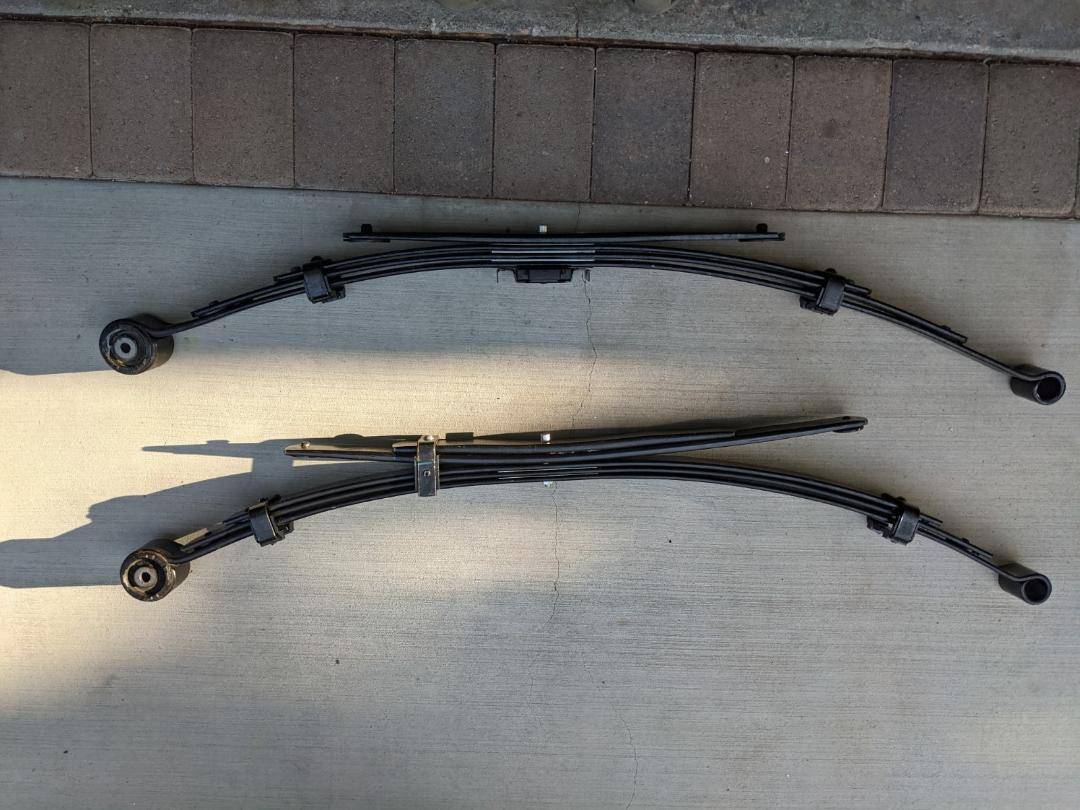

I went for them hoping they would lower the back of the truck, but only 5/8" drop at the spring and just over a inch at the tailgate, that's when I removed the 5th leaf, same height as my stock Tremor springs with the 5th leaf, so it was a fail, but I figured it would give me a cheap set to play around with (under $300 a pair and showed up in a week) and keep my stock springs, so now I am de-arcing the global spring 1.5" to level the truck and so my old junk back can load the truck easier.
The Global spring is the bottom spring, all the long leafs are thinner by 1-2mm, but longer lengths but it has 2 heavy bottom leafs, the load rating is higher than the US springs I believe, notice how the bottom leafs are curved away for loading from the upper springs.
I contacted the seller they came off of fleet vehicles that were converted to airbags so they are basically new and they have 40+ sets.

Hey, Dr Zaius, it did lower the tailgate but that was the Tremor, it sits a little higher, the global spring would raise the back of a regular Ranger I think.
I still needed the tailgate lower, so I have sent out the global springs to de-arc 1.5", so I can have a level truck on factory multi leaf springs. (without raising the front)
