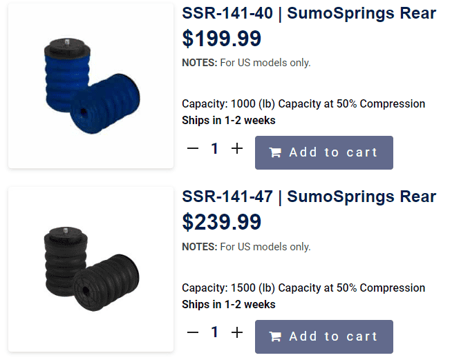

Sumo springs would be a much easier thing to do. Replaces the factory bumpstop with a longer, more progressive 'spring'. Available in a softer and a stiffer version. Many of us use them and they function as sortof a helper spring when you've got the tail end loaded down.
Unloaded, there's no contact with the pack, but as you load up the truck it starts to contact and adds support.
