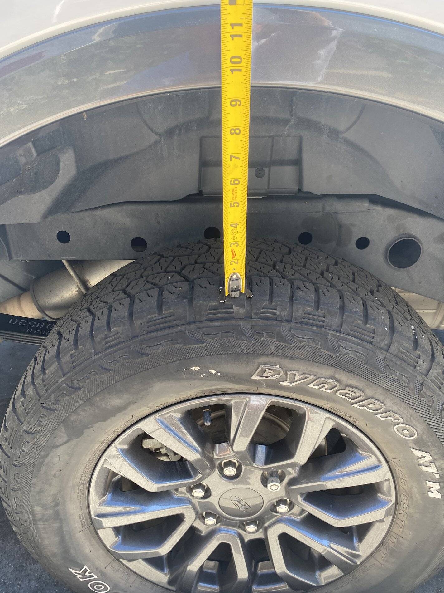

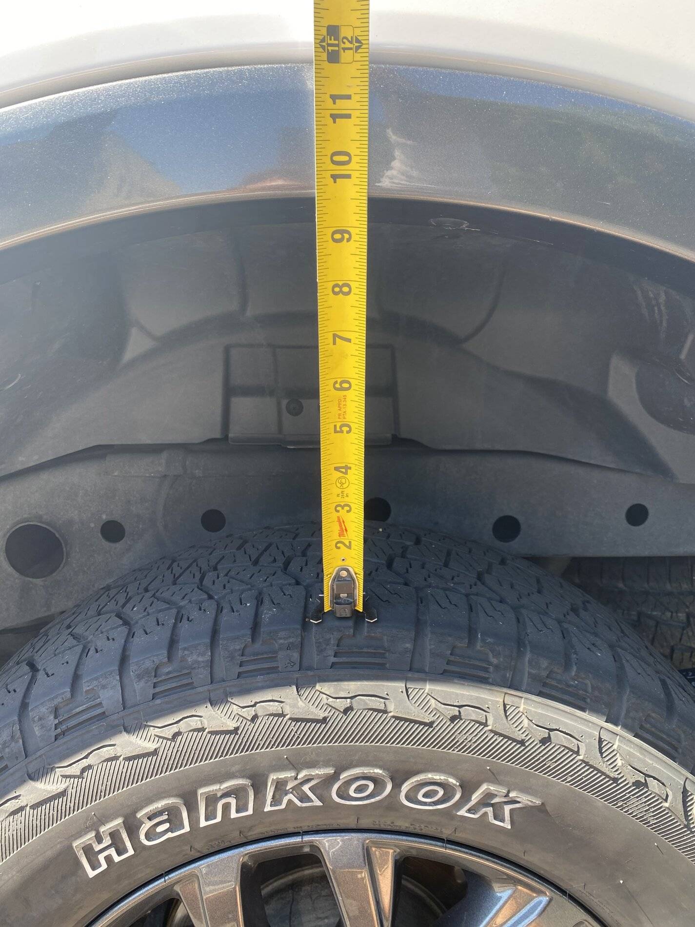

Are your measurements in the rear the same on both sides?
Pretty damn even. a little lower on the passenger side right now because I'm parked on the street. Image 1: Passenger Side. Image 2: Driver Side. Don't judge me for wanting to get every penny out of these stock tires before I move up :p
