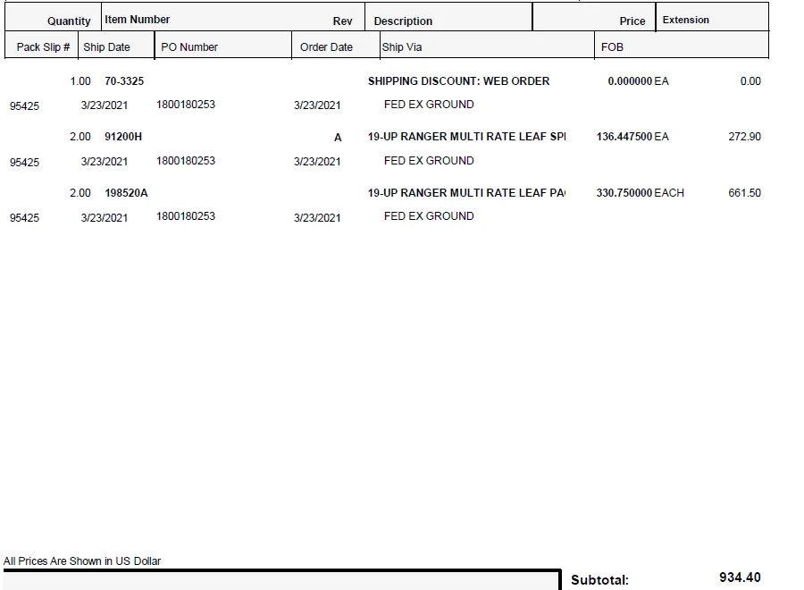

If you buy the ICON Rear Leaf Springs don't forget the mounting kits.....

You only buy one hardware kit. I bought mine from Stage 3 Motorsports last week. The total price was $790 (2 leaf springs, hardware kit, free shipping). It took 7 days from order to delivery.
Also, when you buy from Stage 3, there’s no guessing - it comes as a complete kit.

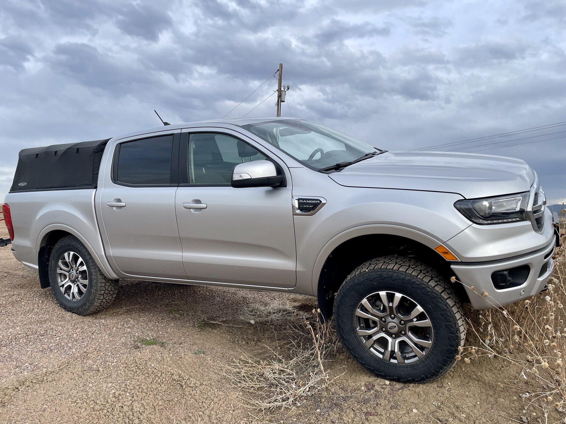

I’m on option 2 and it sits too high in my opinion. It settled about 1/4” since install. I may go back to option 1. I had the Eibach 1” blocks installed previously and my rear was not this high. I’ve literally reintroduced the factory rake.

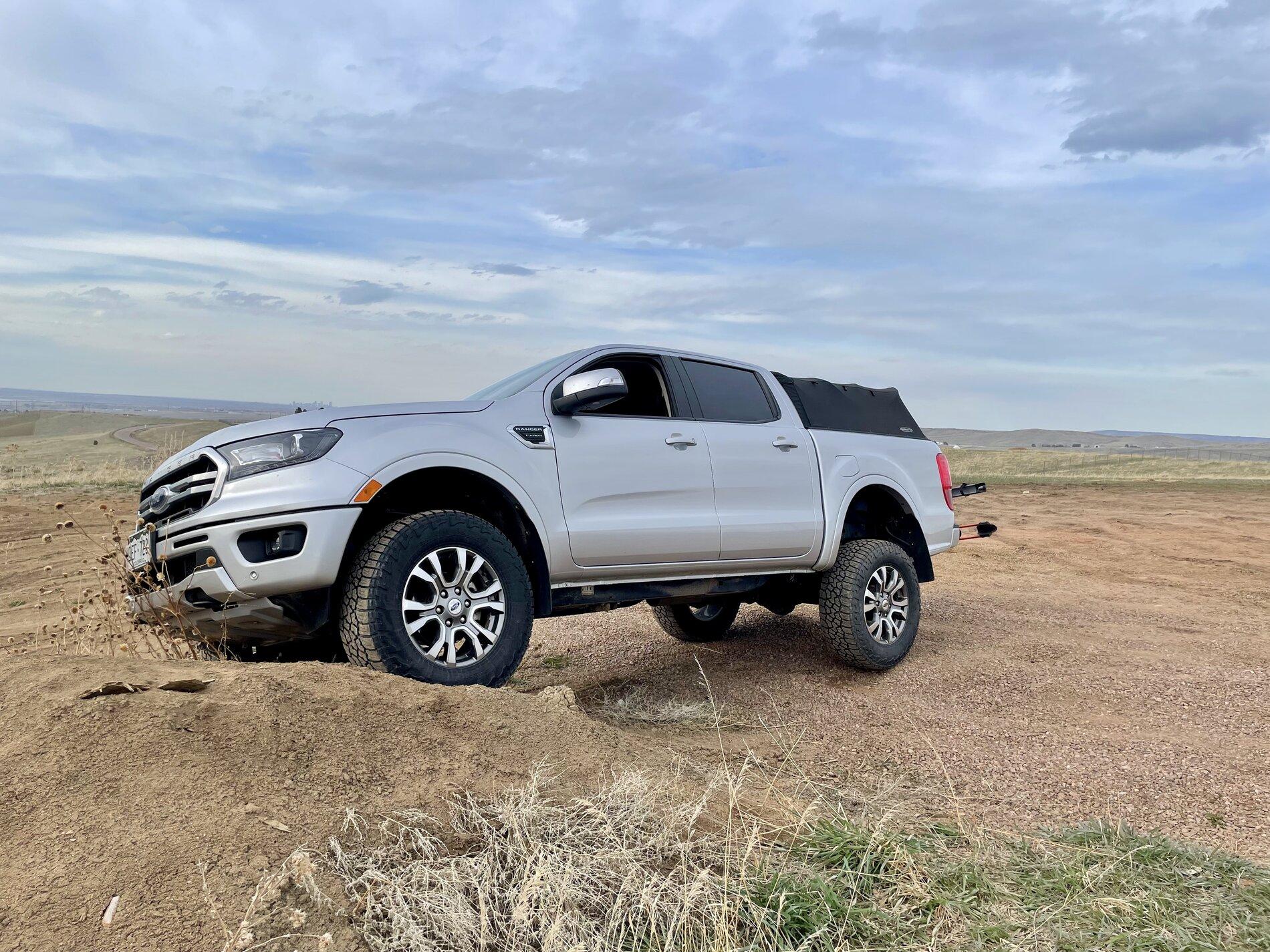

I'm almost at 3.5" on the Icon coilovers. Option 1 is straight out of the box. Option 2 has you replace the 3rd leaf in the pack with a new leaf.
