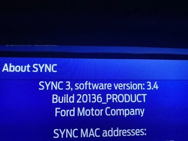

I was hoping to update to SYNC 3.4 this morning, but apparently my Ranger is up to date. It's a 2019 Lariat 501A. Does anyone have an idea when SYNC 3.4 might be available again?
The update is live again for my 2019 Lariat 501A. It was live a couple of weeks ago, but I wanted to give it time to work any bugs out. Went to download it this weekend and it said my 3.3 was up to date, but tonight 3.4.20136 is available again.

Wonder if it has the climate control fix. After I did my update a week ago, the website took it down and said 3.3 was the newest. Now it says 3.4 again. Hopefully with bug fixes. Downloading it now.
UofMEngineer
Apr 19, 2019
516
334
20' Escape Hybrid,18' Fusion Hybrid
No. Same software as before. Hopefully this has the Delay option in the script to prevent a restart loop.

Downloaded the version that is once again available and it appears to be the same file. All file names, sizes and timestamps are identical. Strange that now it shows the version as v3.4.20136 instead of v3.4.43 on the website even though they are the same version. If for some very strange reason the new download fixes the climate for anyone is there a way to re-install the same version again? Will it ignore the USB or will it re-install anyways if inserted?
Also anyone with the B&O system notice the volume profile seems to be different or something off? I had everything tuned nicely for my tastes and it seems off..or I need to turn it louder to get the same volume as before with the same settings.

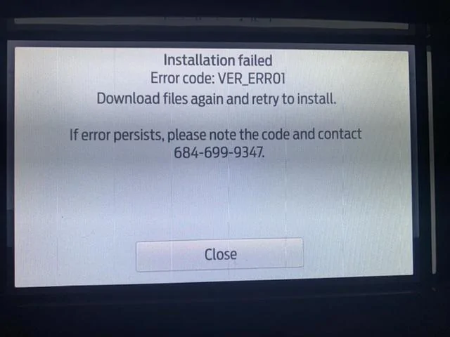

Did the Climate Controls disappear or did Ford fix the Problem?
Very Curious.
Well, if the update would actually work I could tell you. The damn truck turned itself off during the update. I just had the ignition turned on instead of wasting gas while updating. Now the SYNC system won't even start the update process at all. I reformatted the USB drive and downloaded the files again, still won't start the update with the Ranger running or not.
