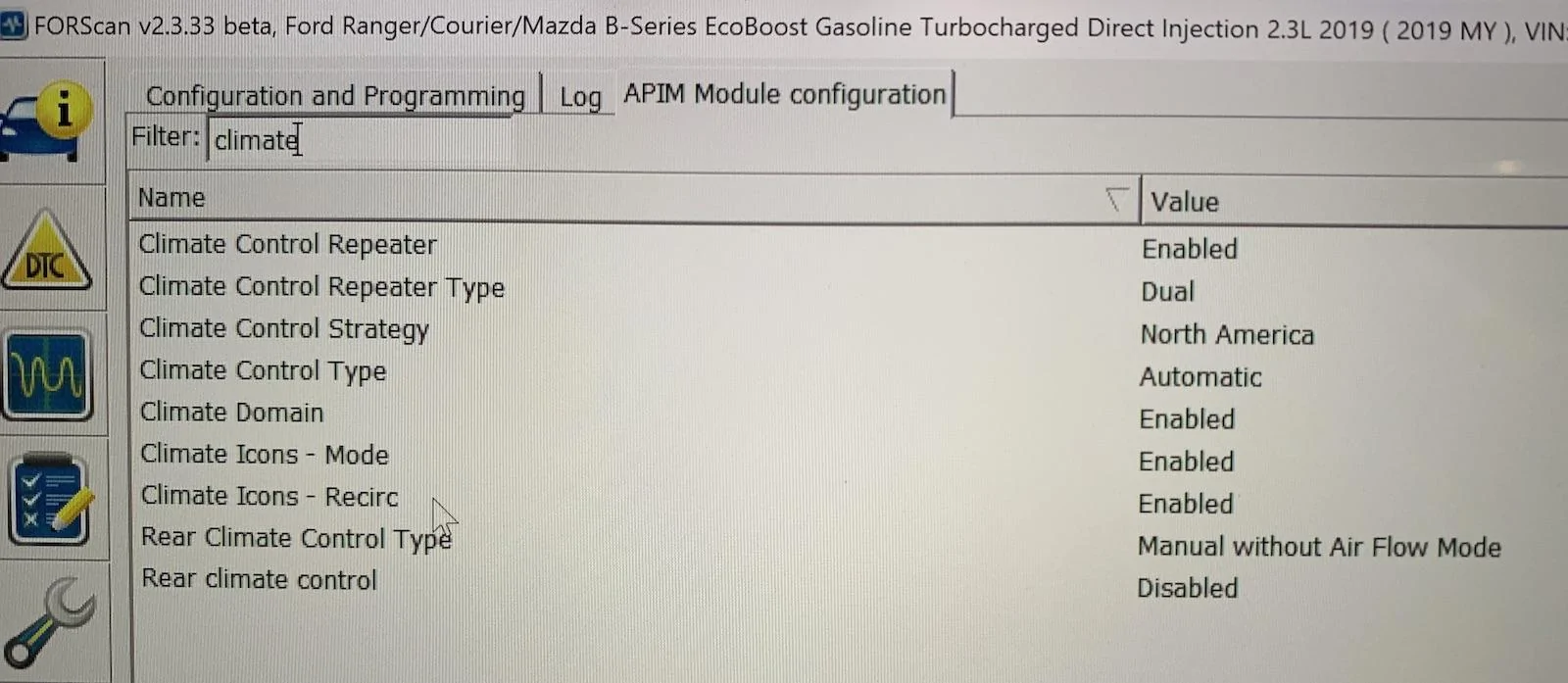

I then decided to use the Forscan to enable the Climate Domain, which I did. However, I still don't have the climate controls screen. It shows that the Climate Domain is engaged now but am I missing a step?
Here is a screen shot of what FORScan shows for my Lariat. Are your climate icons enabled?

I did the update a few weeks ago and lost the climate controls screen. I decided to let a Ford dealer fix it but that was a mistake. They kept it about 1/2 day and when I picked it up the service advisor told me this story.... The tech and the service manager told him that the update did away with the climate controls screen for safety reasons but at the same time enhanced the voice commands. I told the service advisor that was strange as I am on a forum (this one) and somewhere between 1/3 and 1/2 of those that did the update did not lose the screen.

Geoff after you Enabled these 3 settings in the APIM, did you have to perform a module reset using FORScan or a Master Reset?
Geoff
Oct 17, 2018
705
498
NYS
'19 Ranger 1943 Willys Jeep
Retired Engineer
I did not lose climate when loading 3.4 so I can't help you but I highly doubt you need to do any FORScan reset (I've not read where anyone needed to do that).
