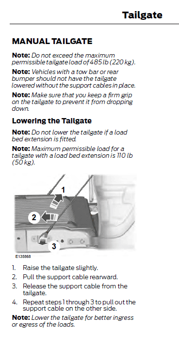

Nice idea.
Problem that I see is the added 30lbs system weight + another 30lbs in gear versus the tailgate load rating. If it breaks under you and you break your leg, then the repair + sick leave is out from your pocket not from any insurance.
The carpet is also a condensed water magnet and could cause molding of the gear there in.
Definitely something which Ford could take up as an extra. They could reinforce the tailgate for higher load, add dampeners and make the box lockable. Sounds about right place for emergency gear, jacks, straps, signal flags and all.

I want to say it is made out of steel. What grade I'm not too sure. How much weight can it hold? Enough but again you dont want to put to much for two reasons. 1 it is a tailgate so you dont want to necessarily work out all the time. 2 the tailgate is only rated to hold up to 200 lbs if I remember correctly and the storage compartment weighs between 25 to 40 lbs(I didnt put it on a scale).
Tailgate is rated for 485lbs.

Well thankfully you would not have to worry as one other member just posted strait from the manual that tue tailgate can take up to 485 lbs of load. That there say tuese tailgates will do just fine and wont break that easily unless you do something really stupid
