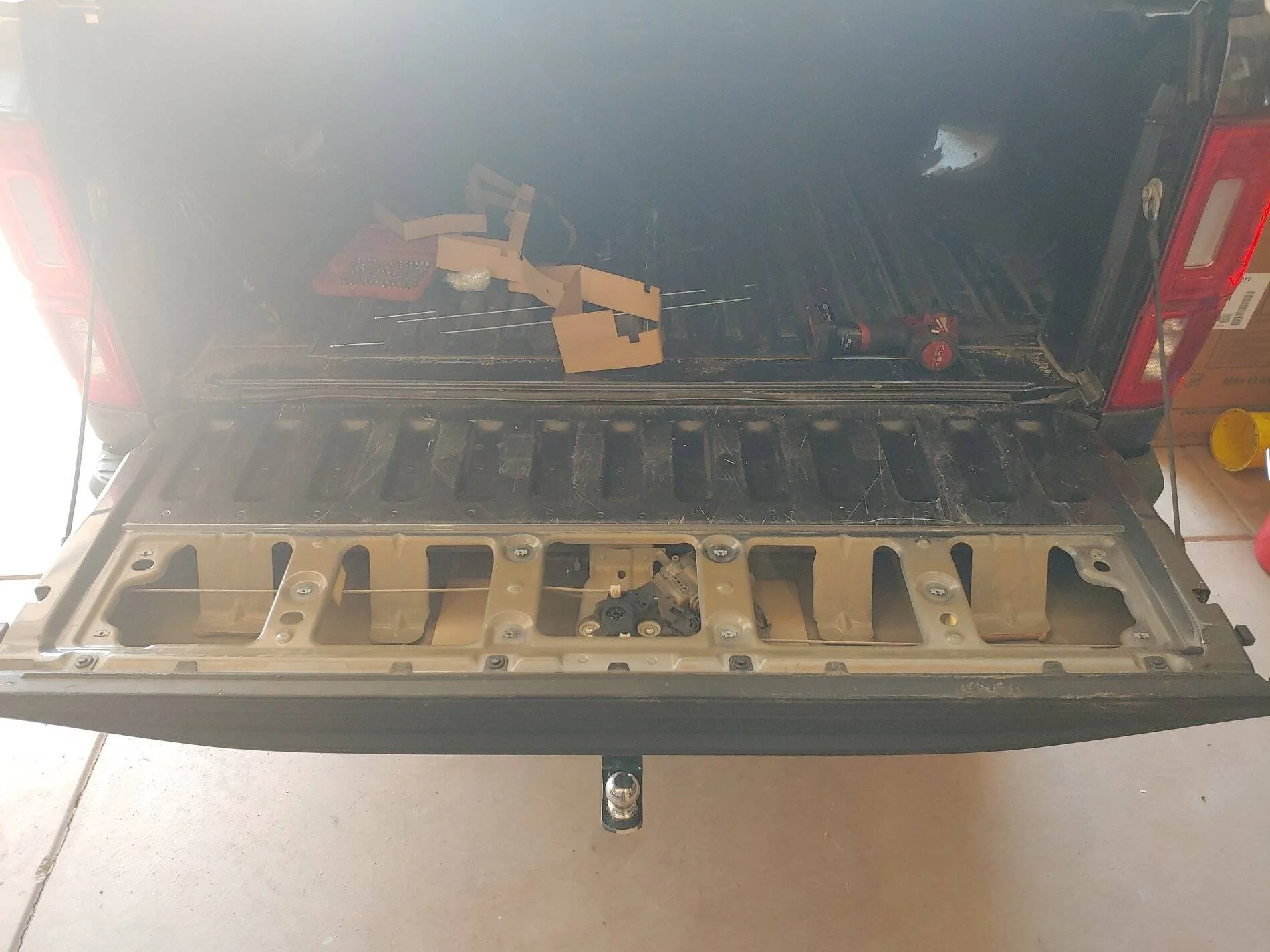

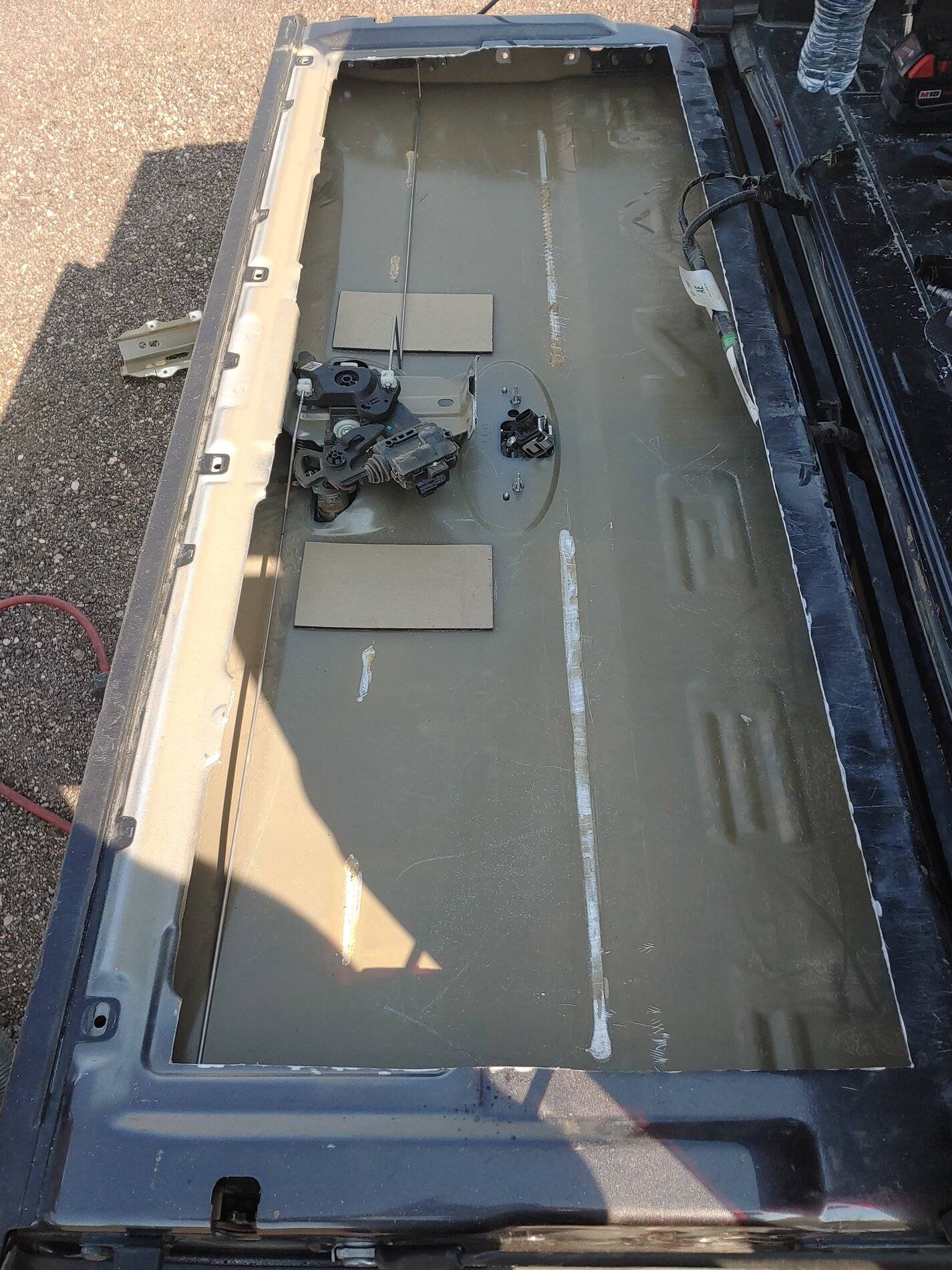

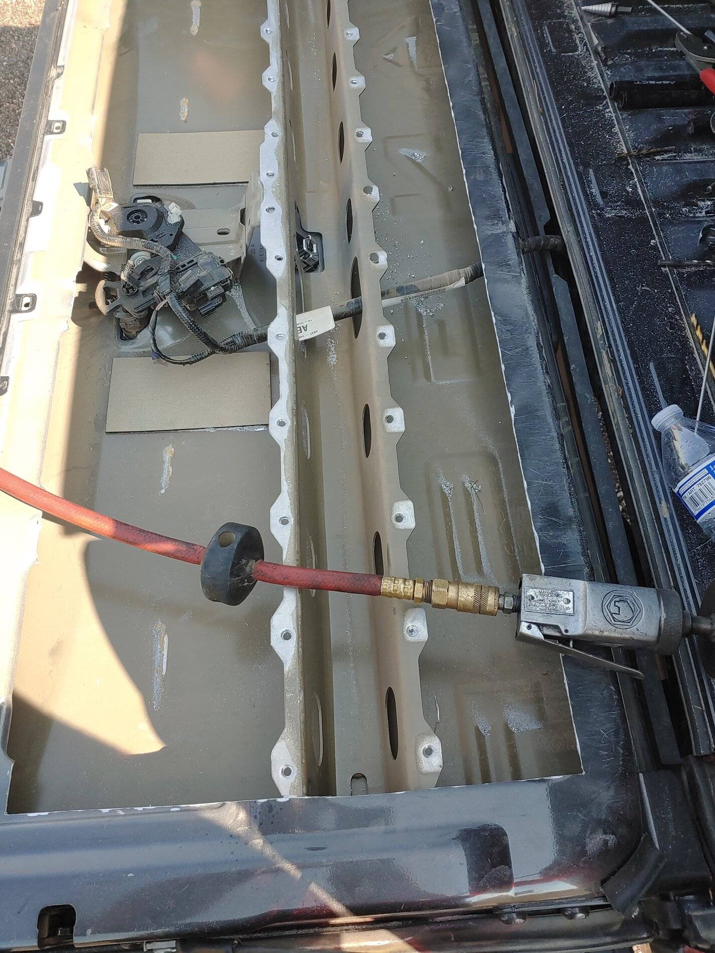

Well as the title says you may or may not be jealous. A while back someone on here brought up the idea of the Huracan Fabrication tailgate storage. Unfortunately at the time there were none for the Ranger in the US.
Well there is now!! I was lucky enough to get the first one for test fit and I can say that it looks nice!! Yeah it took between 4-5 hours to install but I feel it is worth it!!
Also with the added weight it may encourage some to get the tailgate damper!!

I could see this being useful. What is the door panel made of & how much weight can it support?
I want to say it is made out of steel. What grade I'm not too sure. How much weight can it hold? Enough but again you dont want to put to much for two reasons. 1 it is a tailgate so you dont want to necessarily work out all the time. 2 the tailgate is only rated to hold up to 200 lbs if I remember correctly and the storage compartment weighs between 25 to 40 lbs(I didnt put it on a scale).

Excerpt from online description:
Fully lockable, it comes with gas struts to keep the lid steady when open and a carpeted interior. Once installed, this tailgate is easily as strong as the factory tailgate.
This mod requires access to an angle grinder, metal file, drill, basic hand tools and a little DIY knowledge. Some of the original tailgate must be removed in order to fit this storage compartment.
So, is this a replacement tailgate (as implied in first paragraph), or a modification of the factory unit?
A modification to the original. You have to cut the back(inside wall) of the tailgate and you have to remove some of the support structure but be aware that the tailgate strength is thrill there.
