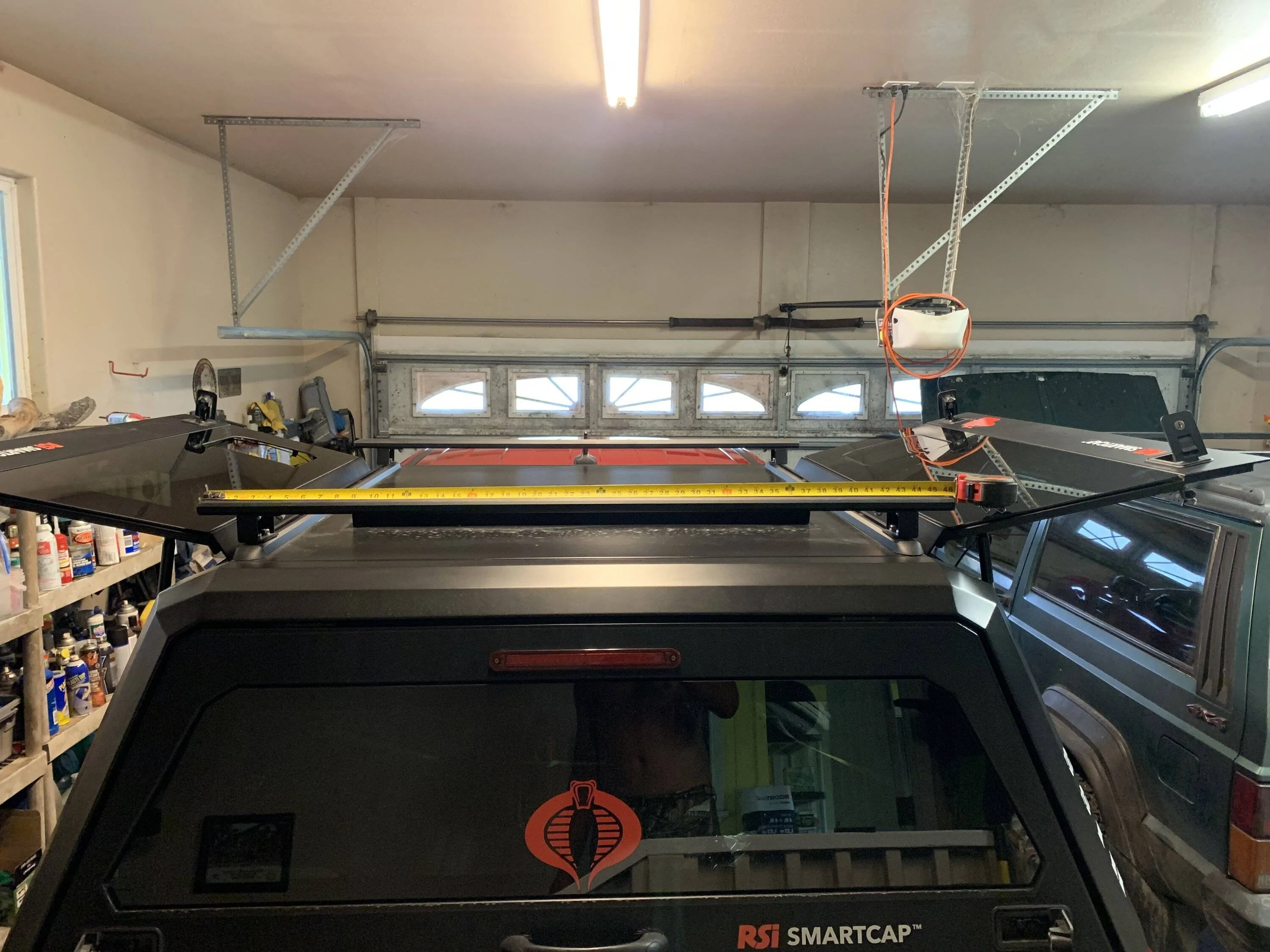

My RSI load bars are 45.5” and it has the gullwings- anything a few inches wider would likely interfere with opening them. The roof tapers a lot on the ranger (I wish it didn’t have so much taper for many reasons). I’m not sure what your shell will be like, but it will probably be similar.

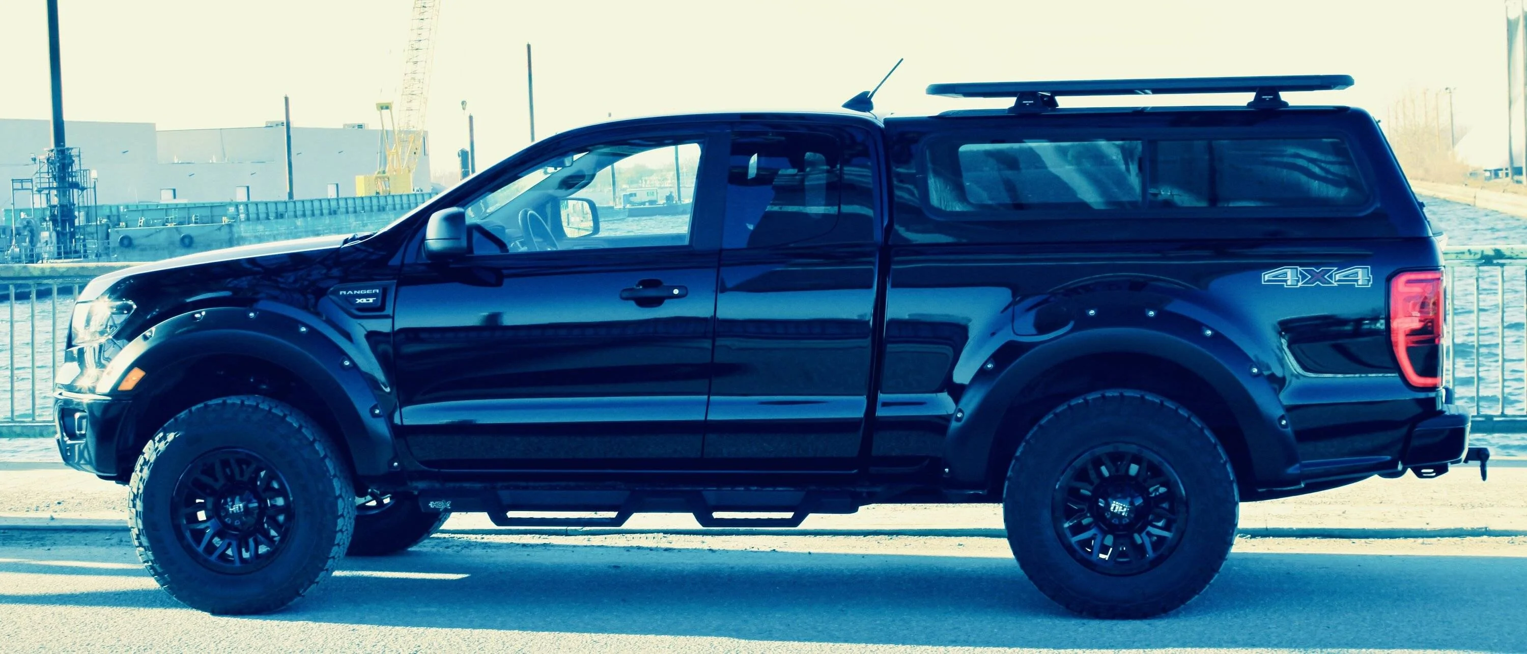

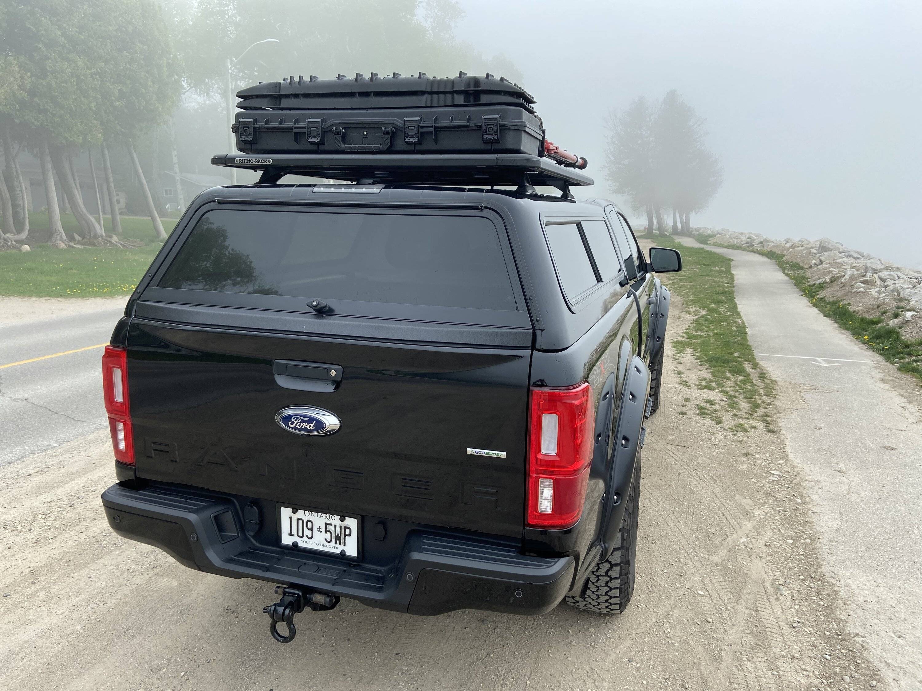

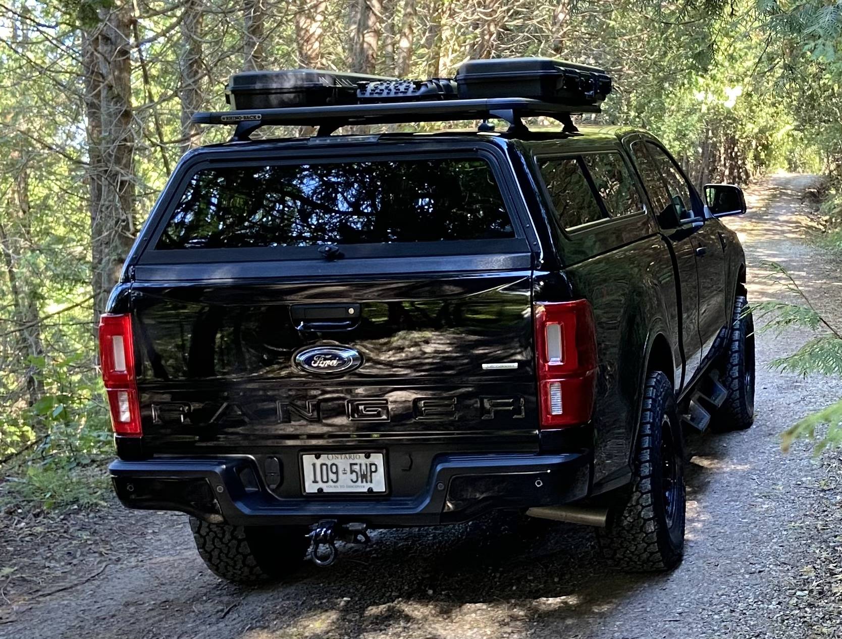

My Rhino Rack Pioneer Platform is 49” wide - about the same as my ARE topper. I do not have tracks - bolted straight to topper. You do not need crossbars as the platform has crossbars built in, which gives you a lower profile.
If you need the extra width, they have plenty of different sizes.
