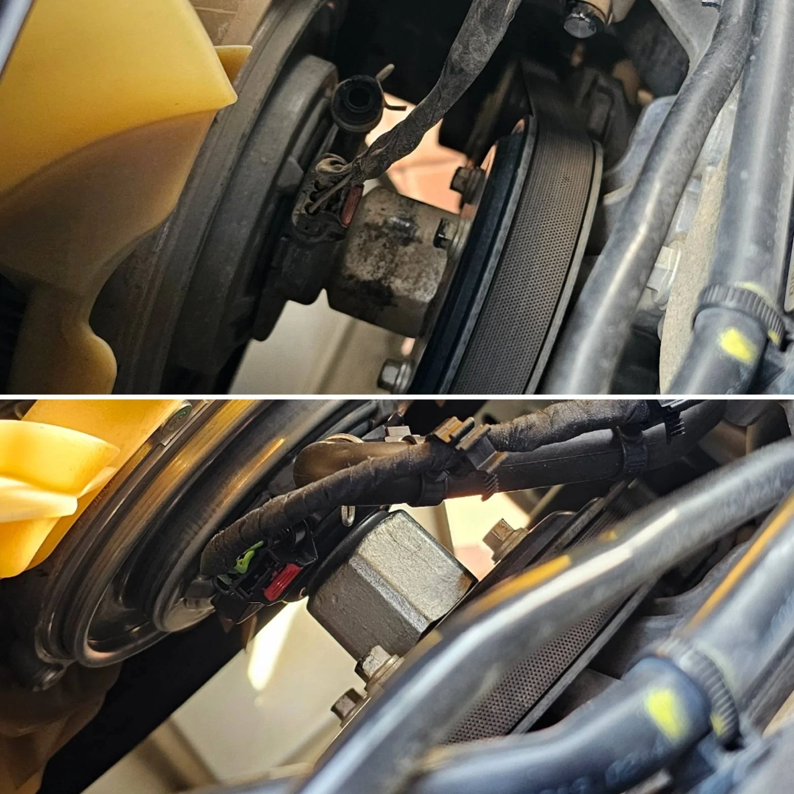

UPDATE:
Got the truck back today from the dealership. The final bill was $334 - that covered the deductible ($100) and a new battery (my request). It looks like they replaced the fan clutch, the fan clutch sensor, and the wiring harness.
Before & After:

Looks like a clean job John.
No more codes being thrown?
Was that your original battery?
Yeah, it looks pretty good. No more codes!
And the battery is original - 2019.
