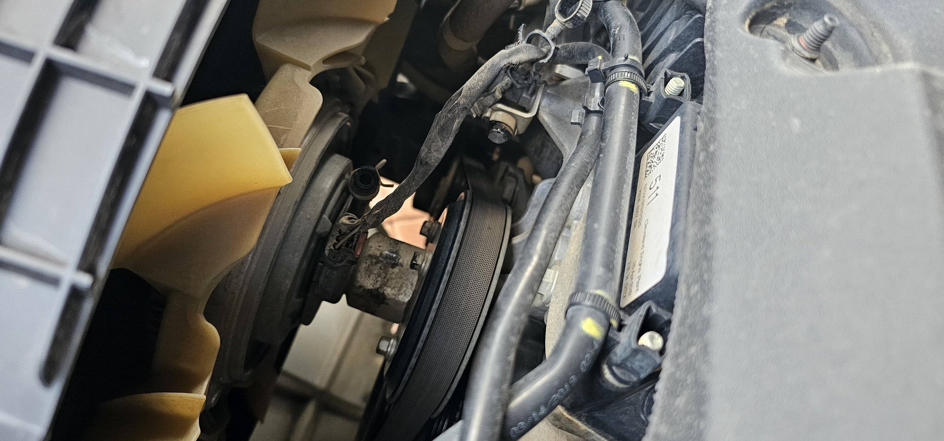

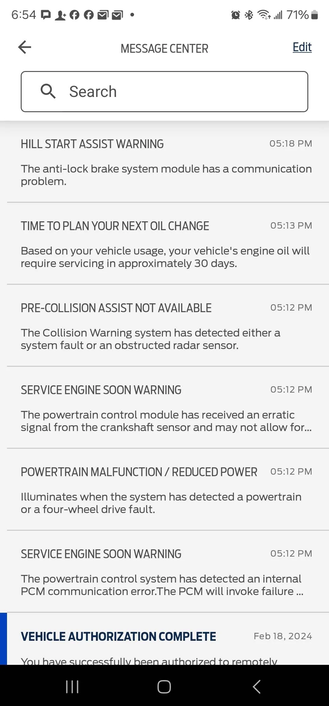

I was driving home from work and the truck started bucking badly and wouldn't accelerate bast 26 MPH. Things kept getting worse and worse as I was trying to limp the truck just a little bit further to the house. I was getting errors on the dash for:
  • Terrain Management System Fault
  • Pre-Collision Assist Not Available
  • Service Advanced-Trac
  • See Manual
  • "Engine Light"
  • "Wrench Light"
  • "Traction Control Light"
As I made it into my neighborhood, the truck stopped accelerating past 6mph. When I made it to my driveway, I popped the hood and found the rubber hose that holds the sensor connected to the fan was crumbled and the harness was laying on the fan shaft. I zip-tied the harness up out of the way and restarted the truck, and everything is running fine now.
Did you guys have the same symptoms that I did when this happened to you?

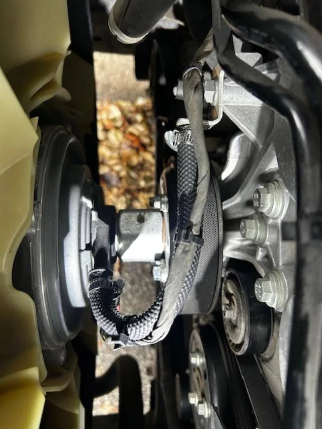

Yes, those are the symptoms of the damaged wire harness, hopefully it just put tension on the connector and triggered all the faults.
I would give the harness a detailed inspection for damage and then install a short piece of 3/8 HP Fuel Line and install new clamps on both ends then resecure the harness to the hose.
I would also very carefully with the engine running give the harness a shake test, to ensure it does not throw it into a fault mode. (Limp Mode) as it may have damaged the harness by broken strands.
And since we do not know if the reason for this the deteriorated hose itself or the Fan Clutch is trying to spin the module (electric part).
I would monitor with the engine running to see if it wants to spin with the fan clutch.
Thus far, it appears to be just the hose breaks down and the harness falls into the path of the fan or gets caught on the hub (attaching nut) and rips the harness apart.
Good find and hopefully you got lucky and zero harness damage.

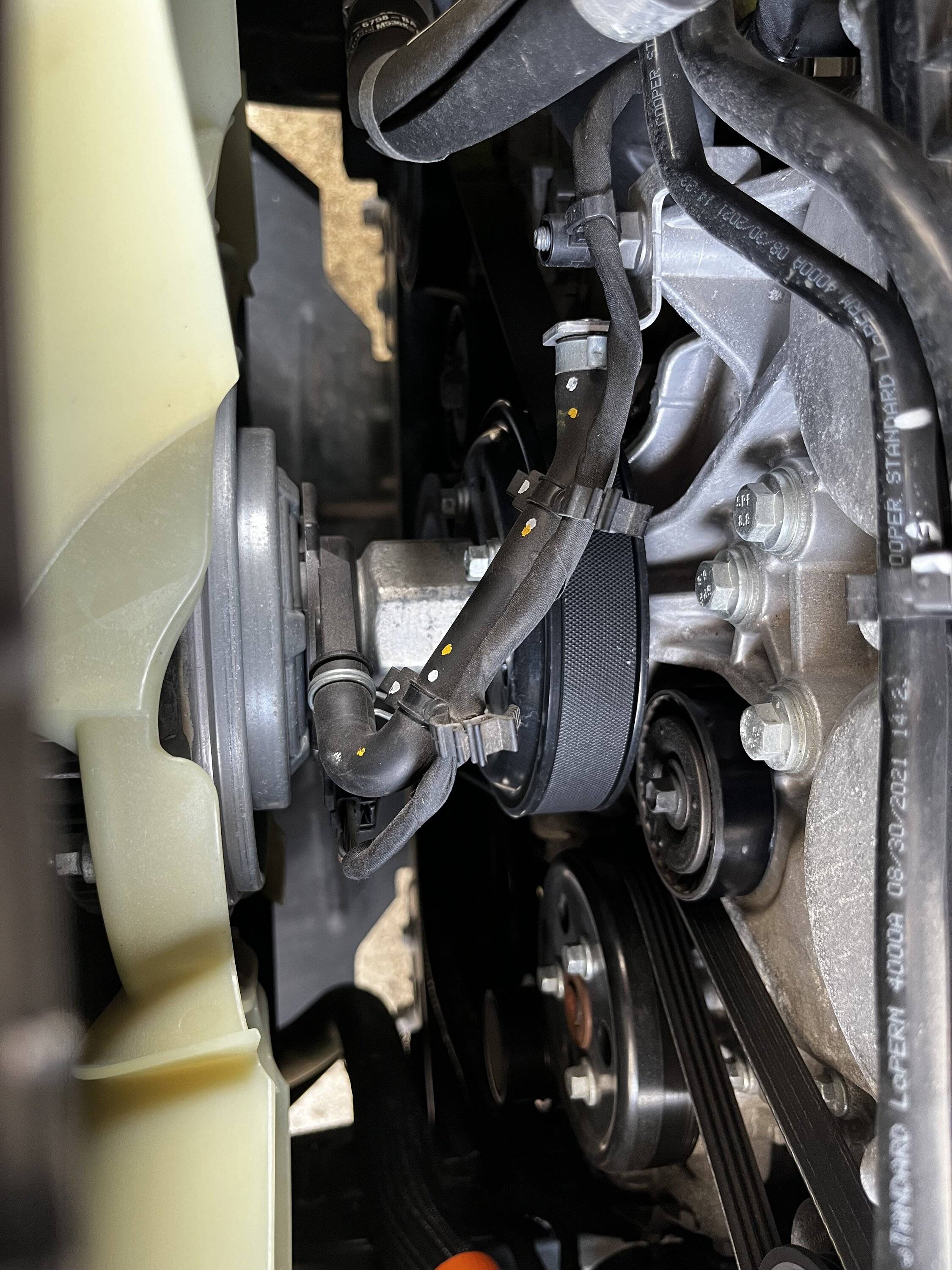

NOTE: Your Module has spun out of the OE Position, as noted below
OE Position:
Added Hose (Repaired Position)
The only reason I have not moved to replace that hose so far is that I am afraid the fuel line hose will put undue stress on the fan sensor bearing. Am I paranoid ? Thoughts?
airline tech
Aug 24, 2022
1,678
3,562
Midwest - KS
Aircraft Tech
The pic I posted on a repaired hose was my daughters boyfriends Ranger, I just happened to look at it while doing some other stuff to the truck.
Hose was broken, wire harness intact.
I compared mine to his and no noted difference in play or rotational tightness the module.
From what I can tell, there is no bearing that the module rides on, it just free floats on the shaft.
I would love to see one taken apart to see exactly what its riding on.

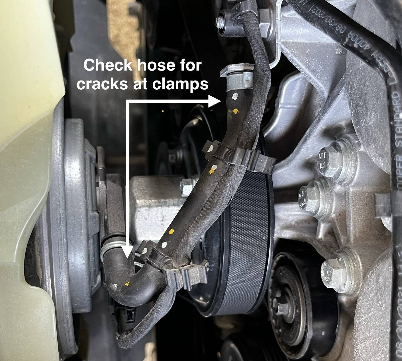

So what part is the common failure point? Is this something one can preemptively replace to prevent this failure or is it a luck of the draw? I plan on replacing that egr valve sensor soon to prevent that issue from raising its head as I have 84k miles on the truck now
48
6,502
30,319
Toronto, Ontario
2019 XLT SuperCab
Husband-Caregiver
From a couple of other posts, the hose seems to crack just before the clamp. Almost as if the hose had become hard and brittle and failed.
@airline tech ’s hp fuel line fix looks simple and sound - it should be easy to source the parts and do it in your driveway.
@Ranger_Rocks posted links to a number of threads on this issue…
https://www.ranger5g.com/forum/threads/fan-clutch-sensor.23456/
https://www.ranger5g.com/forum/thre...ence-a-fan-clutch-going-bad.25821/post-592062
https://www.ranger5g.com/forum/threads/tube-on-fan-clutch-sensor-wire-problem.20549/
https://www.ranger5g.com/forum/thre...e-tube-sensor-thing-going-to-clutch-fa.26246/
This pic is courtesy of @mtbcal…
