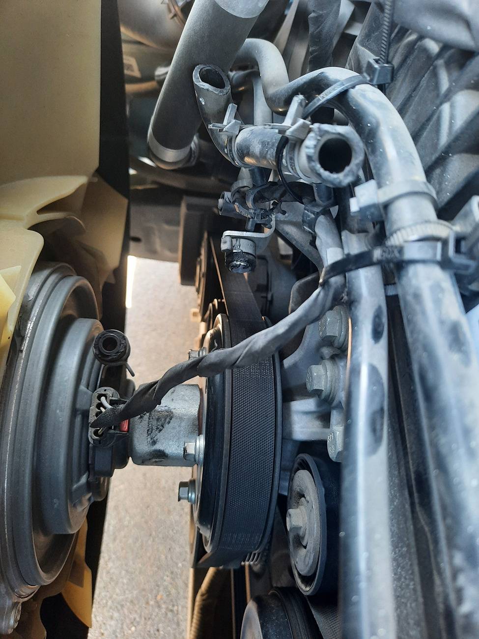

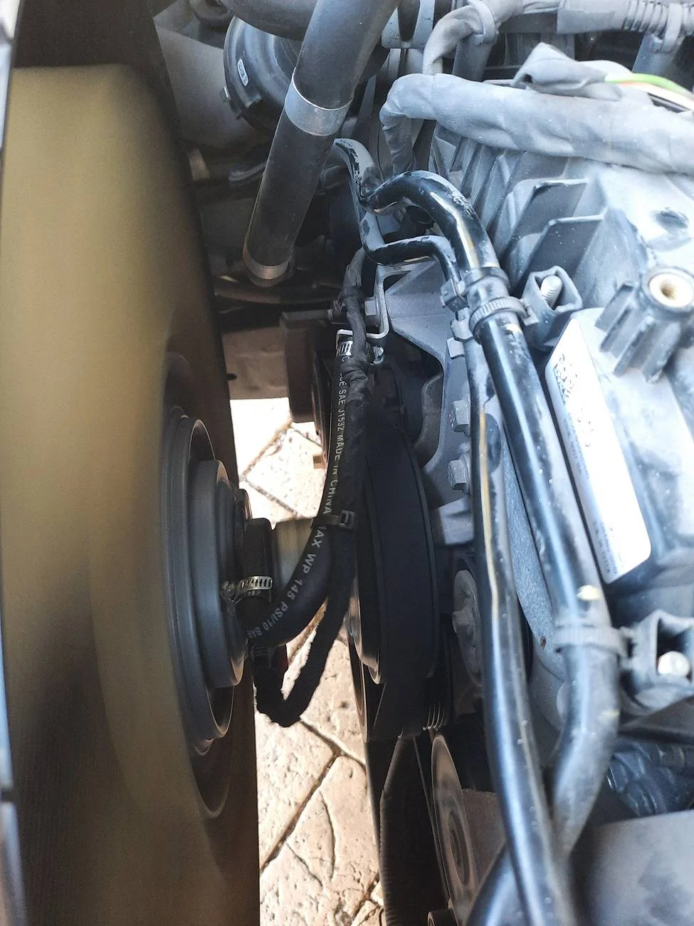

I just the same fix as Ramong. I just happened to be emptying the Ford Performance catch can when I noticed the hose was in 2 pieces. I just put some regular old 3/8" fuel hose in it's place with the same clamp on the fan end and a new worm drive clamp on the anchor. I'm feeling tremendously lucky right now.

Working on my Ranger today and as I'm standing on a milk crate stretched out over the engine, arms twisted up in positions they weren't designed for. .... A broken hose catches my eye. The one on the fan 😮. The tip of it broke off the metal nub. I cut the end off, put it back on and zip tied it. The crimp on the other end is loose. It zhould hold till I drive to the parts store to get 3/8 fuel line.
