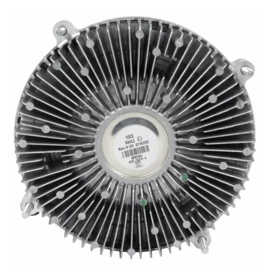

FWIW. The fan clutch is built by Mahle for Ford. Mahle supply’s fan clutch’s for many major OEM’s. Some of which also use the rubber hose. It appears to be OEM only and not purchasable from Mahle aftermarket suppliers.

I would love to get my hands on a failed one, and take it apart, I am looking for wear or galling on the race the module rides on or front bearing wear allowing the fan to rock backwards.

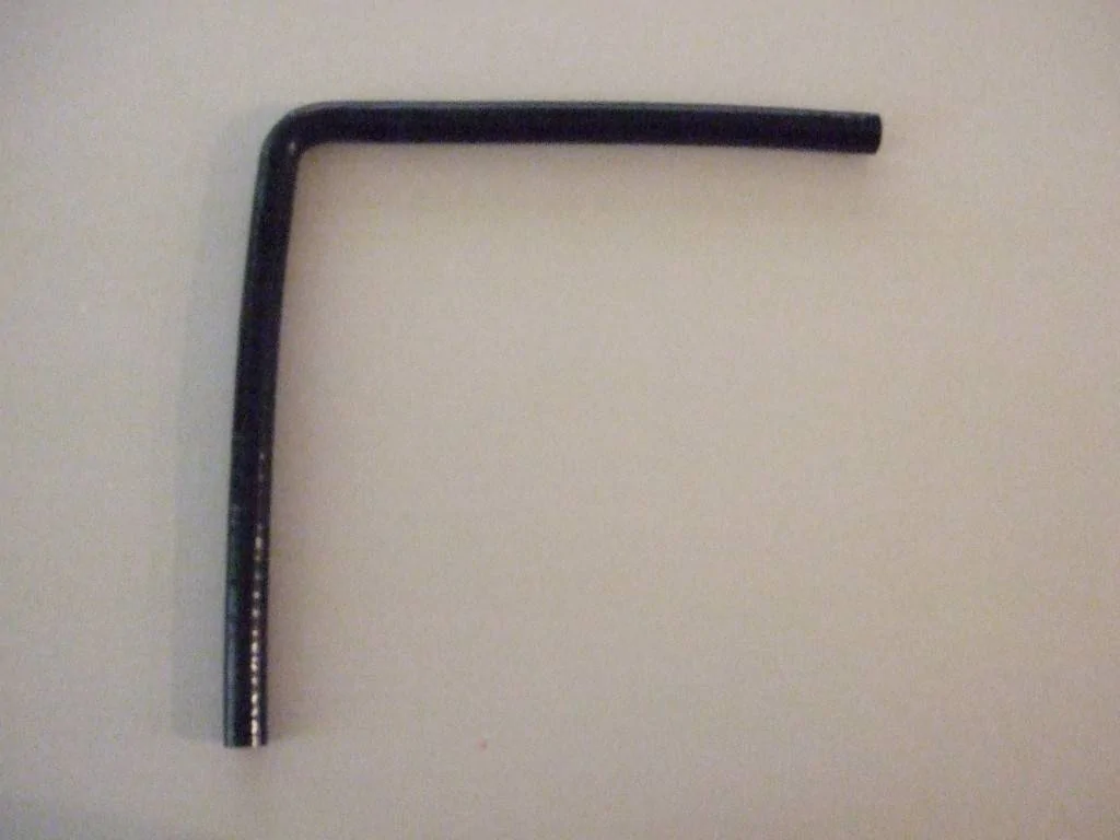

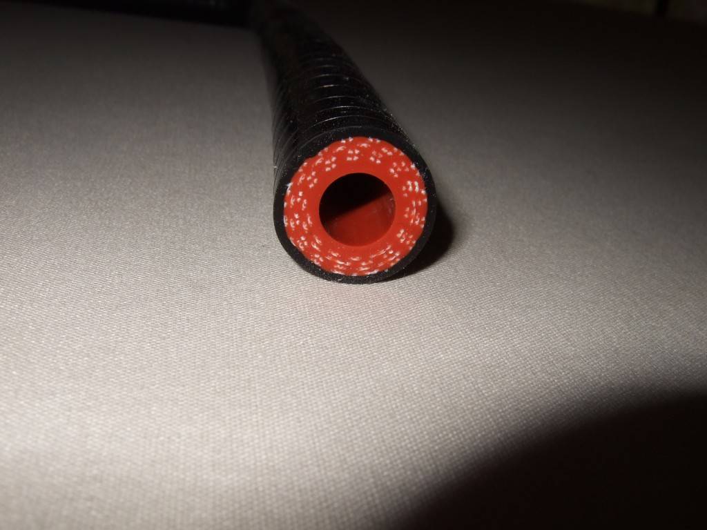

This just arrived in the mail. It will be a few days before I can test fit as I am recovering from appendicitis. Boy!! Came on suddenly and very painful! But I am over the hump. Antibiotics are wonderful things.
Here's a couple of pictures of the hose, Plenty long to cut to fit. I have not had the original off to see if they have similar flexibility. But a cursory look seems promising.
An update coming when it is test fitted. This one won't dry rot.
