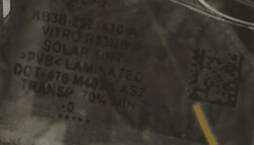

and is for the proper deployment of side airbags.
*edit - if you read the little label in the corner of the window, it will tell you if its tempered or laminated
I looked at it it's laminated

the tempered glass just shatters, the laminated wont.

That is crazy !! The side and rear glass on cars and trucks is safety glass and "should" shatter into a gazillion pieces when broken. Obviously, this piece must be defective....it's a safety issue and they really need to fix it, IMHO.
A number of vehicles have used laminated safety glass in the front doors for a while now. This behaves similar to a windshield.
All vehicles made after 9/1/17 are required to have laminated side window glass per Federal Motor Vehicle Safety Standards.
