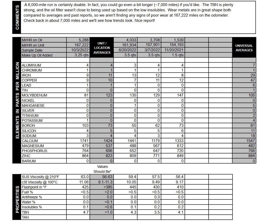

Still getting used to my new Ranger and the dealer told me the oil change interval is "up to 10,000 miles" for the 2.3L EcoBoost engine on Ford Synthetic Blend oil. My previous GMC 6.2L called for a 7,500 mile oil change interval and according to the Blackstone lab reports I've done on it, with the OLM at 20-25%, it shows there's plenty of TBN left in the oil (the first short change was due to driving a company vehicle, so I zeroed out the meter due to lack of use, not engine hours or mileage).
Since the 2.3L seems to rev higher and work "harder" than the 6.2L would a shorter (such as 7,500 mile) oil change interval on Motorcraft Synthetic Blend be ideal? Or should I just stick to the oil life monitor?
Thanks!
Thanks!
