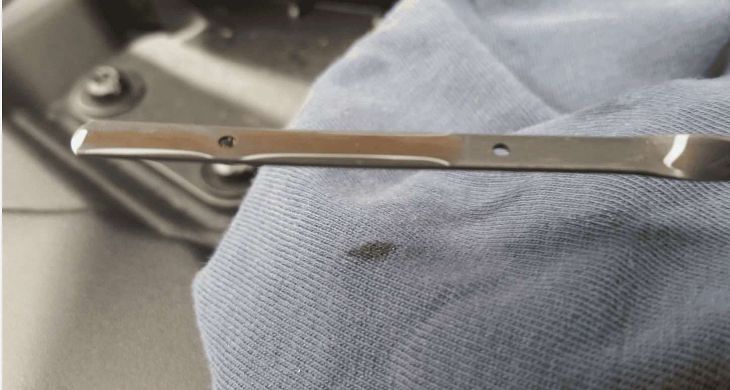

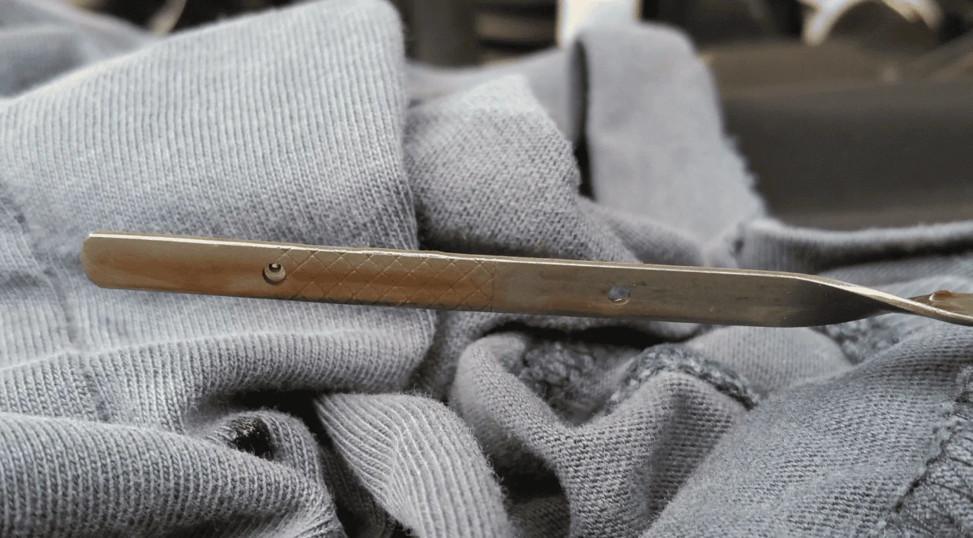

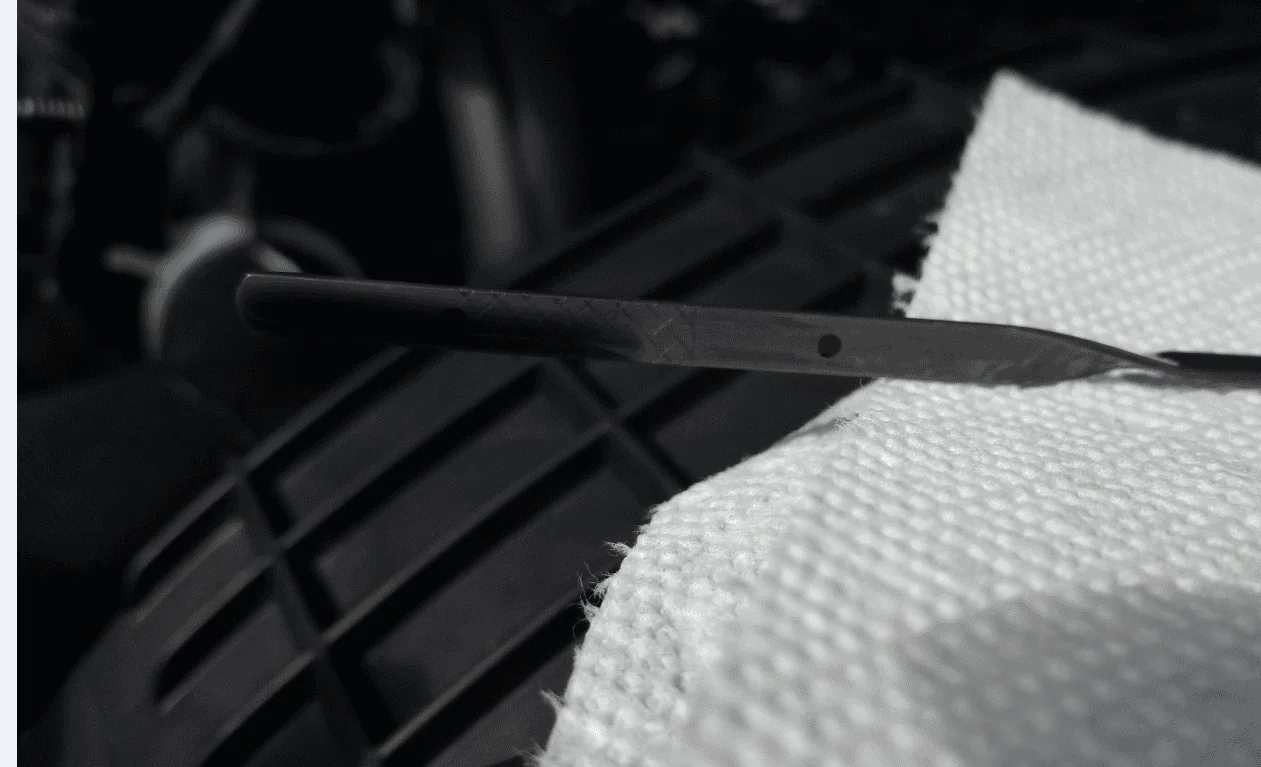

Here's some info of actual oil level increases. The initial fill was 5.9 liters.
With 320 ml added.
With 650ml added.
Each 5.5% increase raises the oil level 5.5mm approximately. The hash marks to the top hole would be about 11% increase.
To get accurate levels on the dipstick you need to wipe it off and install it about 4 inches from fully seated , wiggle it around and rewipe. Do this a few times. Get all the residual oil out of the tube. Then quickly dip and pull for a correct reading.
With the 2.5 inch level kit my engine takes exactly 6 liters to the top of the hash marks.
Liters not Quarts...big difference ..
With 320 ml added.
With 650ml added.
Thanks! I was wanting this information. My 6.2 quart fill was just over the hash marks. I was interested to know how much was needed to go to the top hole. So it looks like 350-400 ml from the top of the hash marks to the top hole.
