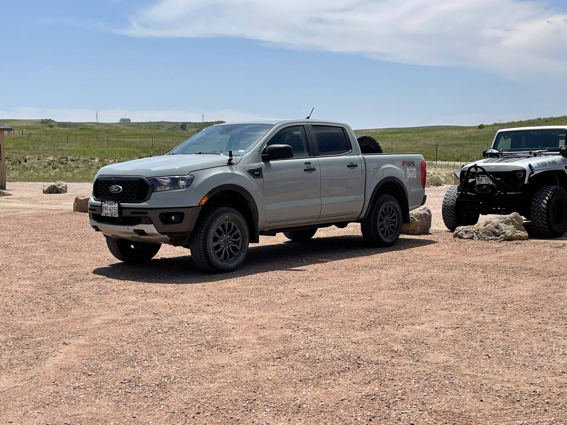

I went with 4WP in Wheat Ridge. Only took them 3 hours and I only waited a week for an appointment.
I’m digging the look so far! Next step is 33s!!
