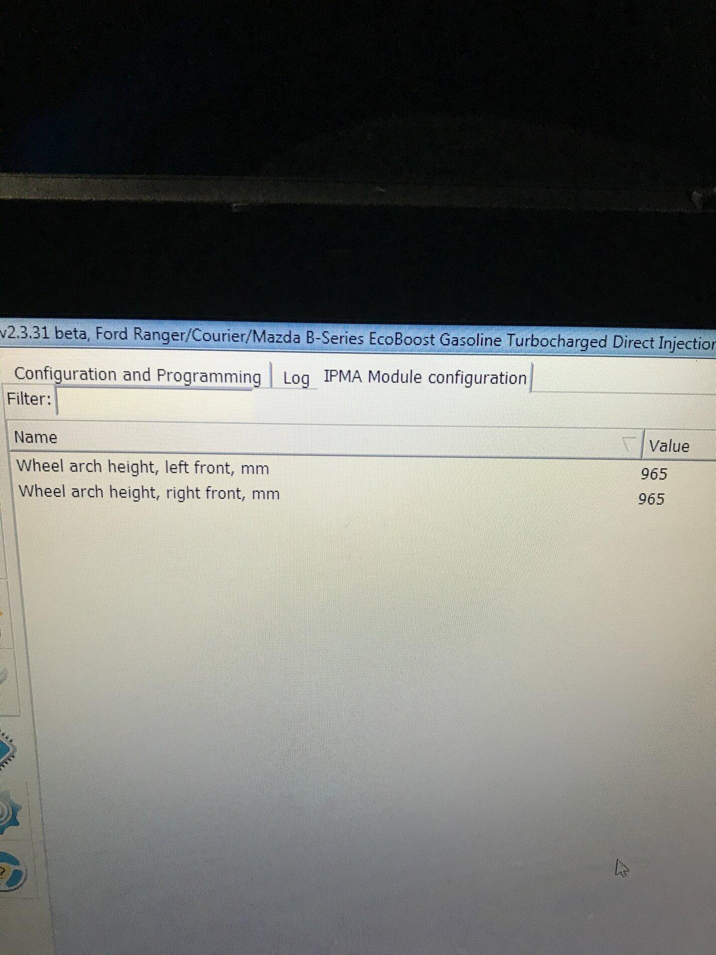

Ok. I have a 2019 XLT. I attempted to add the speed sign recognition today. I had no issue with the IPC portion of this and have the menu choices now available - however the speed alert warning choices are above and below 65 KMPH.... not MPH.....and I see the two little circles now on my dash cluster.
My issue though is that when I go into the IPMA MODULE I do not have ANY choices....it just lists the image below. I did try driving around to see if maybe it would work anyways - passed 6 speed signs and nothing. Any ideas?
When you start Forscan, pick the option to not open an existing profile and then reload the vehicle modules. That should help.
I’ll take another try tomorrow. Interestingly I believe I tried that in one of my many attempts this afternoon.
It’s weird that this is all that is displayed for IPMA.

Ok. It worked. Not sure what the issue was yesterday with the IPMA but I started over today and all is good. I now have the speed limit signs displayed as they should. I also do not display the U.S. signs but thats fine with me.
