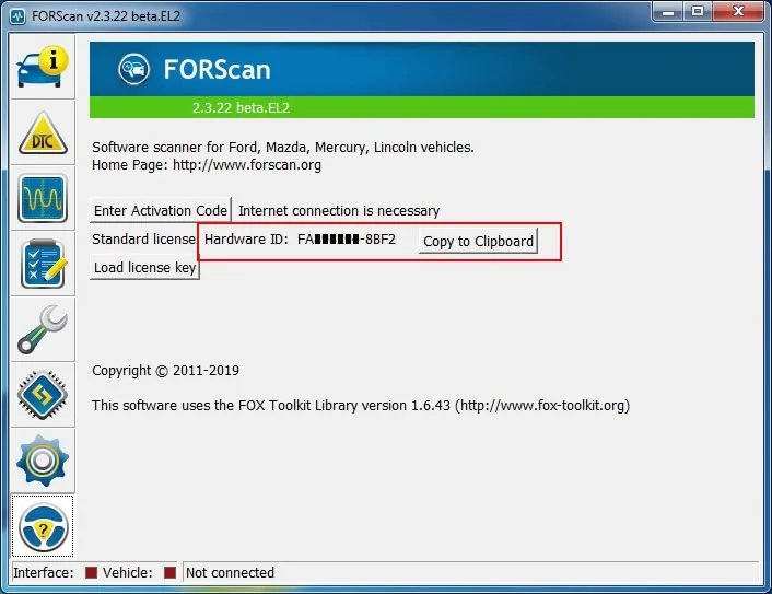

I've downloaded and installed FORscan and plan on using the free extended license.BUT:
When I get to the "Support Request" the last box on the form is "Hardware ID" with "Click here to find out how to get it" (See attached photo) which really doesn't explain "how to get it".
All that it shows is something that I've not been able to find.
Can anyone enlighten me as to how I can get this "Hardware ID"?

After clicking Copy to Clipboard, paste it into a word processor or Notepad. You can then view it. Also, after copying it to the clipboard, you can use CTRL-V to paste it into the online form.

when you run ForScan, click on the icon with the steering wheel with the question mark in the center, it's the bottom one. then you will get to the screen you're referring to.
