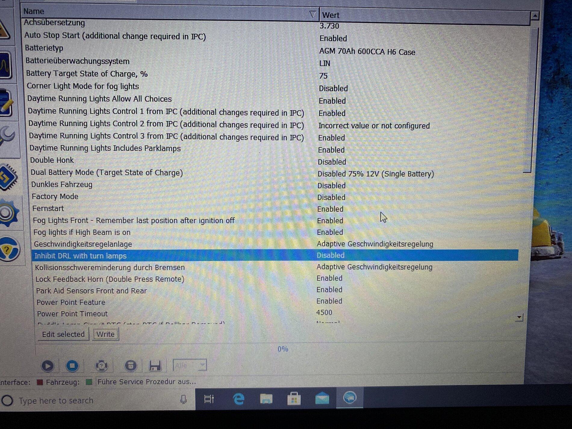

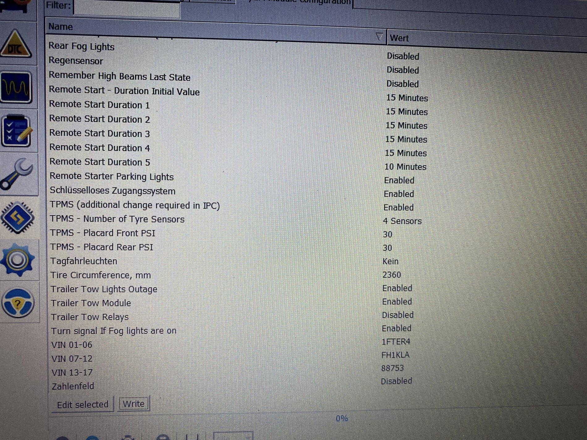

Hey, I need help. I replaced my front flashers with switchbacks. I did some modifications with Forscan and it seems it works fine. Neither hyperflash in the dashboard or front flashers, but only if the light switch not on off. If I switch the head lights off and operate the flasher or hazard lights, my front flashers are starting hyperflashing, dashboard is normal. I tried already many different settings, but I didn't get it. Here my settings in the body controller
