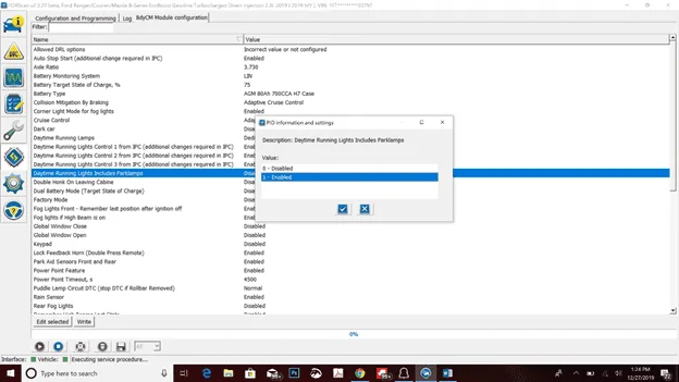

Anyone know how I can add the side marker lights to the day time running lights? I can’t find it.
gfitzge2
Gregg
Nov 7, 2018
1,235
7,011
Louisville, Kentucky
Retired Electrician
In the latest version of Forscan that is just a menu selection.
Gfitzge2
Daytime Running lights Includes Parklamps
In BdyCM module configuration
Or you can do it here.
Daytime running includes park lights
BCM - 726-41-02 xxx0 xxxx xxxx not confirmed
Gfitzge2
thank you so much!!!

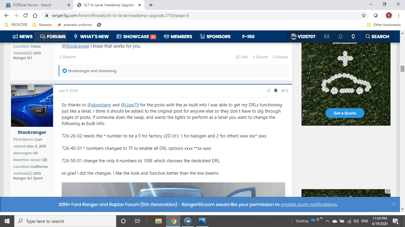

CHANGE XLT LIGHTS TO LARIAT LEDS
So thanks to @slowstang and @User79 for the posts with the as-built info I was able to get my DRLs functioning just like a lariat. I think it should be added to the original post for anyone else so they don’t have to dig through pages of posts. If someone does the swap, and wants the lights to perform as a lariat you want to change the following as built info.
726-26-02 needs the * number to be a 0 for factory LED (it’s 1 for halogen and 2 for other) xxxx xxx* xxxx
726-45-01 * numbers changed to 7F to enable all DRL options xxxx **xx xxxx
726-50-01 change the only 4 numbers to 108E which chooses the dedicated DRL
so glad I did the changes. I like the look and function better than the low beams.

Stockranger posted the Forscan codes to make DRL work when upgrading from XLT to Lariat headlights. This should be in here very helpful info
t4thfavor
Chance
Feb 5, 2019
2,607
2,357
you can add them to the first post on this thread, it’s a wiki and editable by anyone.
