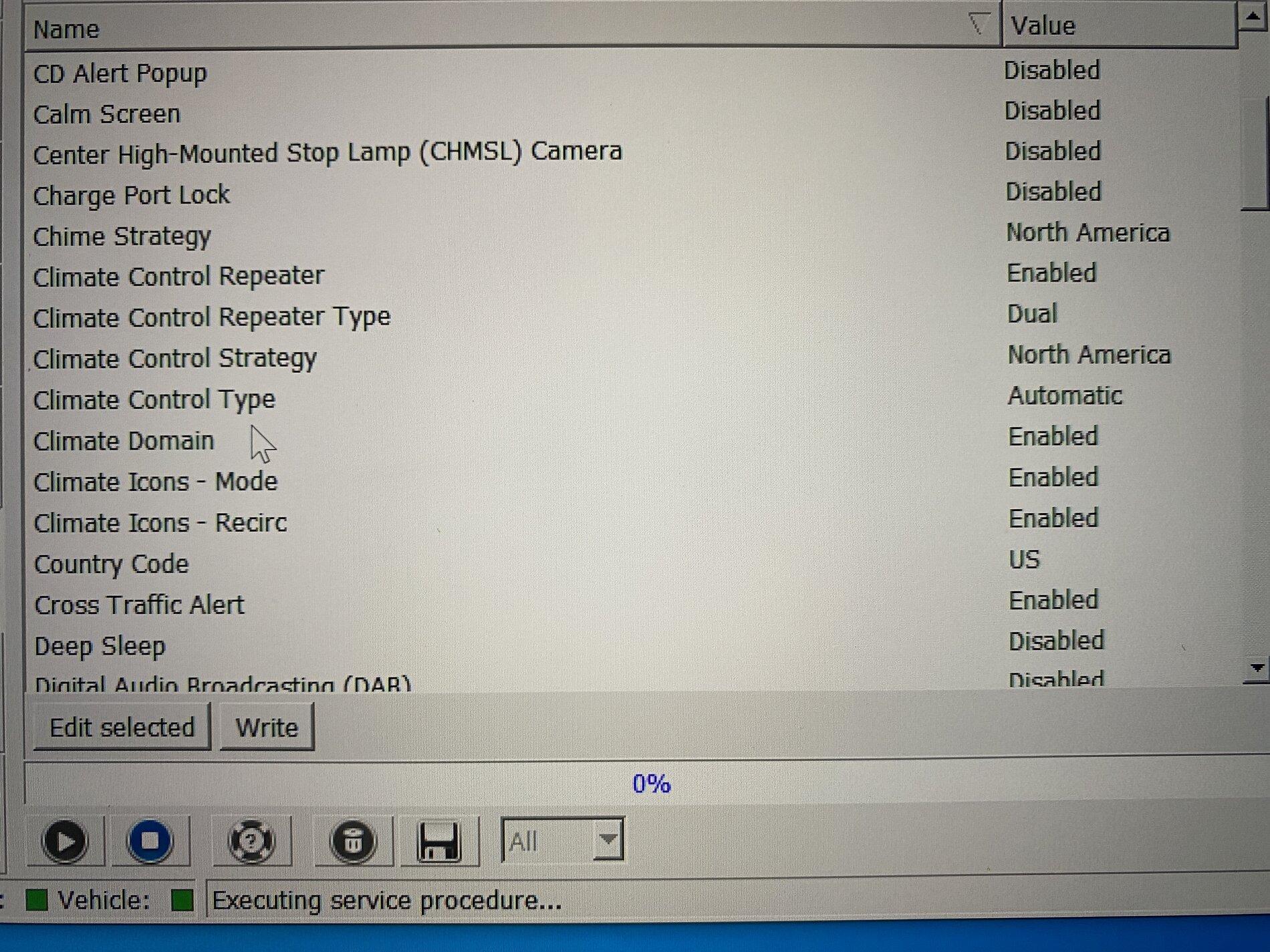

I have a '19 Lariat and need to get my climate back on screen. Can someone please post the correct changes?
Go into the APIM module (not the asbuilt) one. Your dropdowns should look like mine (the climate section only). Im pretty sure it was climate control repeater, and both climate icons.
Thank you! I get my cable today and will try
APIM 7D0-04-01 xxxx - xx0x - xxxx worked on my '19 Lariat when I lost it after updating to Sync 3.4. I believe there is also a configuration change in the APIM module rather than changing the As Built Hex Code.
