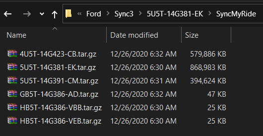

I have
0 2020-12-26 13:34 DONTINDX.MSA
25251 2020-12-26 13:34 SyncMyRide\HB5T-14G386-VEB.tar.gz
25266 2020-12-26 13:34 SyncMyRide\HB5T-14G386-VBB.tar.gz
889838273 2020-12-26 13:34 SyncMyRide\5U5T-14G381-EK.tar.gz
593802735 2020-12-26 13:35 SyncMyRide\4U5T-14G423-CB.tar.gz
47192 2020-12-26 13:36 SyncMyRide\GB5T-14G386-AD.tar.gz
540 2020-12-26 13:36 autoinstall.lst
XML already updated.

You're missing the 14G391-CM voice pack, unless you had installed it prior.
You win and have all the expected files for a Nav update.

What files should be included with a non-NAV install so I can check my download. I had 3.4 but Ford still said I had 3.3. My install went without issue and I submitted the XML file.
If it would have been in the first update for the ranger (sometime last year?) then maybe. My file from July for the 3.4 release that broke climate doesn't have a CM file either.
Basically, same as Ranger_Rocks only the C's would be B's, e.g. 14G391-BM. I’ll double check when our power comes back on...
Yep you needed it then. It’s new for this release so the only reason you shouldn’t get it is if you had installed and reported one of the prior MY21 builds.
