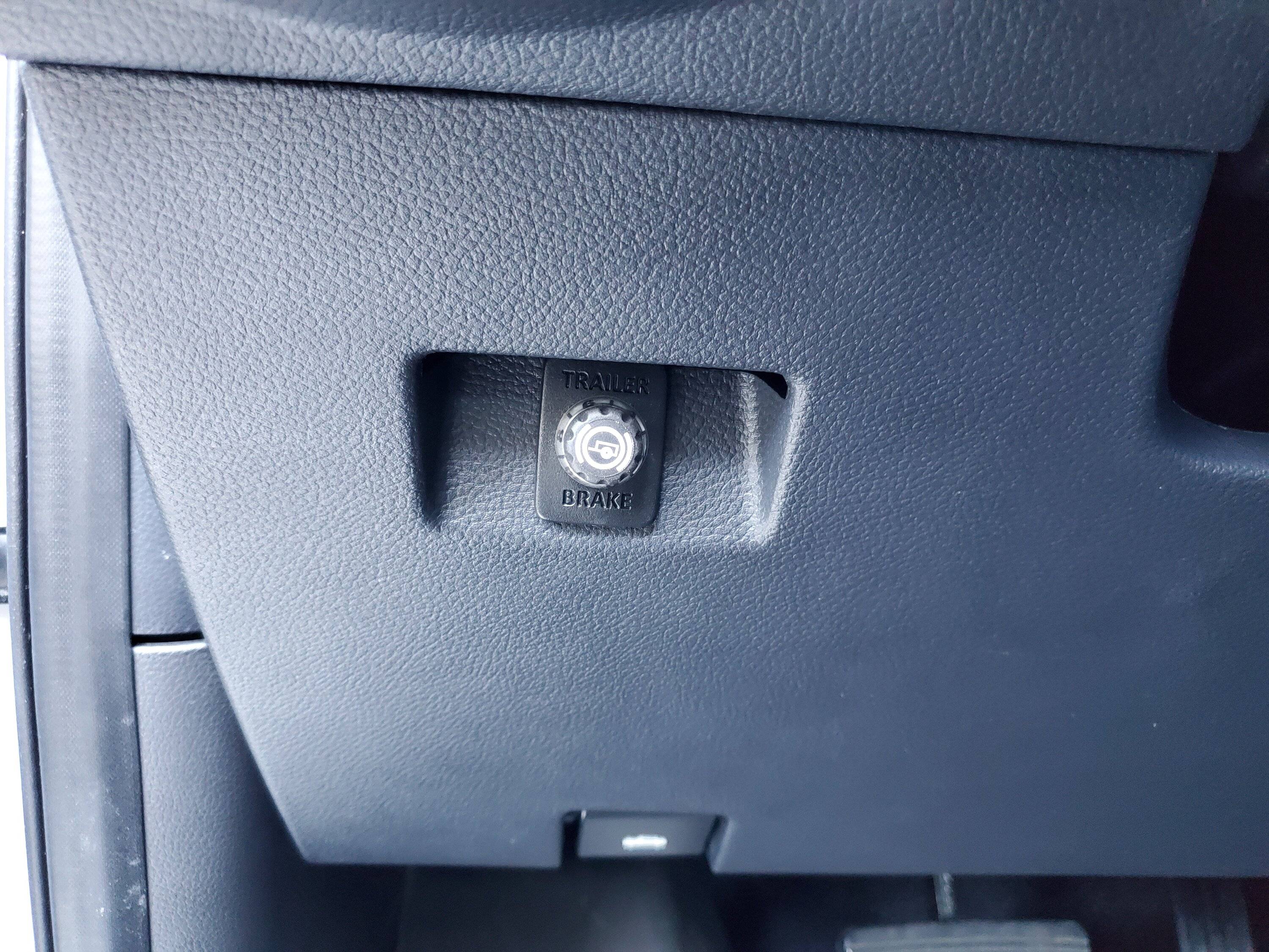

um given the factory install location for the control knob I am damn glad they didn't install it. I have mine in a nice sensible spot next to the 4wd selector knob I can glance down and look at settings/lights and I can drop my right hand and twist the knob ever so gently going down big hills.
ford factory location is to the fuse panel cover. right next to where my knee would hit it, I couldn't see it etc.
Indeed! That location makes it look factory and more technically advanced than the squeeze paddles. I cursed through the entire install, but after I was finished I looked it over and thought "Yeah, it was worth it!"

I have to say that I'm really impressed with the RedArc controller. I purchased mine from eTrailer, so it is not the actual Ford one. It works very well. My dial is mounted where the 12v accessory jack was, below the radio, closest to the driver. eTrailer sells the RedArc adapter that fits in the spot where the 12v accessory jack was. It is a perfect spot for the controller and it looks good.

Spent about 1.5 hrs Thursday installing the knob and control boxes. I put the knob on the fuse panel because it's out of the way and I won't be towing a trailer with brakes that often.
