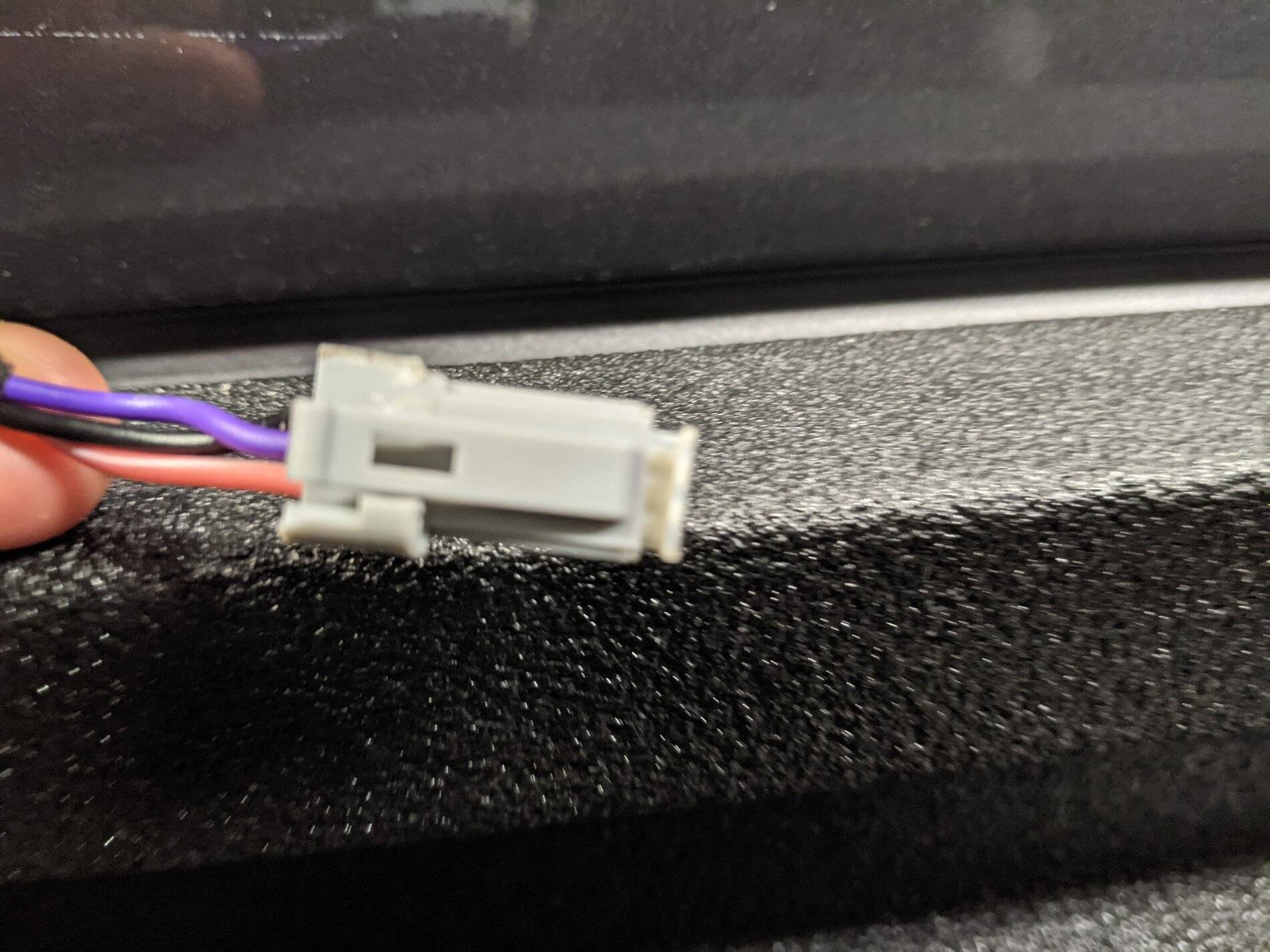

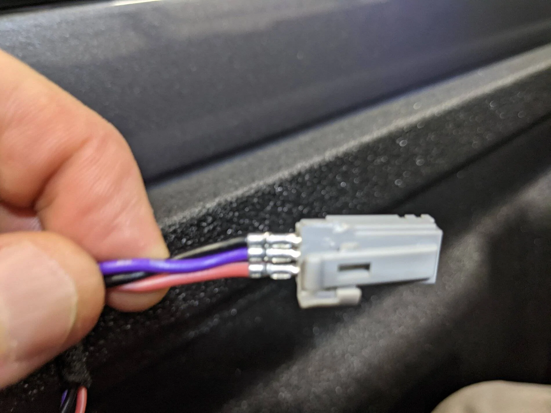

I cannot get the connector that interfaces with the high mounted brake to work. Seems like some of my wires will not go in far enough.
The brake light and bed light do not work with the connector in place. They work when I put the factory connector back (w/o the TBC interfacing connector).

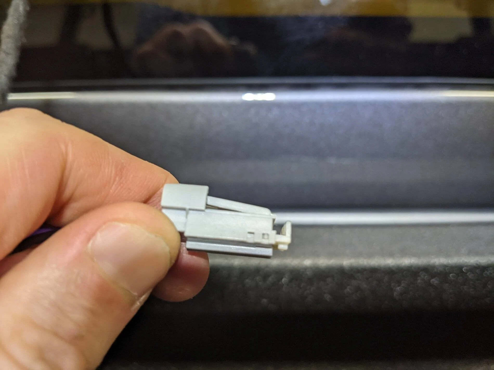

What is also odd is that the little white plastic piece on my gray connected was sticking out more than the factory one. I tried to push it, no help.
Here are some pictures.
Anyone have problems with this?

Update: I can pull the little white end cap back out (using a pick to push the tiny tabs down) and then the wires go in way further. But when this white end piece is out, the connector will not plug all the way into the other side.

Update, I did what the guy in the above did...used normal pliers and got the white cap in, while the wire were fully inserted. Now it works. This install is a PITA, makes me want to buy a Tacoma out of spite for Ford's lack of engineering for towing.

Yes, the same thing happened to me. I had to use a channel-lock pliars to gently push the connectors together. My fingers were not strong enough.
